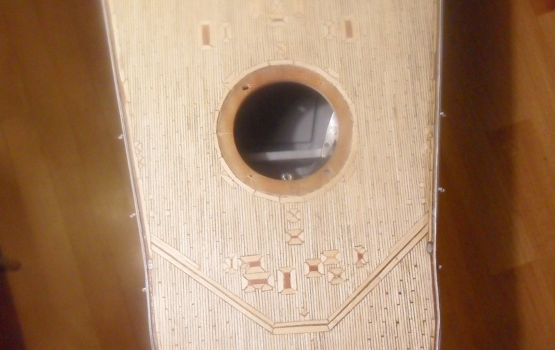

109 wrote:Some of the rivet detail is "wrong" if you allow some constructive comments. Don�t know if you can change things at this stage?
Hi, Bernd!
Some constructive comments are not allowed but strongly recommended!!
Of course, I have no detailed drawings about the hull's paneling. My riveting is just my investigation (see also my post from 22.01.2012 in your topic). But if you show me the mistakes, I will try to fix them!
With best regards -
Anatoly.
You are right, Fliger, it was a helljob with the upperdeck. I think, nobody in the world has the upperdeck of the kind (in scale 1/200). And when I look at the result, I feel good. A proudly good.
It is a bettest reward for the spended time. I wish all shipmodellers to feel so looking at their models-
at any stage of work!
Bernd, could you, please, draw the correct rewets lines on my pictures above? I am ready for correction of my hull -at last, it was the main aim of my topic here!
With best regards-
Anatoly

I posted the Schallanlage in my Bismarck build. Your version is incorrect. Bs and Tp had an other arrangement of the plates. Do you need any measurements?
