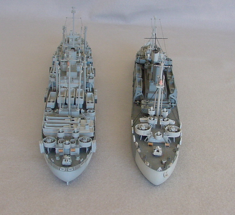

APA-58 USS Appling is finished. Pic 1 & 2 are the ship and the model. Pic 3 & 4 are comparison shots of the Appling with the Kenton, a Haskell class APA.

Hello Jim
:woo_hoo: how to tell you ...... I am in awe of your work !this is simply beautiful :thumbs_up_1:
I do everything to have a day in your level in the sctrach......but, the way is long :-D
bravo again

awesome work Jim.
Question, what is your preferred type of wood.
I have never used wood only styrene to produce my scratch builds but have always wanted to have a go.

Another pair of winners Jim! So what's next? :cool_2:
