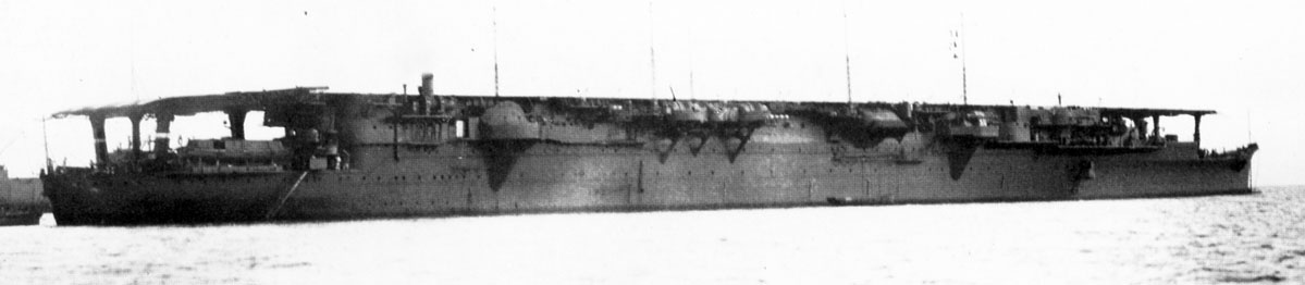

I'm reposting this photo of sister Zuiho at Truk from the previous page. You can see the demarcation between the end of the planking and the steel plating by the change in shading.
