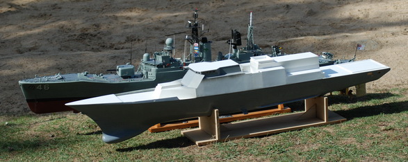

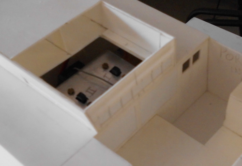

Anton here are the latest pictures of my Stergy (Not Sterey) I had to rebuild my superstructure 3 times before I got it right in my eye. Yes there are still problems but I can live with them. I'll try to work on the bridge of the Stergy. Still not sure if I have windows or holes where the windows will be. Running gear will be tweaked over the next few days and hope to get some paint and running shots early next year at the Navy Arvo at the Hubertus Model Boat Club. Come on Peter (ACT) gonna get yours wet also?
Shows the work on the Helo hatch.
Overall view
Overall view
Micks running gear for the Stergy Made by Xcell products Sydney
Mick's Stergy and behind you can see the Admiral Kuznetsov all at scale 1/72

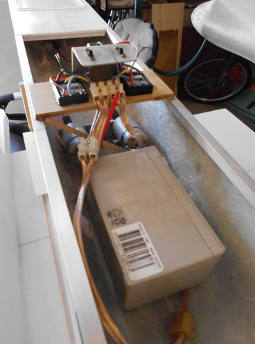

And now for an update with pictures.
Has anyone else started their build as yet if so add some pictures people.
Tomorrow rest day then finish stack, Start Bridge maybe bog up the hull finally and paint hull by next week. (Fingers crossed that is)
RC and Battery in place
Access to RC through the stack
