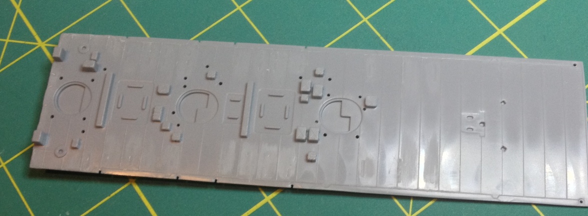

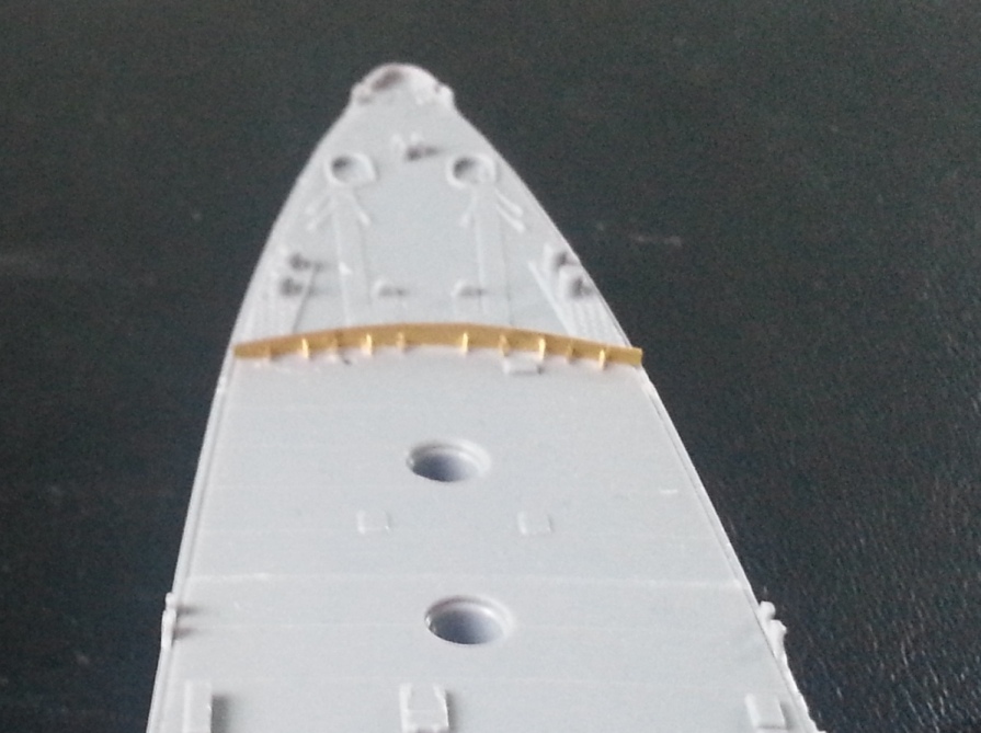

And we are back!
Now that I finished the airwing from he** I can get back to this kit. No new photos to update with. I am working on the main deck midship. There are several molded on details that I am trying very carefully to remove because they will be replaced with PE. Namely the type 96 splinter shields and the boat stands. The splinter shields as molded would likely have been two feet thick when adjusting the scale. I bet the AA guys wished the armor was that thick.
This is tedious but worth it.
More to come with photos soon.

32 hours into the build
Seven hours of work does not look like a whole lot with these pics. Lets just say it was tedious to try and remove molded on deck detail without messing up what I wanted to keep there....

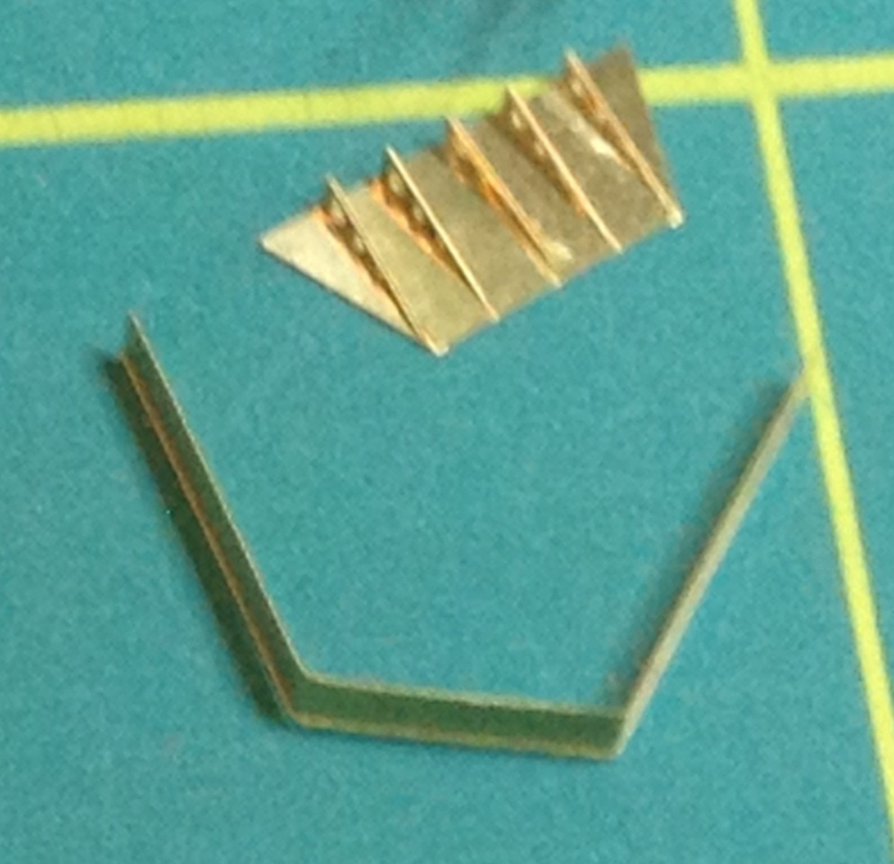

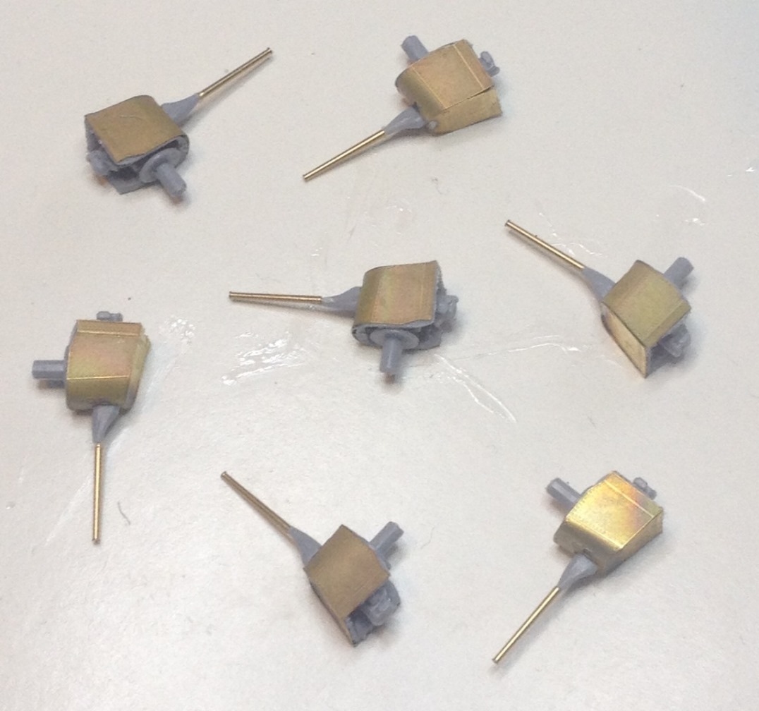

35 Hours in

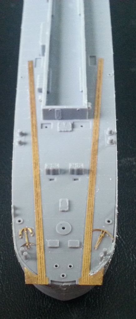

Working on the main batteries. All the barrels have been replaced. I am working on the photo etch wrap arounds for the armor. This has been a bit more of a challenge that I thought it would be. I had to sand the back of the photo etch to give it some tooth as to not just slip all over the place when I put the glue on. I also used a lighter to heat the bras up some to get the bend easier. I have three of the seven done now. It is a lot of "glue a section, add clamping tweezers, walk away for an hour".

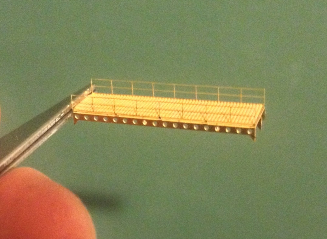

Re: IJN Nagara
Finished the main batteries. And I am currently working on the small structures between the funnels. The PE for these is proving to be a headache. I am also about to start the funnels. I have pics but need to get my computer working again to format them to fit on the website.

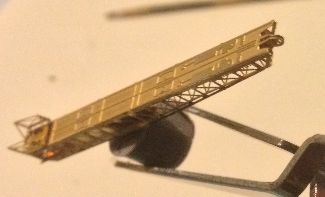

39 hours
I have managed to get the main batteries and the structures between the funnels largely completed and the main mast is now about 1/3 done. There is a lot more PE that goes on the upper portions of the mast.

Re: IJN Nagara
Dude, those PE gun shields are the bomb! So much better than any plastic. Looking fantastique!

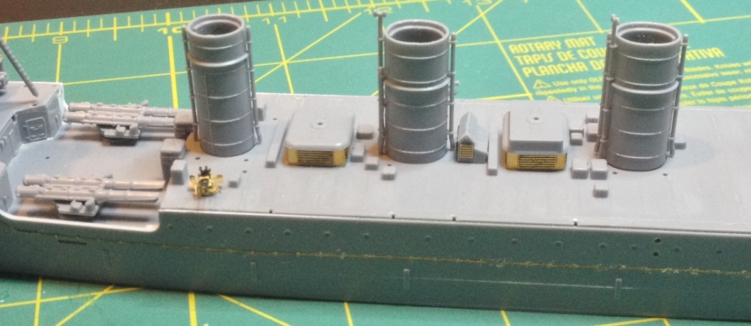

49 hours
Here are the latest. I now have all the basic sub assemblies complete and will be starting on the painting here very shortly.
