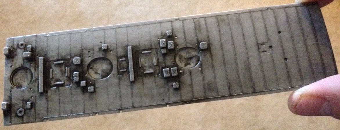

I must send an apology to Chris F. I am attempting to us his shading technique that he so kindly shared with us on his wonder USS North Carolina. So this is my sad rendition that needs substantially more practice. Everything is now sealed with Krylon Matte. Painting to start once I fix a couple of things that decided they did not wish to be attached to the model anymore.
So far I have learned a lot doing this but it should still hopefully turn out decent.
Midship deck
Midship deck
