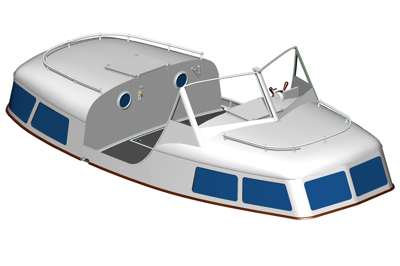

Not much happening on this part of the Forum so I thought I would post an update. A lot of things from the real world keep interfering with activities in the virtual world, so I have only a minor update.
I'm working on the 28 foot personnel boat canopy. It has lots of smooth curved surfaces and some details. Working from the blueprints makes the work go faster - not as much guestimation.
The boat has forward and rear enclosed cabins. I don't want to have to model the interior so I make the windows a dark blue, similar to how they appear in photographs. Besides, put one transparent piece of transparent glass in a large drawing and rendering times increase between 10X and 100X. And this boat will eventually become part of a one gigabyte file with millions of objects. Rendering will be an all night process without any transparent parts!
So far I have been working on only the forward canopy, although the rear canopy was the same shape and used the same molded aluminum skin.
Most parts were the same shape on all three boats, but they were painted differently.

Excellent work as usual Phil, I look forward to seeing this project all put together. :thumbs_up_1:

Here is a bit more progress. The canopy is almost finished except for a few details (searchlight, side lights, etc.). This is the OK City boat. The two 7th Fleet boats had slightly different details and paint jobs.
Then the fun part begins. These boats had beautiful wooden decks. The wood stained like dark mahogany, and the grout between boards was white. The boards were narrow, with something like 19 boards on each side at the bow, all properly cut into the center board. That is going to be tricky to model! I think I have figured out how to do it. The proof will be in the pictures!

I really enjoy following your thread :smallsmile:
:big_grin: I have the same problem to solve when dealing with the wooden deck. I am pretty sure you are going to do it very simple way.
