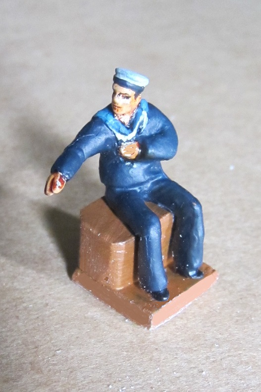

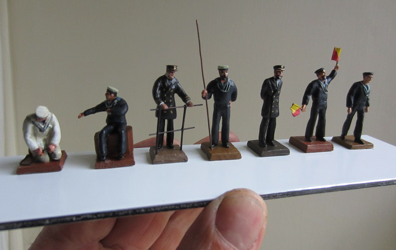

Hi all
And three more finished figures. These are destined for the picket boat model. The Officer and the seated sailor will be in the aft cockpit and the kneeling sailor adjusting the mooring lines (in white duck working uniform with bare feet) will be in the bow. The cast resin bases will be removed with a fine fret saw and a brass 0.5mm wire fitted into the legs (as a locating pin) to help secure the figure to the model.

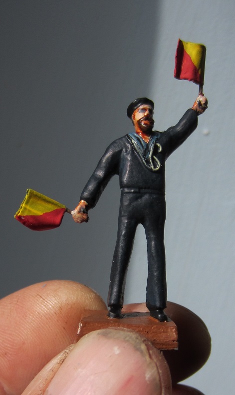

Well that pretty much finishes off the construction of these figures, some of which which were designed as a finishing touch for this picket boat model. As I said previously, there are seven figures in total, (see pictures below) but not all were intended for use on the picket boat, despite the fact they were all in suitable period clothing for 1900.
All I need to do now is to show how the figures were mounted on the finished model.
The figures have been an interesting little side project, and I would at some time in the future like to make some more, possibly a gun crew for the 12 pound QF gun on my HMS Velox model, but in the meantime I must get on with other more pressing projects.
