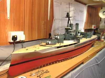

Bow shot of work to date
Stern shot of all work to date

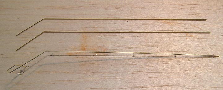

While in this section I decided to build the coaling boom, again cut and shaped from 20 year old seasoned timber.

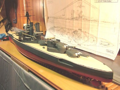

Hi Guys, You have not seen much of the Port side of the ship for a few months, as you know I have a habit of working on one side, then turning it round and working on the other, well tonights the night, Plating.
The plating on the hull is cut from sheets of litho plate, it is easy to cut with a #11 blade, you just score it a few times, you don't need to press to heavily.
The plates are slightly smaller around the stern, they are glued on with contact adhesive.
Here you can see a section ready glued to go into position.
The sections in place, all one piece, but it has been scored to look like individual plates, it is left for a while and then given a good rub to make a good contact.

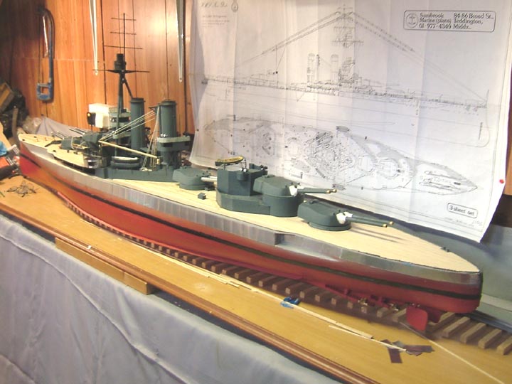

Hi Guys, I am continuing with the plating.
Here you can see the last of the plates glued on to the hull, they still have to be pressed down when glue has had time to nearly set.
The hull with the first coat of paint on the plating.
Stern view.
Second coat of paint applied to main hull and first coat to bottom plates on bow. If you try to put too much paint on litho all at once, you end up just moving it about with the brush, better in thin layers.

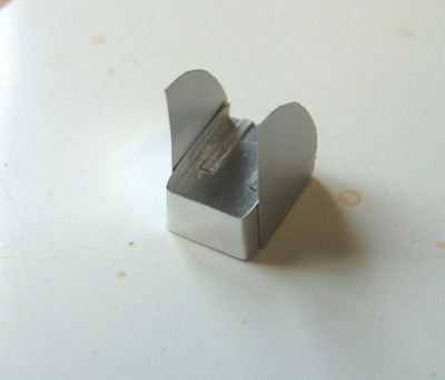

Hi Guys, more fittings,
First I cut 4 blocks of wood and rounded the corners. Then I glued them on some litho plate and rounded the 4 corners. I then cut some brass wire and glued it on top to represent the hinges. Next I folded some litho plate over to double the thickness and wrapped it around three sides, this is a blast shield, at the lower end a small piece of litho plate was glued, you can see the size of this hatch compared to the tweezers.

I then cut and bent the lower rails. Then cut and bent a top rail with an extended piece for the handrail down the ladders.

A new section fitted near number 2 turret.
A full view of the model with everything fitted, note the size of the model compared to the can of WEM paint, :lol_3: :lol_3: :thumbs_up_1:

I have been building more small fittings for the boat deck, double flag lockers p&s, square type hatches p&s, a long open hatch with grill in the central position, small lockers for lifebelts and other equipment.
Guns turned broadside to see all the fittings in these two sections. :lol_3: :lol_3: :woo_hoo: :wave_1: :thumbs_up_1:

This is a hatch near the bow, fitted in front of the first turret, hence the blast shield also the beginning of the canopy. This stops the large amount of water entering the hatch. It's built in my usual way with litho plate surrounding balsa wood.
Placed in position with hood canopy fitted.
