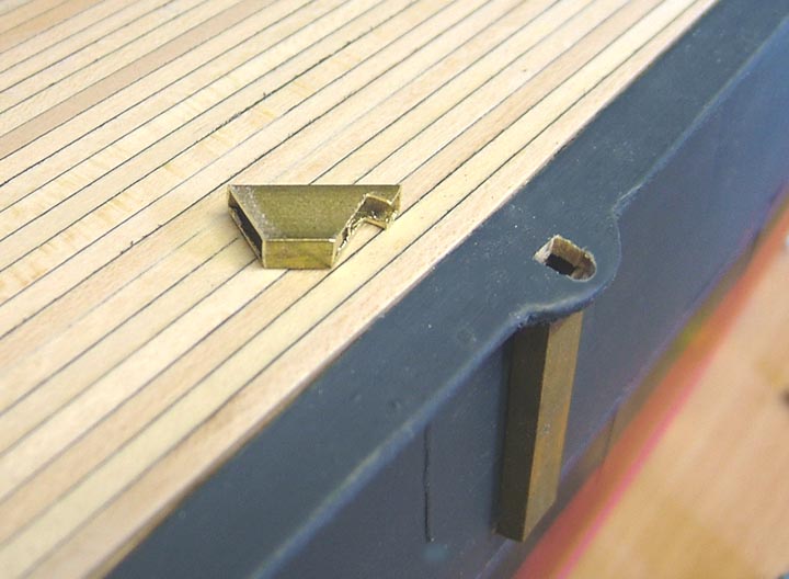

Hi Guys, A little change today, the Trash Can and another boom.
First I drilled the hole in the section I had shaped many months ago, I then enlarged the shape with my #11 blade.
I then cut some hollow brass section, and glued it in place.

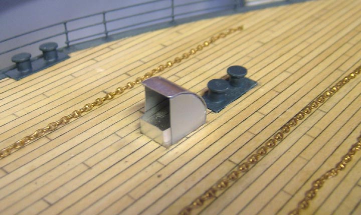

Hi Guys, more fittings,
First I cut 4 blocks of wood and rounded the corners. Then I glued them on some litho plate and rounded the 4 corners. I then cut some brass wire and glued it on top to represent the hinges. Next I folded some litho plate over to double the thickness and wrapped it around three sides, this is a blast shield, at the lower end a small piece of litho plate was glued, you can see the size of this hatch compared to the tweezers.
All 4 are now painted and drying.
I marked out the deck and cut out the planking to set them down a little.
All 4 placed in position at the stern.
Note the blast shields are all facing the turrets.

Hi Guys, two small fittings today.
This is a hatch near the bow, fitted in front of the first turret, hence the blast shield also the beginning of the canopy. This stops the large amount of water entering the hatch. It's built in my usual way with litho plate surrounding balsa wood.
Placed in position with hood canopy fitted.
