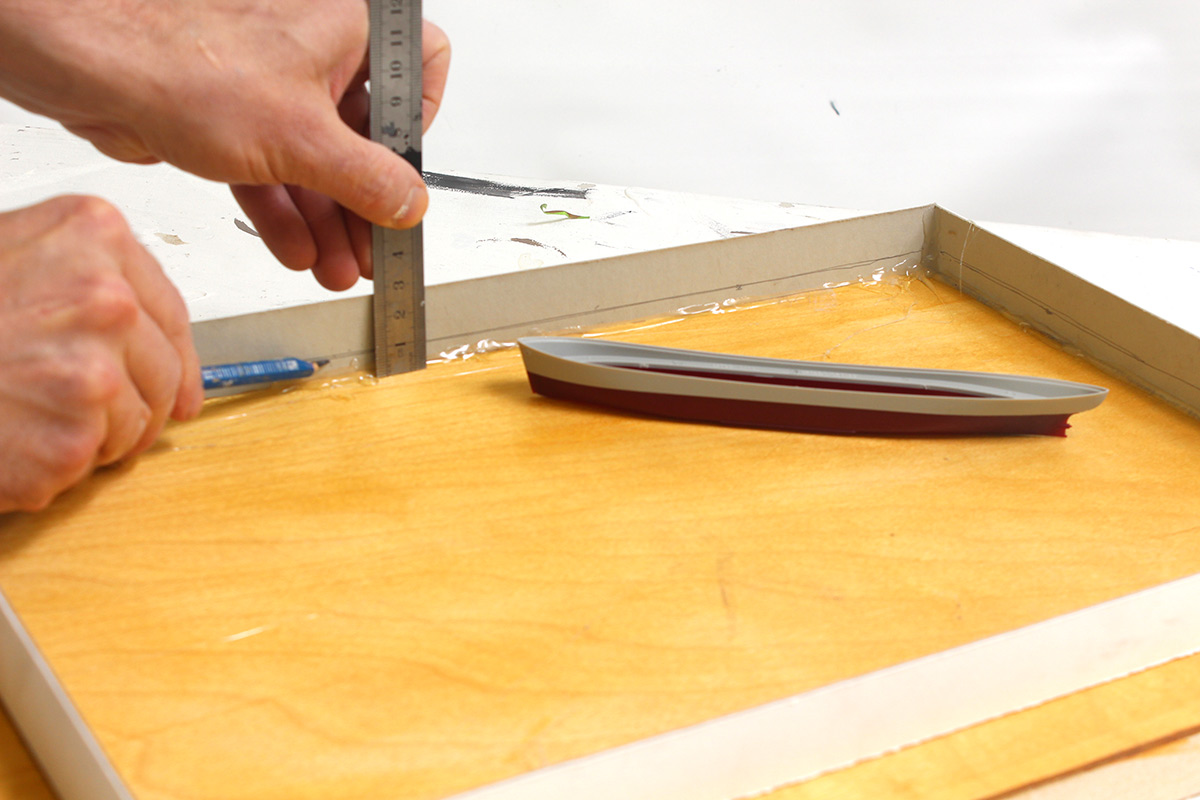

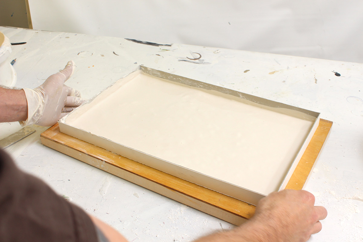

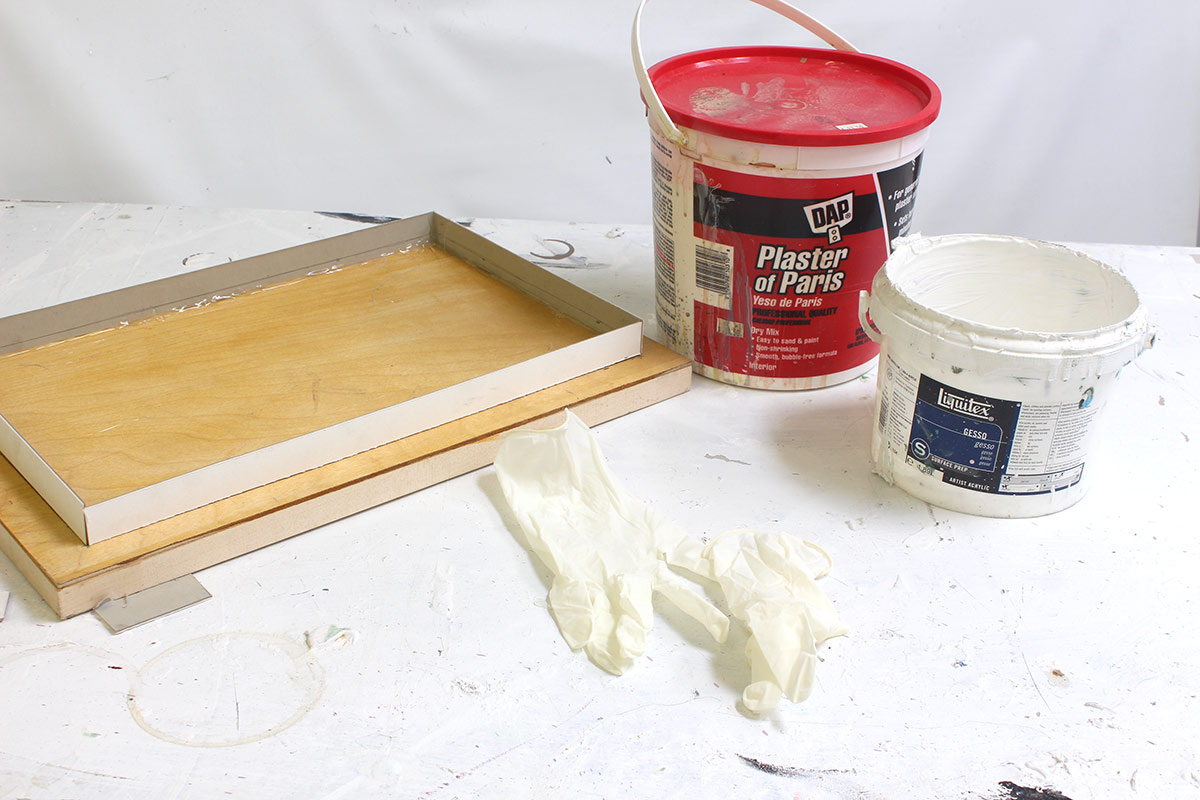

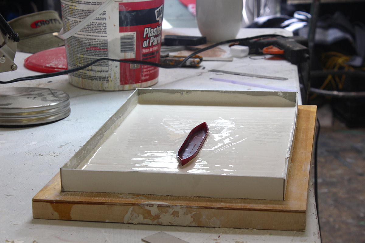

Here is a photo-tutorial for how I've done some calmer waters. I whipped this sea off for the tutorial so it's not the greatest, but it shows how I did the calm water in my Graf Spee diorama Using plaster http://www.modelshipgallery.com/gallery ... /index.htm.
Usually my models are 1/350, this little 1/700 hull was used as a test piece for the demo.
Although the plaster can give great results, these days I'd probably do a calm sea using pink styrofoam and clear medium. Full tutorial for that technique here: viewtopic.php?f=4&t=158909&p=651903#p651903
Plaster can work, but it's kind of messy and out of control. But for what it's worth, here it is.
For rougher or rippled seas, I've outlined other methods here:
viewtopic.php?f=4&t=155661
- I use pre-made artist's painting panels for my bases. Here I've cut heavy illustration card into 1/2 inch strips. I will build a small wall to contain my water. This wall will be trimmed later. IT IS CRUCIAL THAT YOU SEAL YOUR INSIDE WALLS AND BASE WITH ACRYLIC MEDIUM ONCE IT HAS BEEN CONSTRUCTED. The wet plaster can warp your base and mush-up your cardboard walls. Sealing it will prevent this.

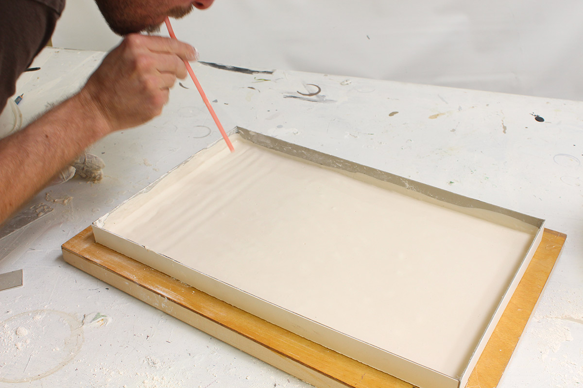

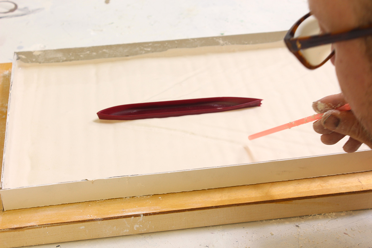

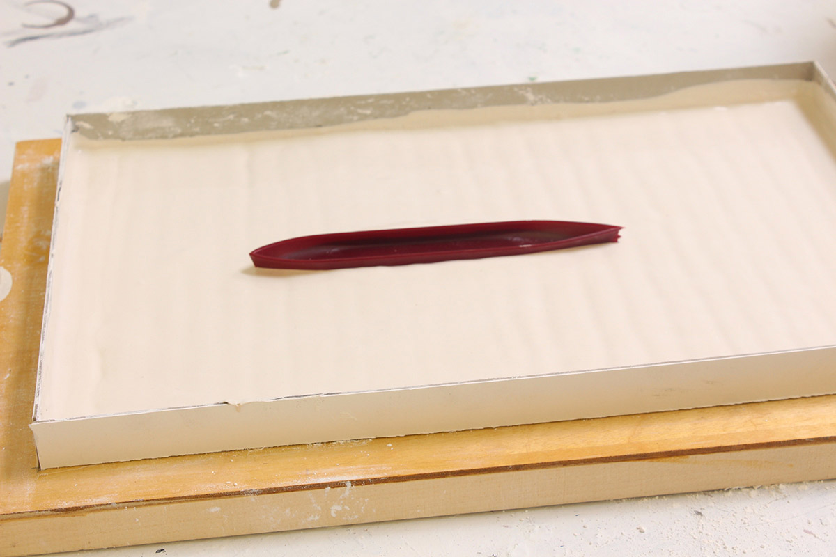

- If you want, you can now blow in some trailing wake. Vary your blowing distance as the wake moves away from the ship. Study how trailing wake moves back and away from the ship. These wake lines will intersect the breezy horizontals and make a moray pattern. This has a strong 'how did you do that' factor.

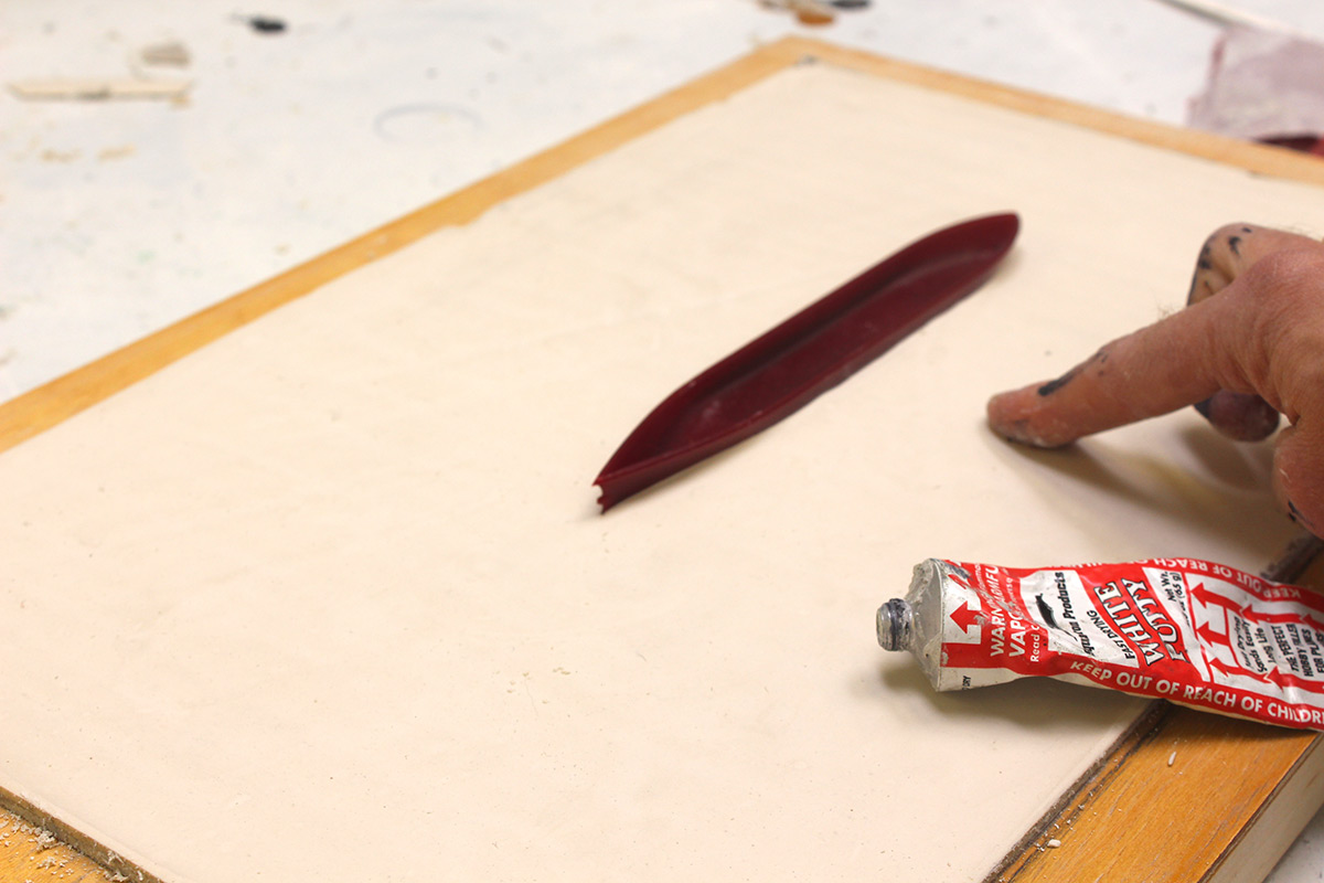

- Here I have painted the water a dark bluish grey and have applied dozens of coats of High gloss acrylic varnish. The gloss really kicks things over into a truly liquid effect. The more coats you do (brushing with the waves of course) the better it looks. Leave your plaster at least a week before you paint and finish it.

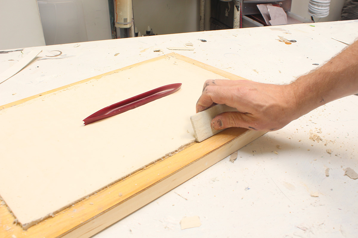

SOME IMPORTANT NOTES ON THIS TECHNIQUE
-Adding some cardboard feet or some dremeled grooves to the bottom of your ship will give the plaster something to grip and will secure your ship in.
-If you screw up your water, it's easy to simply remove the ship out of the damp plaster with little mess to the ship so you can restart again.
-When you place a full hull ship into the plaster, the displaced plaster will form a mound around the ship. It is a good idea to waterline your ship for this process. if you don't, be sure to sift out this displaced mound.
-Thoroughly allow your plaster to dry. If you don't, you will get poor adhesion of subsequent paint layers.
-If you plan on coating this water with epoxy, first allow your plaster to dry for at least a week. Then, after you've painted your water on, give it 24 hours to fully cure. If you apply epoxy onto un-cured paint/plaster, you will get a foggy, patching effect known as bloom. It will ruin your sea. I strongly recommend NOT using epoxy as a shiny coating. Multiple layers of Liquitex High Gloss medium is ideal, permanent, non-yellowing, and extremely shiny.
-If you get bloom, repaint the water colour right onto the epoxy, wait, and re-apply more epoxy. This isn't great, but it'll save things.
-The wet plaster has the ability to warp your base as it is curing. Before pouring your plaster, seal the inside of your 'well' with acrylic clear medium. This will prevent warping. Be sure to coat your cardboard walls as well.
-Until the plaster is fully cured, it will crumble at the cardboard walls while you are trimming it. This is lame.

Anyway, I've divided this example with some rolled up tape. On the right, I've used Woodland Scenics Realistic Water; on the left Liquitex Gloss Medium/Varnish. The Woodland brew is very clear and I may actually have a little too much on. The Liquitex is quite clear and both are very hard. (The photo makes it appear that the left side is lighter - that really reflects the angle of the photo: they both cured very clear.) One difference though and I'm not sure if it's good or bad. The Liquitex has a slightly coarse texture on the top: perhaps there's a little more air in it. But I'm not sure that's bad. I do a lot of fishing in SF Bay and even during a dead calm the water always has a kind of shimmer to it - doesn't look like glass. The Woodland does have a mirror quality: that'll help when I get the riddles in better shape, but I'm not sure if it isn't going to be too translucent. May well be that I've got too much gloss agents on altogether. Next one will go on in two thin layers. One of these has to be it I think - my place is small and I don't want to mess with expoxy.

That looks like it'll work. If worst comes to worst, you can always just pull the ship out of the semi-cured plaster. It slips out quite easily. A few minutes of clean up and you're ready to go again.
Once you do your plaster and it has totally cured; fill and sand it. The fewer divits, lumps, grits, holes etc. the better. You can always go back with some acrylic clear medium to affect some wavelets on top of the painted sea.
You might also give some pink styrofoam a try. Honestly, I only use foam these days for all types of sea. If you can cut that hole perfectly, you can make pretty convincing water by simply squeezing squahing the faom...or even carving it. It sands well and after some filling and additional sanding it can look really great for calm water.

Lovely photo EJ. Wish the waves were generated from the bow - be hard to use for a single ship base.
I've been futzing with adding waves on top of cured water effects or gloss medium and it works well enough. (I've seen several YouTube railroad guys making little round water effect circles on wax paper: when dry they stick them on to a pond, lake etc and they look like ripples.) What I don't see, however, is how you get the trough effect so evident on EJ's photo.
Gotta to admit that project fatigue is setting in. But if I can't get decent results with plaster I can buy some foam and get out a lighter. Lord knows I have every gel known to man. I was very tempted to buy a nice wooden base to use for photo purposes and then find a comfy place to sit the model where I can see it. I do like to look at my own models and that would be impossible if each had some kind of base.
BTW: I've used some of the Golden High Flow and they do look good. What they are is a thinner version of Golden Fluids, a brand I use all the time. (A little like Vallejo thin Model Air vs thicker Model Color). I've got an early WWI biplane next up and it will need linen wings: I think a tad of ocher in with white will get pretty close. Then we'll see.
