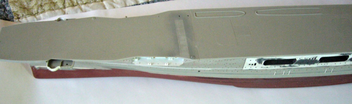

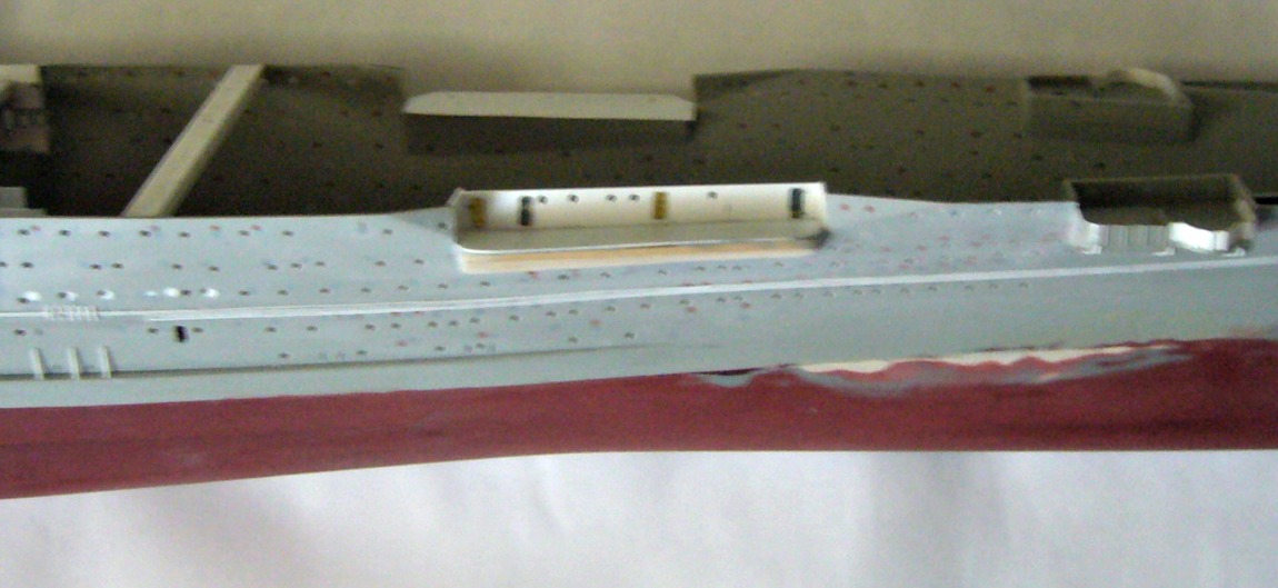

A couple of small steps and then a biggie.
I lost (broke in removing) the fairleads for the 5" gun recesses along with the bollards as previously covered so I set out to make a few. Started with some .040 sheet scraps and cut it down to the necessary size. Then I marked out the size of each one and drilled out the middle. Then I cut out the top with some sprue cutters. Then I separated them into itty bitty pieces. Now I had to file and sand them into the necessary shape. I ended up using a small pair of needlenose pliers as they kept twisting in the tweezers when I first tried them. Then it was glue them in place. The pics I took of them in place were fuzzy so I won't post those but the fairleads will show up in some other pics.
Now it was time for the biggie, glue on the flight deck! Haven't done that before so I used liquid plastic cement, figured a longer set time and a better hold once finally cured. Did I learn differently! After clamping the bejeepers out of the deck I let it sit for a couple of hours. Found a couple of spots that were still loose so I reglued and clamped one of them and left it overnight for good measure. Started today and found a few other places that didn't take so started to fix them when the fun began. In trying to make just a little room for glue I popped off one of the boat pockets. OOOOOOH S--T!!!! Now I've got a boat pocket flopping around inside my carrier. I tried to get it with locking tweezers and hold it just inside, glue it, and then pull it up tight. Naaaaah, too easy so it didn't work. Afer several futile attempts I started peeling back the flight deck for access. Ended up opening it from the aft 5" gun area, down the side, and around the front. I needed to get enough room to get my ham handed fingers in there because I couldn't get a clamp to work although I tried several. Along the way I found the joints still soft, could slice right through them with a knife, so decided I would put it back together with CA after scraping the surfaces clean. So I went bit by bit, glueing, holding, glueing holding, and had it done in no time without all those clamps and fuss. Let it set a bit and then started sanding all the seams and that's where I am now. Haven't filled any seams but that's next on the agenda.
James

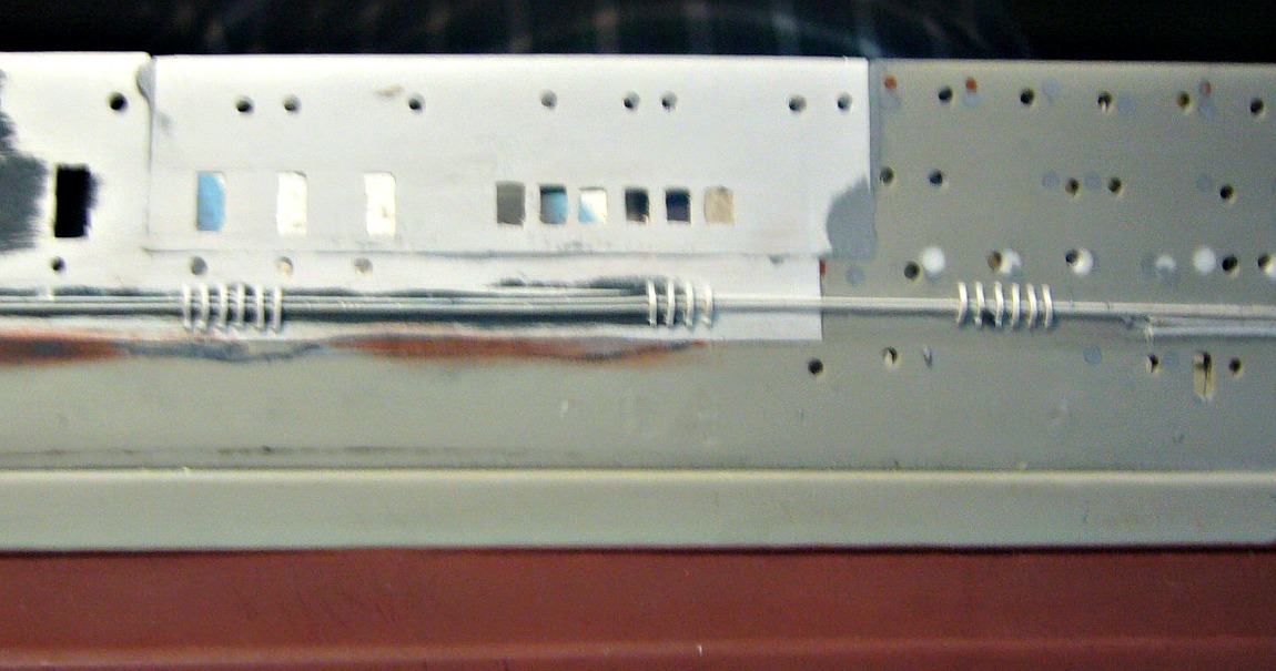

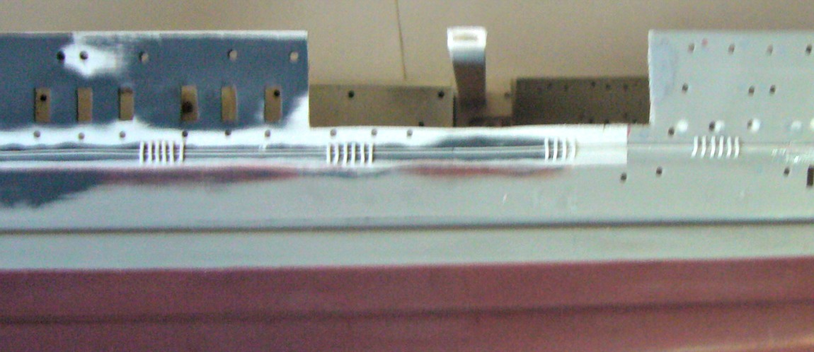

It's been awhile since I posted and there isn't a lot to show but it has been a lot of tiny, tedious, work. I've been making the kind of rectangular tie offs along the water line. There are twentythree of them and the way I did them it required 69 little square pieces of .020 in .060 squares with .3mm rod to make the loops and supports. Could only work for a bit and then it got too hard on my eyes. I finally got them all done, broke 2 #80 drill bits along the way, and just as I finished the last one I broke one further back. :Tirade: so I proceeded to clean it up and redo it and broke one on the starboard side! So then it was the repair process all over again but no more breaks this time. So now it's on to the drains and stuff in the same area. No real details in the plans so it's check all the pics you can and go for it.
James

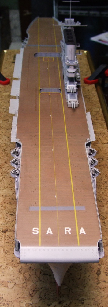

James, hello. I want to thank you.
Approximately eighteen months ago, I saw your work and wanted to build a USS Saratoga at the end of the 1930s. Looking at your work, I'm a bit of kit fixed Trumpeter At the moment, the model looks like this, there is still a little to finish and correct some errors.
Without airwing
Without airwing
Without airwing
Without airwing
Without airwing
Without airwing
Airwing added.
Airwing added.

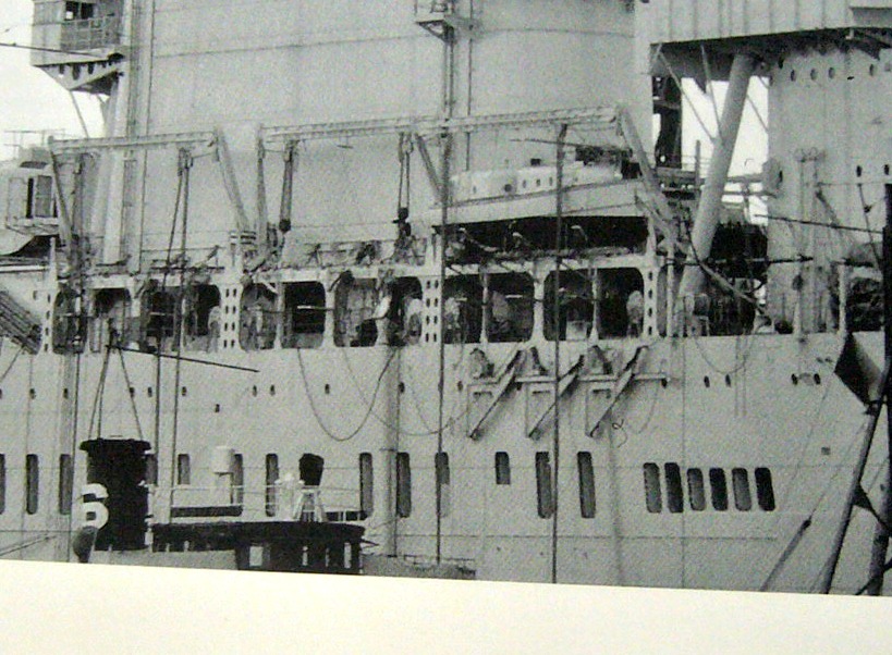

I see you are still on the hull...if a master like you can take his time, then I don't feel so bad that I started on my boat pockets a year ago and then got off to another project and haven't touched the Lex since. I will have a build log soon, but for now, I hope you will share your knowledge with me on two points...
#1. I have the Stern book and the Squadron at Sea book on the way, so forgive me if the answer is there, but what evidence did you use for how you made the vent trunks in your boat pockets? I always assumed from the plans that the vents were flat gratings on the decks of the boat pockets but yours extend above the deck. I can't find a single picture that shows the interior of the pockets well enough to tell me anything about those vents.
#2. I am looking at pages 6 and 10 of the Wiper#33 book...specifically at the hull bulges...in the first picture here taken from page 6, the port side hull bulge appears to have the sloped top surface and then the vertical side, similar to what is cast on the Trumpeter hull...
However, in this picture of the starboard side taken from page 10, what in other pictures appears to be the sloped top surface of the hull bulge actually looks like it protrudes from the surface of the hull, almost like an additional bilge keel just above the water line. Are my eyes giving out on me or is this a detail that was changed later?
Thanks!

Mgunns
Posts: 674
Re: WIP - 1/350 USS Lexington (CV-2)
Post by Mgunns »
Hello Doug W.
It looks like a platform attached to the side of the hull for people to paint or whatever else working party they would be on. It isn't a permanent fixture. If you look down the hull you can see the attachment points all along the hull just above the water line. I look forward to your posts as it looks like Squarerigger hasn't posted in quite some time.
Mark

Posts: 4103
Post by ModelMonkey »
As a comparison, on the 1936 plans for sister Saratoga, that feature shows us as a hull blister on Sara's port side outboard of the armored belt. Its slope changes from fore to aft.
These plans are for Sara as modified in 1941 receiving a large starboard stability blister. Perhaps Lexington would have received the same modification had she survived Coral Sea.
And a beautiful build you have!!

Boy! Don't check in the forum for a few days and of course everyone decides to comment or question. :welcome: Any way Doug, in answer to your two questions I have one of my own: Do you have a set of plans of any sort? And the short answer is if you go back to page 13 of this log I describe how I found the picture in Squadron at sea, there are a few on pgs 13,15,17, and 19 that show Lex under construction and you can see the bulge very clearly. Most particularly the one on 13 is looking forward on the hull and you can see how the hull dips in and then the bulge starts out. If you scroll down slightly I detail how I made the adaptation for this but there's only one picture of the model and it really doesn't show up well.
On pg 14 I detail how I did the pockets and there's a blowup and crop of one of the pictures on pg 36 of Squadron at Sea and you can see the pockets very clearly. What I usually do is copy the photos and enlarge them so I have a bunch of 11x17 papers that I can look at and see the details a lot better than the small pics in the book. I also have a large collection of pics that I have found all over the place online to refer to along with the books you mention and a few others.
Hope that helps and if you need more or are still confused don't be bashful about asking.
