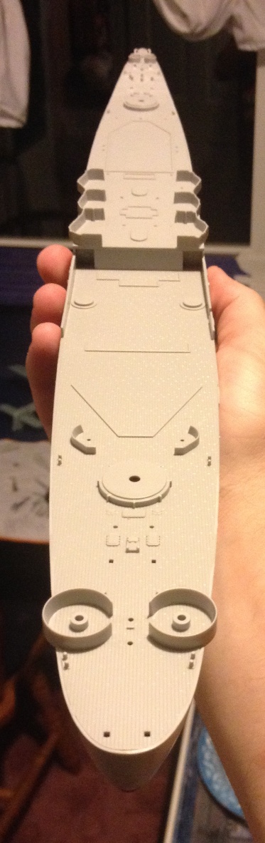

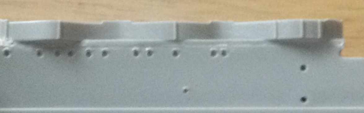

4 hours in
I removed the horrible propeller guards, chocks, molded on anchor chain and leadsman platforms. I also drilled out the hawsehole, the tow rings, and a very tricky angled drilling for the anchor chain on the fo'c'sle which broke one of my drill bits in the process.
Everything you see has been glued on. In order to make the decks flush to the top of the hull I could not use the placing lip inside the hull, but I managed it alright I think.
Does anyone know if the 8" guns would recoil when fired? Also I found a picture showing the splinter shields for the forward most 20mm, and they appeared to be different than the kit's. The picture was dated after WWII though so I do not know if Trumpeter got it right or not. Like wise are there any other corrections I should be aware of on this kit?

They'd have to recoil. Otherwise, everything attached to them would be damaged, or so heavily constructed that the ship would be extremely top heavy.
The recoils on ship guns are much shorter than land guns like howitzers. For instance, the 16 inch guns of Missouri only recoil 48 inches. Whereas the m-198 howitzer (155mm) of my USMC artillery career could recoil up to almost 8 feet depending on the charge fired.
I've seen footage of the US 5-inch secondaries firing. Their recoil is amazingly short, and easy to miss if you blink.

The MK 12 8 inch gun is listed as having a 32" recoil. There is a photo of the forward turret firing on page 51 of the CW pictorial. It's hard to tell due to the angle, but it looks like the might be some perceptible recoil. The bow 20mm shields are close but not quite right. The forward faces are flat but there is a section nearest the center line that angles more towards the stern and is more square vs the Trumpeter gently curved version. I am fairly certain that there was a standard RS locker in the forward part of the tub and the way Trumpeter has them, that would not leave much room for the gun mount and crew. The way that I was going to fix was cut the forward part of the shield off, extend it forward as on the real SF the centerline bollard is almost completely flanked by the tubs. On the trumpeter kit, the bollard is forward of them.
HTH and post more pics!
