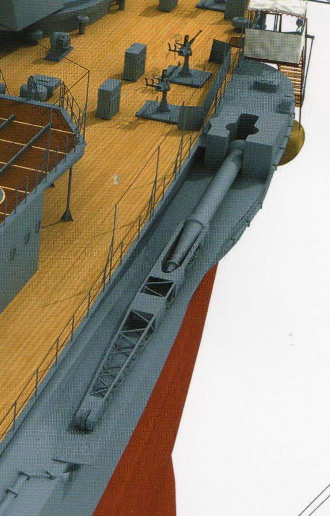

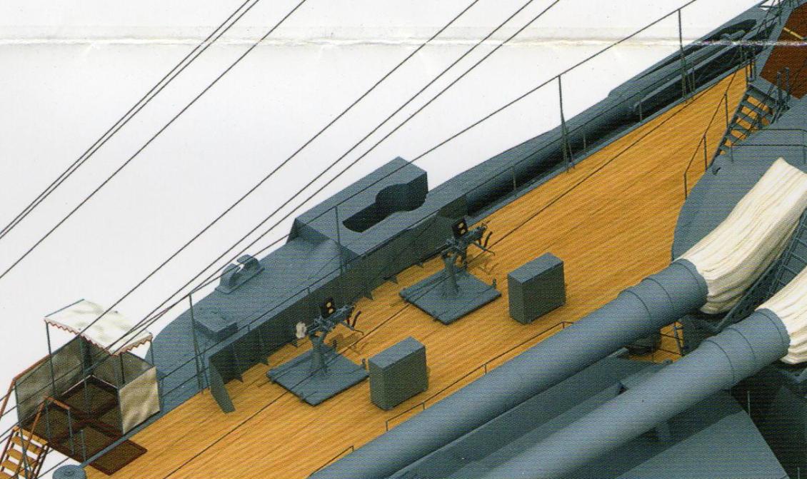

some illustration of folded crane from ajpress nagato vol 2
