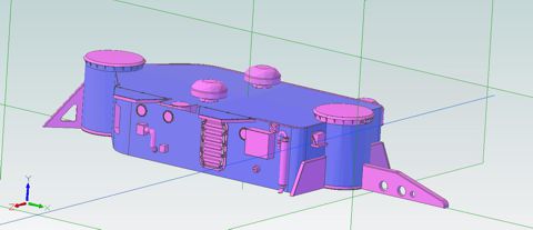

Okay, here’s the start of my USS Sims conversion set for the Dragon 1/350th Benson.
A little background... This is really meant to represent either USS Sims or USS Hughes in 1941-42. There are some wonderful photos of both ships care of a photo CD that Devin Poore sent me awhile back (thank you!), but especially Hughes, that supply a great deal of detail, and since I’m partial to early war vessels, the choice was obvious. I’m using the Floating Drydock’s Sims plans, as well as those from Profile Morskie, but the photos are the final word as I’ve found that while the plans aren’t wrong, they are sometimes lacking in details.
The basic parts are CADded up in 1/96th scale in Alibre/Geomagic Design and then scaled to 1/350th. Moment of Inspiration, a great NURBs based program, is used for some of the organic shapes like the gussets on the funnel’s base. Don’t worry, they’ll be placed as soon as the rest of the part is done. Geomagic just can’t handle the loft, while MOI can. Geomagic is super for 2D drawing and I love what it can do when it isn't crashing (Grrrr....), while MOI is rather intuitive and easy to learn, and again, is super at handling organics.
Anyway, I’m at the design freeze point for both the midships deckhouse and the funnel. I’ll need to scale them and then do the remaining small details in 1/350th to ensure that the walls aren’t too thin for printing. A lot of the small details like bolts and rivets are probably unprintable in 1/350th, but maybe someday soon they will be as the technology improves, so I've included them. So, what did I do wrong? Where can I improve the parts? The after deckhouse is yet to come and maybe a few other items, but I want to finish what’s already been done before moving on to it.
The midships deckhouse and its small details are specific to Hughes, but as she and Sims were built in the same yard, I’m assuming (yeah, I know that can be dangerous) that they would have been pretty much identical early on in their careers. I’ve not placed rain gutters over the hatches and portholes as I can’t see any. Can anyone confirm them on Hughes or Sims in 1942?
The funnel is another matter. There are a lot of subtle shapes in there and the various ships of the class had slightly different funnels, mainly with the piping and the whistle platform arrangements. I’m doing the piping as Sims/Hughes-specific as possible, but am then falling back on pictures of Russell to fill in the blanks. There is a large mushroom vent at the main deck level that pokes up in between the forward uptake legs, so no worries, I haven’t forgotten that. As an aside, I do believe that the various building yards handled the funnels differently, as photos often show very subtly different shapes to the base, legs and gussets. There's nothing I can definitively point to, but different funnels from different ships built in different yards often have ever so slightly different appearances to my eye, however subtle.
Thoughts? Stuff I’ve totally botched and screwed up? I'd like to fix things now before the drawings are scaled and finalized. I've already uploaded a test file to Shapeways and they claim that the deckhouse is printable in 1/350th, but we'll see - I've heard that from them before only to have parts rejected during printing.
Thank you for any pointers or ideas.
Bob
PostPosted: Wed Feb 04, 2015 3:17 am
Posts: 1677
Bob,
You certainly are correct that ships of the same class can be different. I have been studying the Cleveland class (27 ships in three versions from four yards) and there were a lot of changes over five years.
Different yards have their own ways of doing things, no matter what the blueprints show. But even in one yard there may be incremental changes. As ships are built errors are often found in the drawings, or just better or faster ways to do things are discovered. Drawing revisions are published periodically and applied to new construction, so two ships being built side by side may have noticeable differences.
Furthermore, during WWII ships in forward areas often didn't get any upgrades until they had enough battle damage to bring them back to a shipyard or tender. And then there are the changes made to individual ships by the crews - a cleat here, a life raft there, and maybe even a new compartment topside. In classes with a lot of ships it is likely that no two were alike by the end of the war.
With the Clevelands many of the revision drawings have been lost, so photos of the particular ship at the desired time are essential for seeing how the ship was actually constructed.
You model looks great!
