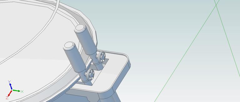

Working on the whistle platform. The little attachments linking the piping to the front of the funnel were apparently little pieces of sheet metal, among other things, so I've had to simplify things to make it (hopefully) printable.

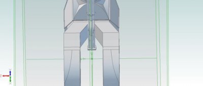

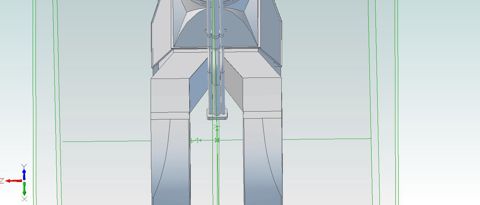

Re: Sims-class conversion
Here's the forward piping. As I can't find any pics of how those forward pipes terminate, I just carried them down to the main deck level and placed a little reinforcer there to better allow it to be glued to the main deck. The reinforcer isn't canon at all, but it will need to be there for printing. Otherwise, those pipes are viewed as "hanging wires," and they usually won't print.
Can anyone offer suggestions on this solution? Does it look okay or totally wonky?

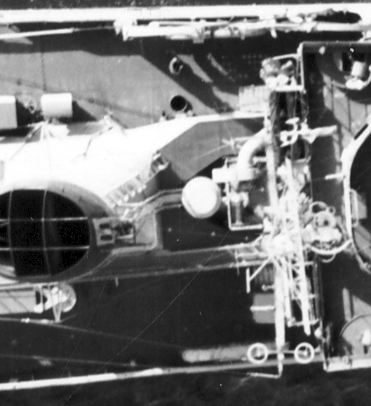

- Posts: 3880
I'm not sure if these will help or just add to the confusion. One as you already know, the configuration of these destroyers changed during the war and some variation took place depending on where the yard work was done at and WHEN. The Pacific and Atlantic based units had fairly noticeable differences. Finding detailed views of the area between the bridge and stack on almost any destroyer type is a REAL CHORE. It just wasn't an area that got much attention in making Mods. Also, you will find that this area seemed to have a variety of added on platforms intended for walkways and for stowage. The stowage platforms can REALLY vary from ship to ship since they fell more into the "crew-desired" modifications category.
In an effort to address your questions about the "Steam Whistle" pipe routing and configuration in general, I have posted some close-up views of DD-411 and DD-413 in 1943 post upgrade overhauls at MINY. The Photobucket views show profile views of the area between the bridge and stack including the Whistle. I tried to locate a good OVERHEAD view or a view from FORWARD of the whistle area taken in a yard somewhere, but I couldn't locate a good one that was in focus or very close-up. At the bottom are two overhead views of the same two destroyers taken in 1946 just prior to their use in the Bikini Tests. DD-413 was the only SIMS class unit to complete the Anti-Kamikaze Mod.
It looks to me like the steam lines follow the contour of the stack forward face and then go down just aft of the mushroom vent positioned between the two forward "legs" of the uptakes. I have drawings for these ships, but they don't really show this detail very well. The "vent" located there shows up on the 01 deck level of some drawings, but the vent passage on the main deck doesn't show nor the steam line entrance below decks. The attached view shows the location of the mushroom vent and you can assume that the steam line passes through the deck just aft of it.
One of the interesting things that these views show is the starboard side walkway from the bridge area aft. There isn't a corresponding walkway on the portside.
Thank you so much, everything helps. The differences between the steam lines has me stumped, and is the reason I've decided upon a more generic look. In 1/350th, the small differences hopefully won't be too noticeable should the builder decide to use the funnel for a different ship than Sims or Hughes. I can see where the two outboard pipes change in contour as they near the platform, but I can't get this danged CAD program to replicate that.
Bob

- DrPR
- Posts: 1689
Looks like there is a center hot steam supply line with lagging, and two outboard condensate return pipes without lagging.
At the top I think I can see a whistle and a siren, but I can't enlarge these off-site images to get a better look.
Below the platform is some stuff wrapped in lagging - possible the steam separators.

It also looks like the center pipe doglegs away forward from the funnel about 2/3rds of the way up. I'll need to redo the design to reflect that. Currently, that center pipe just touches the forward curve of the funnel lip where is shouldn't. My new PC is coming soon and the current one keeps crashing whenever the CAD program gets fired up, so I may not make any changes for a few days.
Bob
