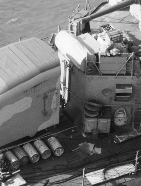

2) Aft Con Station. As best I know, there was only a compass and communications equipment with the engine room and emergency steering below decks. This is as good a place as any to mention that DEPENDING on when ... timeframe ... AND WHICH sub-group of SIMS class destroyers you are modeling, the aft con station was located in various places and had slightly different configurations.
When the war started "officially" for the USA on 7 December 1941, the SIMS class appears to have been in a minimum of THREE Configurations. The nine units heading for the Pacific from the Atlantic Fleet were from one DesRon unit, but they were quickly updated with revised layouts and had 20-mm guns installed in place of 50-cal MGs. But, they were divided into two groups based on which yard they were modified at;
Norfolk Navy Yard group retained a small deckhouse atop the aft main deck deckhouse. The aft con station was atop this small deckhouse at the far AFT edge.

I don't have any image looking directly at the aft con station equipment for ANY of the Norfolk Group. Here is a view from forward looking at the location. Also here is a 1945 overhead view looking at the aft con station on MUSTIN in 1945. Without any other info to go on, this should be representative of these stations.
3) View of the aft end of the aft deckhouse. Here is about as good as I can get. The 54 mount kind of gets in the way. :smallsmile:
