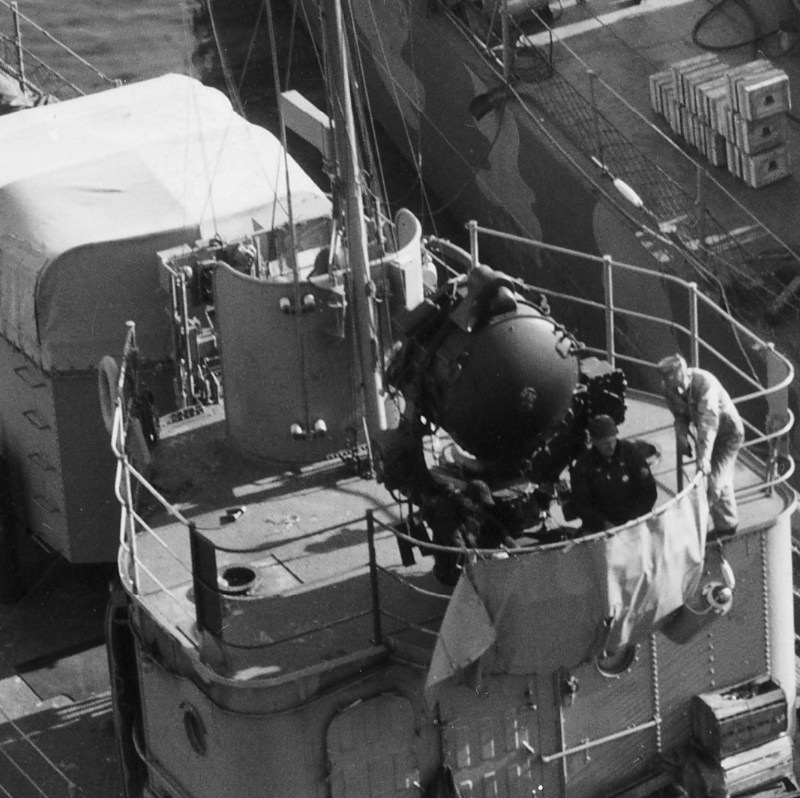

You have asked about the SIMS group, I don't know if that is your solo focus or not for your CAD design. The two groups in the Pacific stayed pretty much in the same configurations until after the Battle of Midway. After which, modifications varied for almost ALL of the surviving units until the installation of two twin 40-mm mounts "sort" of standardized everything ... sort of. The variations depended on when and where top-hamper was removed and in general two 20-mm guns were added.
I don't have any image looking directly at the aft con station equipment for ANY of the Norfolk Group. Here is a view from forward looking at the location. Also here is a 1945 overhead view looking at the aft con station on MUSTIN in 1945. Without any other info to go on, this should be representative of these stations.
3) View of the aft end of the aft deckhouse. Here is about as good as I can get. The 54 mount kind of gets in the way. :smallsmile:
