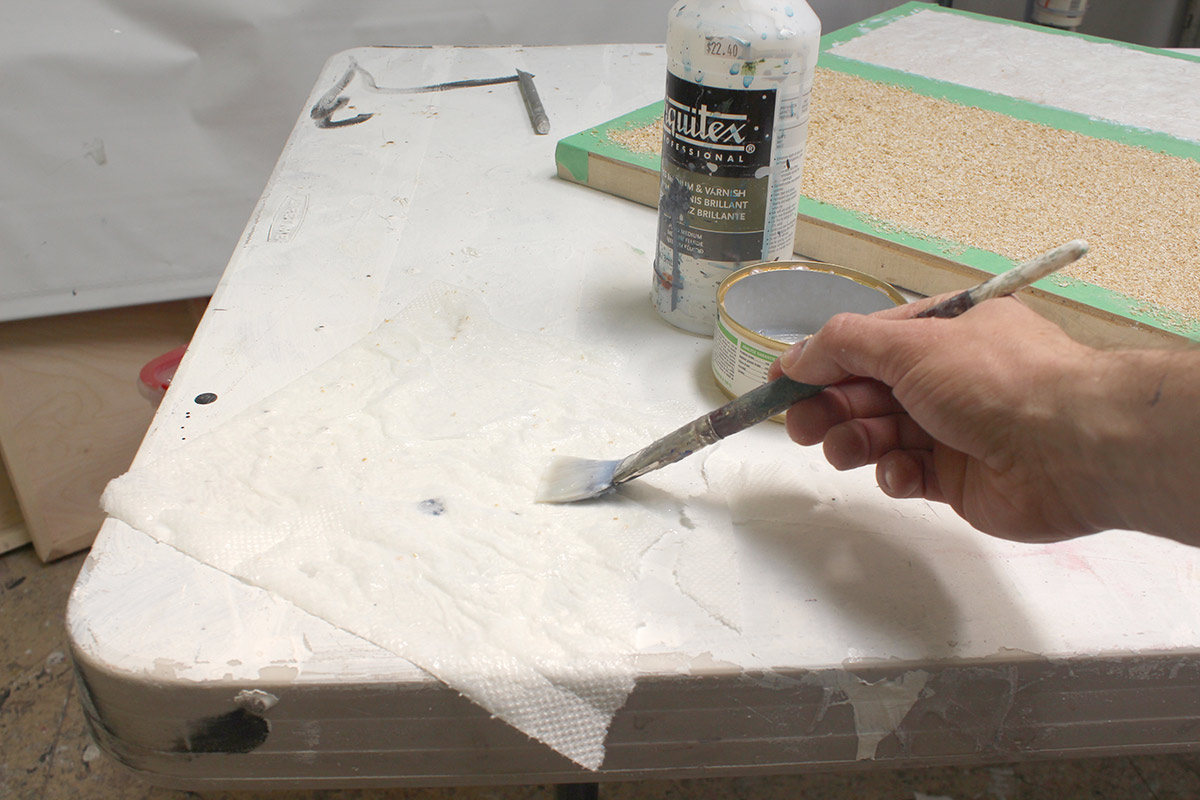

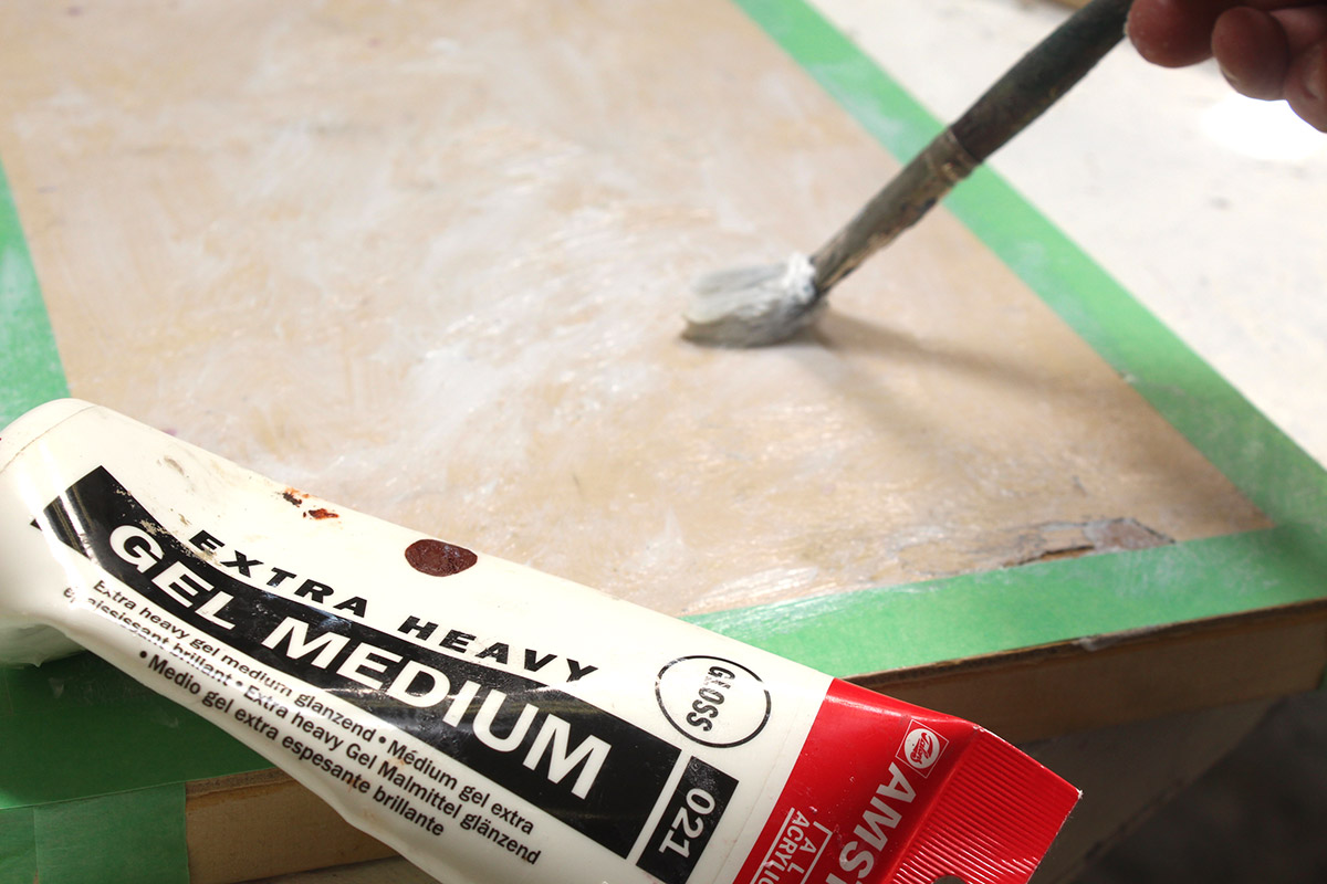

- Here I am brushing a thick layer of heavy artist's gel medium onto my ocean surface. This layer must be fairly dense as I will be sprinkling oat bran onto it. I have recently discovered that it is far easier to simply use glue down one single sheet of paper towel by applying spray contact cement to both surfaces and carefully laying it down.

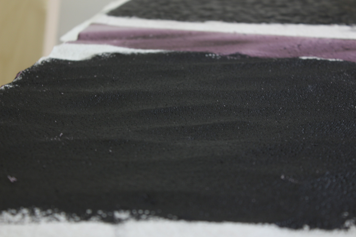

- Once dry, I have now painted the water colour on and top-coated it with HIGH gloss acrylic varnish. I love this stuff as it's nearly as shiny as epoxy. If you feel that the ripples are still too lumpy or detailed, you can add more layers of paper towel at this point. In real life, this water looks very convincing and real. There's no sense there were oats underneath. I now finish all my CA-oat seas this way.

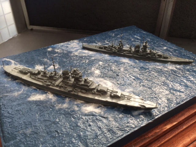

Not sure how well it would work for larger scales (1/700, 1/350), but at 1/1200, plain facial tissues (kleenex, etc) works pretty well. I've been playing around with seascapes and used Chris' foam method with plain kleenex to finish out the Bismarck and Prinz Eugen from the Airfix "Sink the Bismarck" set. I'm currently working on a 1/700 a diorama of Hornet (CV-8) and Russell (DD-414) at Santa Cruz, so we'll see if it works something a bit larger.
I'm still pretty recently returned to the hobby after 15 or so years, so all of your tutorials have been very greatly appreciated Chris!
