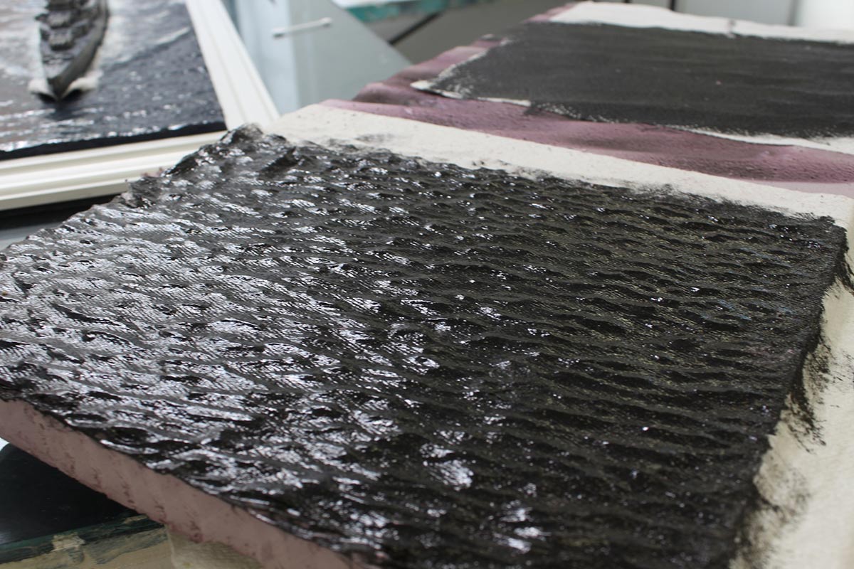

Regardless of how you make your initial sea sculpt, the wave surface is its own issue. In the past I've used oat and CA to make an ocean sculpt, but prefer styrofoam these days. viewtopic.php?f=4&t=155661
Either way, I'm left with a rough surface that needs to be dealt with. If I want thousands of wavelets, this is one way that I might go about doing it. The look is distinctly different than something you can do with a brush and some kind of textural medium.
The principle is simple: You use paper or paper towel bits to cover a lumpy surface (such as oats, coarsely carved foam etc.). The paper bridges the texture and after a few layers of acrylic medium and some light sanding, the final surface appears smooth, undulating and naturalistic.
Here I am using paper towel. For a different look, I've also been using torn up regular copy paper as it hides the oat texture even more. My Huron diorama as well as the Titanic diorama both use the method below. My Z-30 build is done with paper over carved foam. Here is a link: viewtopic.php?f=4&t=157503&p=637865#p637865.
It wouldn't be a stretch to simply carve styrofoam as I did with the Z-30, glue down a texture such as oats, and apply the technique below directly on top of the styrofoam sculpt. You could also just texture the styrofoam with some kind of tool and cover it with paper towel.
Regardless of how you make your initial ocean sculpt, the process below can be applied on top for a light, ripply sea.

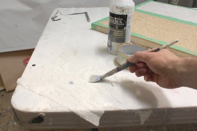

Here I am brushing a thick layer of heavy artist's gel medium onto my ocean surface.  This layer must be fairly dense as I will be sprinkling oat bran onto it.  I have recently discovered that it is far easier to simply use glue down one single sheet of paper towel by applying spray contact cement to both surfaces and carefully laying it down.

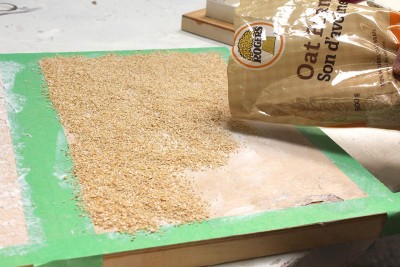

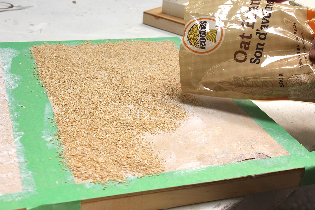

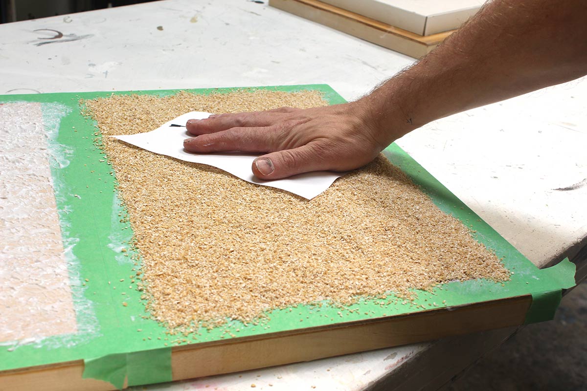

Here I am dumping oat bran onto my wet gel medium.  Normally, my sea scalpt is already made of oat bran and CA so this is not a usual thing for me to do.  However, if you don't use oat bran and CA for your sculpt, this is what you'd do onto your usual method.

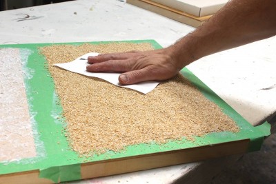

I'm using a paper towel to press the oat bran into the gel medium.  I want it to stick.  Once this surface is dry, I will brush a layer of regular acrylic medium on top of this to make things more solid and glued down.

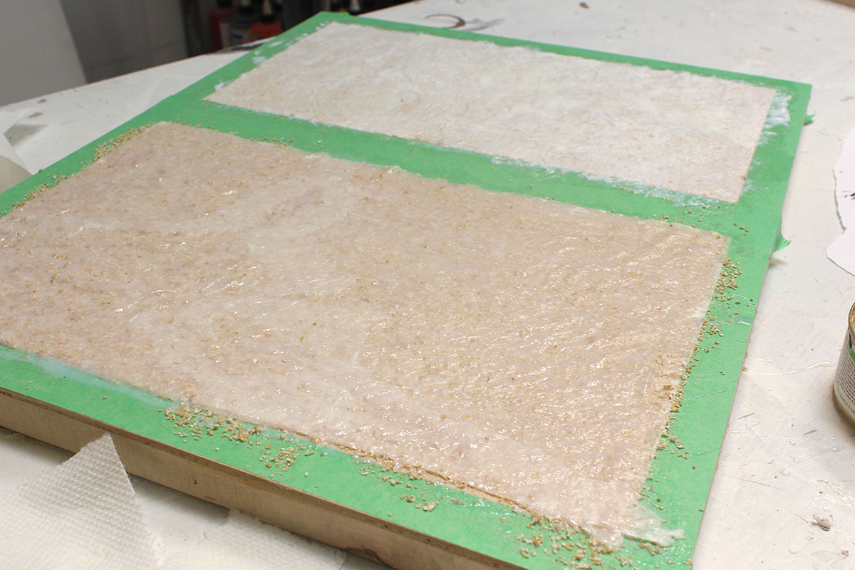

Using quilted paper towel and artist's regular clear acrylic medium, I'm going to collage torn paper towel pieces onto the oat surface.  If I can brush medium directly onto the oats, I will do that first, then apply the towel and brush more on top of that. If the oat bits are crumbling off too much for brushing them directly, I brush it onto the towel first, press it onto the oats, then brush more medium on top.  If you coat your oats with clear medium first, it makes things more fixed and will allow for easy collaging.  For the edges of the sea and around a ship, I'd use the straight edge of the towel.  For internal pieces, I make sure that they are round and torn in nature.  It doesn't matter if they over-lap.  RECENTLY, I HAVE TAKEN TO SIMPLY GLUING DOWN ONE SINGLE PIECE OF PAPER TOWEL WITH AEROSOL CONTACT CEMENT APPLIED TO BOTH SURFACES.  WAY EASIER AND NEATER
Here, the oats are completely covered with paper towel and have been covered with acrylic medium.  IT IS VERY IMPORTANT TO AVOID WRINKLES OR CREASES WHEN APPLYING THE PAPER TOWEL!  This doesn't look real and gives away the trick.  I have made sure to fully fill and cover the edges.

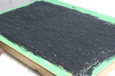

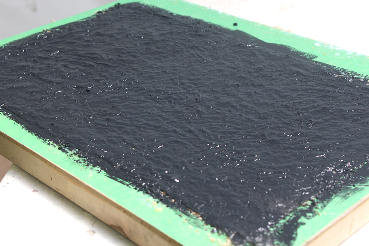

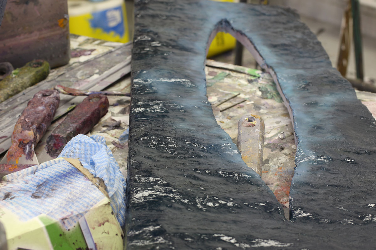

Once dry, I have now painted the water colour on and top-coated it with HIGH gloss acrylic varnish.  I love this stuff as it's nearly as shiny as epoxy. If you feel that the ripples are still too lumpy or detailed, you can add more layers of paper towel at this point.   In real life, this water looks very convincing and real.  There's no sense there were oats underneath.  I now finish all my CA-oat seas this way.

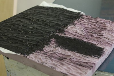

Here I have used a dremel tool and a steel brush bit to create a wave texture.  I used spray adhesive and covered it with one single coating of paper towel.  Right is the raw carved foam, left is the paper towel coating with paint.

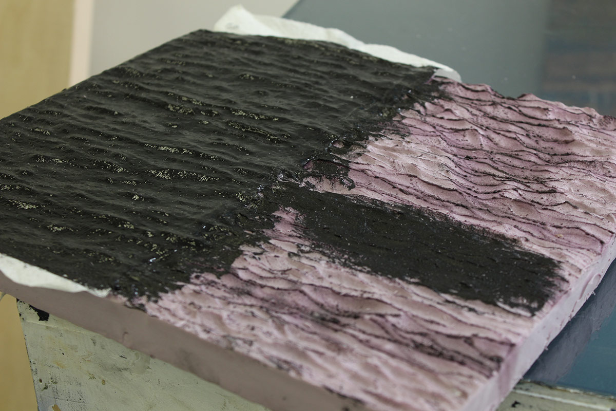

Dremel carved foam covered with one piece of paper towel with spray adhesive
Foam that has been lightly melted with a lighter above my head, then covered with a single sheet of paper towel and spray adhesive.

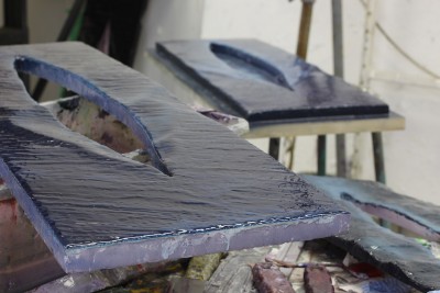

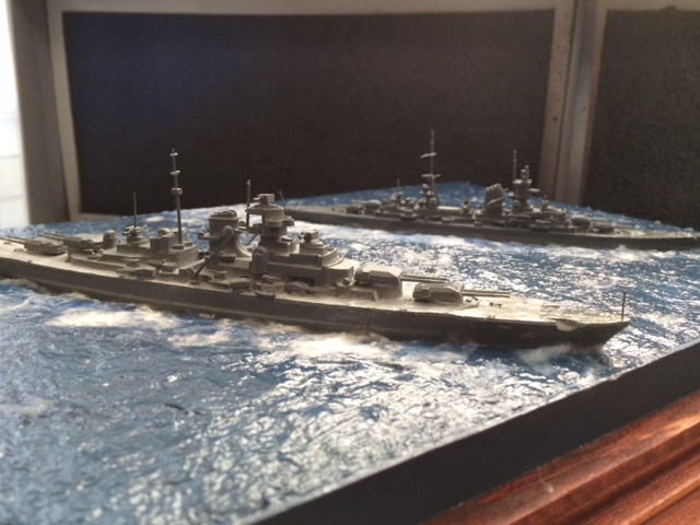

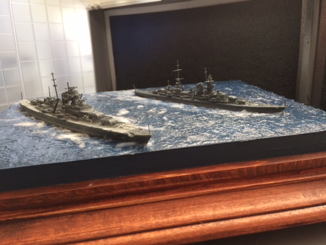

I used to build the ocean around my ship. But now, I'm big on cutting a perfect hole first, making the sea, then putting my ship in. Often, any cracks can be simply stuffed with cotton to hide them. A larger gap could be resolved by bridging that are with a bit of paper and painting it. Or you could just cut a new hole and sea.
I like the idea of painting the sea without the hassle of having a ship in it.
these pictures show my seas before a ship is in. None have received any cotton. I do the cotton work before the ship goes in.
