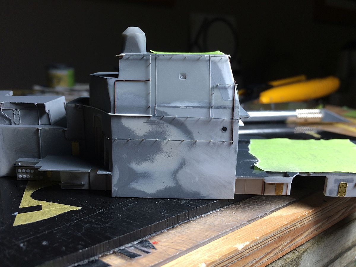

Alright! Here is the reason why I haven't posted anything in a while: I was busy trying to represent all those pipes and sprinklers on the superstructure. It was painful, and it's not even as nice as it could be, but I do want to finish this ship in this lifetime. ( and a few others) I do like the results, but it could always be better.
A lot of the details still can't be installed until the superstructure is secured to the hull, so there is a lot more plumbing coming!
I used different gauges of wire, and trimmed down railings to make the piping.
I also started masking, that's gonna take a lot of time too. But once it's all sprayed grey, I can finally start adding a lot of cool stuff!
Cheers: Laci

Finally, some more progress. Not much though. This is a tough ship to model correctly. And this goes for the whole class of course.
I painted the superstructure. After that I thought it's just piling the fun bits on, but no. The White Ensign photo etch set is horribly inaccurate in a lot of ways. The right decals are also hard to find. Either the quality or the content leaves much to be desired...
Some decals will be going on soon though.
I am focusing on the forward section of the starboard for now. I did add some fun stuff. Like that platform extending from the bridge level. It turned out that the "floor" here is NOT perforated, but a solid plate. Something to cover up later.... :doh_1:
Not much to say for now, hopefully the pictures tell more...
