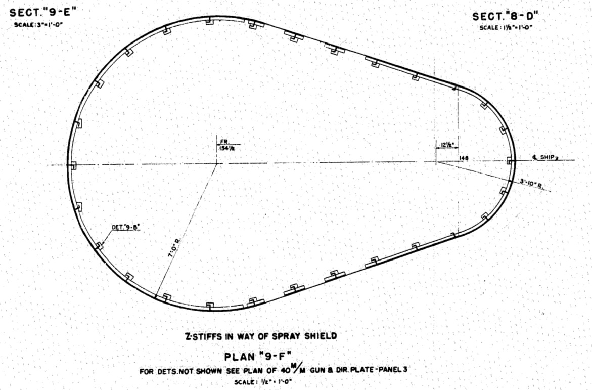

The first image shows the general arrangement ... The "Teardrop" shape that surounds the twin 40-mm mount and director pedestal
The second through fourth image shows the construction details for the aft deckhouse and the bulwarks around the 40-mm mount and director first installed on the Round-Bridge FLETCHERS
The fifth and sixth images show much the same design, except with refinements for the Square-Bridge FLETCHERS, particularly changes to the director pedestal
You would actually only need to make the "Tub" (I think with a thin bottom is best) and director pedestal that can be mounted on the small aft deckhouse, since most kits already have the deckhouse.

Anyway, here's a VERY rough draft. I'm not sure its printable given the thinness of the splinter shielding. Any ideas on the dimensions? When I open the one image I was able to save, it comes out all blurry at very low resolution so I can't tell the dimension callouts.

It looks like something really ugly happened in the "Take a Screen Shot" from the Bath Iron Works FLETCHER Class Engineering Drawings DVD to uploading on Photobucket to then uploading to Modelwarships ... all the dimensions went "BLUR".
I'm trying loading a small image direct. But here are the dimensions; the big radius is 7-ft (standard working circle for twin 40-mm guns was 14-ft) centered at Frame 154.5, the minor radius is 3-ft, 10-in, centered 10.5-in aft of Frame 148. Height of Bulwark is shown as 3-ft, 3-in. On FLETCHERS, the Frame spacing is 21-in.
If it helps any in "thickness", notice the stiffeners and there would be clips for ready-use ammo.
Attached are some "typical" views of the aft twin 40-mm gun mount "tub". Almost all FLETCHERS after the first dozen or so units delivered had this lowered tub with this "tear-drop" shape. The "D-shape" tub was a MINY refinement. Many of the FLETCHERS that they worked on had their tubs altered to this style. It wasn't made as a "standard", but because many of the really good yard views of FLETCHERS were taken at MINY, I think many "assume" that the D-shape was typical. However, most FLETCHERS retained the Tear-Drop shape and as I said were completed with it.
Typical views of FLETCHERS with the Tear-Drop "Tub"
As a reference, a close-up view of a D-Shaped MINY "Tub"
Below is a better drawing with dimensions visible and a close-up view of a Post-WWII FLETCHER with a Tear-Drop "Tub" showing the typical Ready-Use ammo clip stowage along the inside of the bulwark wall. Also, all these views give you an idea that the Director Platform and Pedestal varied a lot during the war. The Mk 49 director was the intended director for the 40-mm guns, but Mk-51 directors ended up being the standard.

There is a short "bulwark" around the edge of the deckhouse, where the tub doesn't overhang the small deckhouse, of about a foot in height. I don't know what the intent was for the space enclosed that way, but on quite a few FLETCHERS it was used for floater nets or stowage for other things like canvas covers. You will note that the ladder providing access to the "40-mm gun mount and "tub" goes up to that space and then rails are mounted on the bulwark around the gun to get over the "wall". I have seen some destroyers where the crew cut an opening in the bulwark where the ladder is located. Not authorized, but handy.
If you make a tub, I wouldn't worry about trying to make that short bulwark wall, unless you decide to do the complete aft deckhouse and "gun tub" together.

Here's another rough draft of the tear drop tub scaled to 1/350th (I think). The tub is about 21mm long fore to aft. Before I take this any further, would anyone care to check the size and scaling before I lock things down and start adding the little details?
Thanks!
Bob

PS. The splinter shielding is 0.3 mm and Shapeways says its printable! Wow, I wouldn't have expected that, and the stiffeners and such will hopefully add to its printability.
The tub is also about 13.6 mm in diameter at the widest point of the after circle.

The Sims conversion or the Fletcher gun tub? Both are yes. I just need someone to doublecheck my dimensions on the gun tub before I go any further. I started adding internal supports and reinforcements to match photos as best I could, but then figured that would be a waste of time if the scaling was all wrong and I had to start all over again.

The tub(s) will be for the Tamiya Fletcher, so its in 1/350th, I hope. I hope I got the dimensions and scaling correct. I took the plans supplied by Mr. Davis, drew the tub, converted to 1-1 scale, then took it down to 1/350th; lots of scaling issues, lots of potential for error.

Bob,
There are two considerations about sizing a Tear-Drop Shaped "tub" for FLETCHER kits. What the actual dimensions were on REAL ships and how true to scale are the kit manufacture's, in this case to the mating parts. Photo Etch makers have had to deal with the kits as they are, not as they SHOULD BE.
With that in mind I have attached a cropped view of the Aft 40-mm Tub on the small deckhouse on the 01 level aft deckhouse to illustrate how it mates.
The deckhouse was built to be roughly 16-ft wide, 8-ft off-centerline. The "standard" tub didn't reach the full width of the sides. The Mare Island "D-Shape" tub followed the outside shape (walls) of the small deckhouse.
How then I'm "old-fashion" and use to dealing in "Feet and Inches" which works well with the original plans, than Metric. When I convert your widest diameter of the tub of 13.6-mm, to inches/feet from 1/350 scale I come up with 0.535-in which equals 15.62-ft. (assuming 25.4-mm to 1-inch). The
official" dimension to the "Outside" of the bulwark was a 7-ft radius which means that the actual max width should be 14-ft, which if I have done my calculations right should be 12.2-mm. My calculations could be off, but check yours also. Even if the 7-ft radius is a to the "inside" of the bulwark dimension, the wall thickness shouldn't be that thick.
The stiffeners for the bulwark are spaced according to the original drawings at "about 2-ft, 1.5-in" apart and are 3-in deep from the bulwark wall The ready-use clip holders, two of them in two rows, fit between these stiffeners. See the below images.
How then to the "what size" did the 1/350 scale FLETCHER Class Kit Makers, Tamiya and Trumpeter, make the deckhouse question. I got out my calipers and measured the deckhouses that these "Tear-Drop" tubs would fit on and they are both pretty close to true scale, being about 16.5-ft wide.
The Images I added at the bottom show; (a) a typical Tear-Drop shaped tub with the canvas covers over the ready-use clip holders, (b) a typical Tear-Drop tub without the canvas cover, (c) just for reference a D-Shaped Tub showing the clip holder arrangement was about the same. A 40-mm round clip would fit into each of these clip holders. I tried to locate a drawing of the clip holders, but can't find one. However the last image shows a couple of these holders with four 40-mm rounds in them.

Awesome. Seriously, what we do without you? I say that with all seriousness and respect.
I may not be able to do empty ready service clips. Printing abilities just aren't there jet. It may be possible to do a clip with 40mm rounds in it which could then be booleaned or merged into the inner splinter shielding. I'm not sure if the human eye would be able to tell what it was meant to represent at this scale, but its worth a try to see if its printable.
For the tear dropped tub, is there a consensus on whether or not it should have a hole in it to mount the 40mm Bofors? Or, just leave it off and let the modeler center and attach the gun mount manually? The tub's deck is currently 0.4 mm thin, so I'm reluctant to start poking holes in it; the deck there is so thin that there wouldn't be much for the glue to find purchase, anyway. The modeler might be better off attaching the tub, letting the glue dry, and then drilling a mounting hole themselves through the tub and deckhouse.
I'll break the Tamiya Fletcher out of the closet and match the blueprint to the after deckhouse tonight and test it out.
