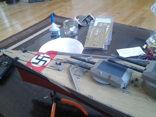

Got some detailing done on the front deck
