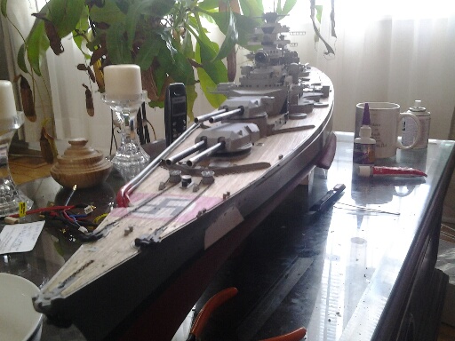

PostPosted: Sat Dec 19, 2015 10:41 am
Joined: Sat Nov 21, 2015 9:54 pm
Posts: 55
Location: Nova Scotia, Canada
Got some detailing done on the front deck
Start out slow, then taper off....
