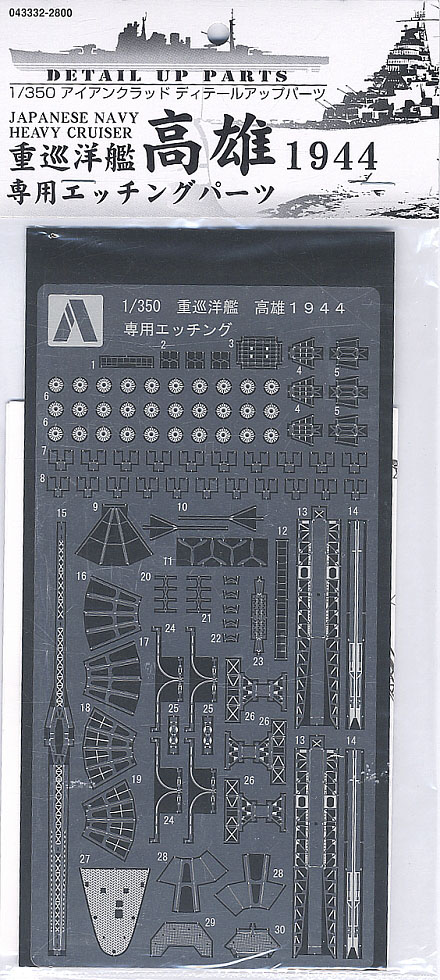

Hi Guys!
Some guidance please?
I was given a P.E set for my 1/350 Takao for Xmas, but I have the 1942 kit & the etch is for the 1944 fit...
How much, if any of it, can i use?
The kit came with a broken crane, so i'm kinda stuck with the etch version, but what else is viable?

Assuming you are referring to the first photo below, then it looks like that all but the radars should be viable. There are plenty of comprehensive PE sets out there. I did just notice that Aoshima has issued a more comprehensive PE set for the class as a retake. Sorta looks a bit like the GMM or WEM PE. Second photo.

HOLY CRAP!!!! :big_eyes:
Yeah, I have the 1st one. Good to know it's not wasted! But that 2nd set looks a bit busy!

Errrr.... What are the round things? The pt 6 bits?
If it's any consolation: This will help others less knowledgeable than myself! ( & there are very few...)
Posts: 12489
Bases for the 25mm single guns, I believe, as so: http://www.bnamodelworld.com/bmz_cache/ ... 20x520.jpg
Posts: 9117
Post by Dan K »
Yes, along with shields #s 7 & 8. Not for use on a '42.
