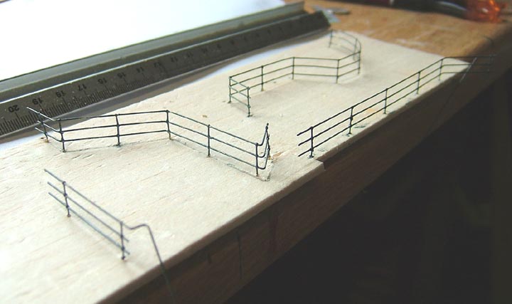

Hi Guys, A small up date, on handrails.
I continue with the handrails, this section is for forward main deck under the out slung lifeboat. I made my template and marked it on balsa wood. The next section with the very sharp angle is for the next level up, near the same position. 4 different sections built. 4 Sections painted and ready for fitting. Looking from the stern. Looking from the bow. enjoy, ARH

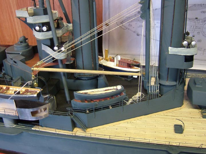

Hi Guys, I have been busy today, handrails, cleats, davits and hatches.
The edge rail was drilled, spacing between rails 300 cm. Stanchions super glued in position. All rails fitted and glued, note the flag staff fitted to the stern, this is made of copper tube, with a piece of .032 brass rod fitted down the middle and a spot of PVA glue on the top. Again more handrails, this section shows how to break the rails with a gangway opening, at this point there needs to be bracing stanchions either side. I make them larger, when set they get cut to size. These are the gangway davits, they are made out of 3 different sizes of brass and copper tube, one inside the other, the top one bent to shape, note the chain where the opening is, also the little cleats in the middle and to one side of the davits. I have fitted 10 cleats on the model today. Midships and everything is painted. An overall view of the model, showing work today, the model is about 85% complete, radio control will be later. enjoy, ARH

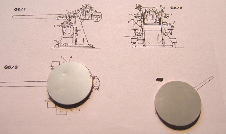

- Posts: 2557
Hi Guys, I have been busy today, just a small up date on one item.
On the rear superstructure are two 3lb guns. I copied the small drawing from one of my books and scaled it to 1/96.
The first thing I did was to cut out the 2 base's and thickened them with a small coin. Next I marked out the base and sides of the pedestal that holds the gun. Two were cut out and drilled. The base was folded using a piece of timber the correct width. These were then glued to the round base and the side strengtheners glued in place. I also made the gun barrels out of 1 brass rod and 1 aluminium rod with the ends flared slightly. Next I cut out the breach from some lime wood and drilled a hole though it. I assembled the gun to the base using a pin as the pivoting point. Under the gun I put in more plates for strength, then I cut 2 angled pieces, drilled and glued them in position. These act as shock absorbers. A few control wheels have been added. The brass small pieces are dampeners. Here it is painted and placed in position. I might add a few more things tomorrow when I am finishing the second one. enjoy, ARH

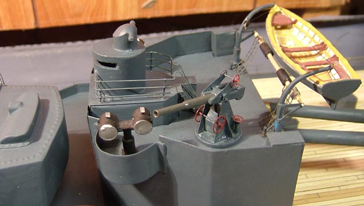

Hi Guys, Here's the last few pictures of the 2 guns build.
The second gun is assembled, I have added 2 seats to each gun, 1 either side. One gun painted, one to finish, the lighter colour is the seat. Both placed in position, note the rear spotting position and the handrails are also fitted. A long shot of mid ships, both guns are painted and placed in position/ You can view a very large picture of ID in picture post, it gives you a good view of the whole ship and the amount of fittings I have built. enjoy, ARH

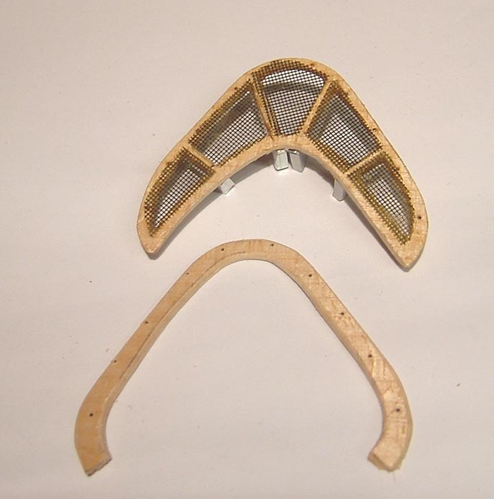

Hi Guys, I have been busy today, working on the Poop Deck.
First I cut a template of cardboard to fit the stern. Then I transferred the shape to my lime wood. I cut out the timber shape and marked out the sections to be cut out, then I drilled each corner. Four underneath metal braces made from litho plate and glued in position. The handrail and deck cut out. They are the same size, just an optical illusion. Mesh fitted to deck section. The deck and handrail drilled. Roof section cut out. All 3 ready for fitting. Deck glued in place. 10 stanchions cut and bent to shape. Handrail and stanchions glued in position. As you can see I'm quite liberal with the glue, this section has to be strong, other wise
Roof glued in place and strengtheners.
Balustrade fitted and everything painted.
All this work took 4 hours
enjoy, ARH
