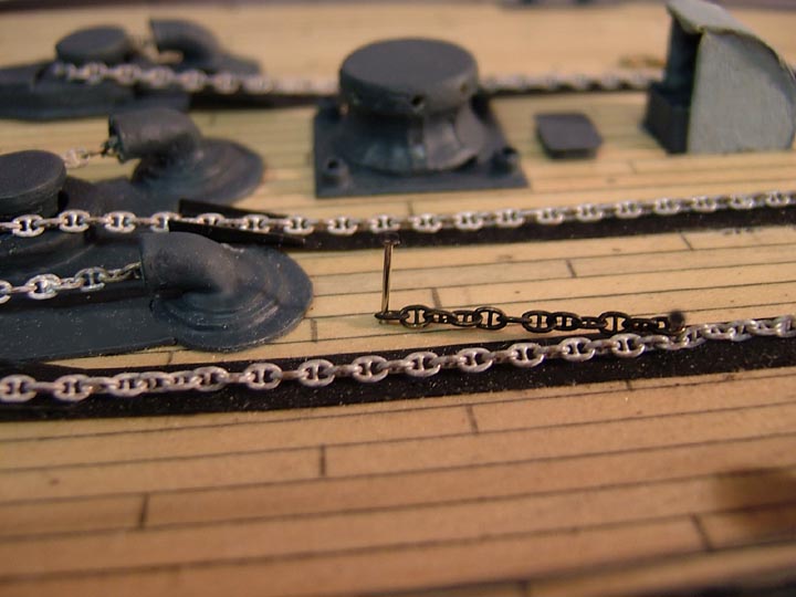

Out of my 2mm lime wood I cut out and drilled the capstan base plate then fit in to position.
This is the capstan, it's made by BILLINGS, but needs to be altered.
It is turned over and filed flat on the bottom, then filed with a round on the top. Two complete one to do.
All placed in position.
You can see the chain I am using, correct and to scale size.

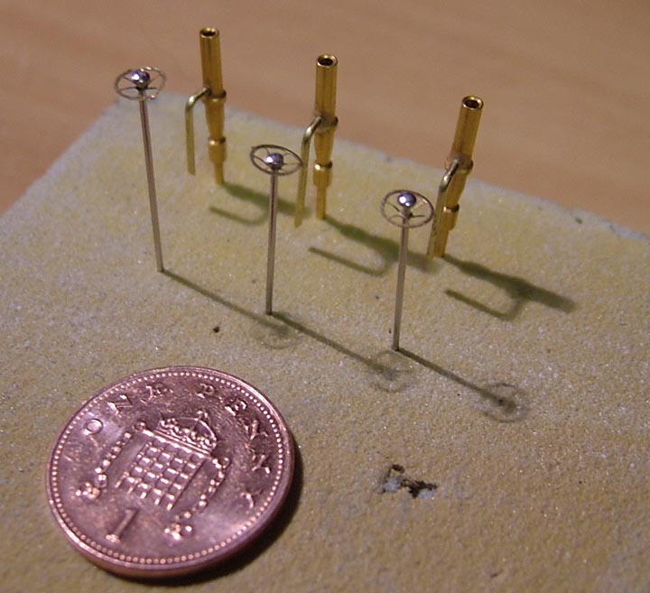

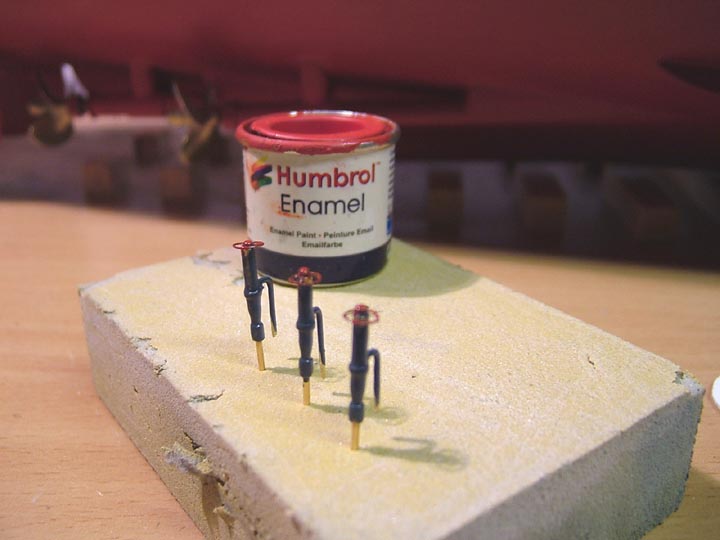

I am making the steam control valve. This is an electrical connector that is ideal for the job. It has a hole in the top and a hole in the side, very strange. The hole in the side was in exactly the right place :jump_1: :jump_1: .
I bent a piece of brass wire at 90 degrees, cut it to size and glued in place. Then I got a pin and put it though one of my hand wheels and glued in place.
All 3 done and painted.

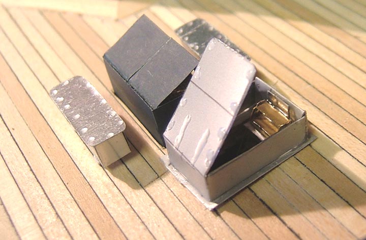

Hi Guys, I am going to do a hatch that has a ladder down in to the hull.

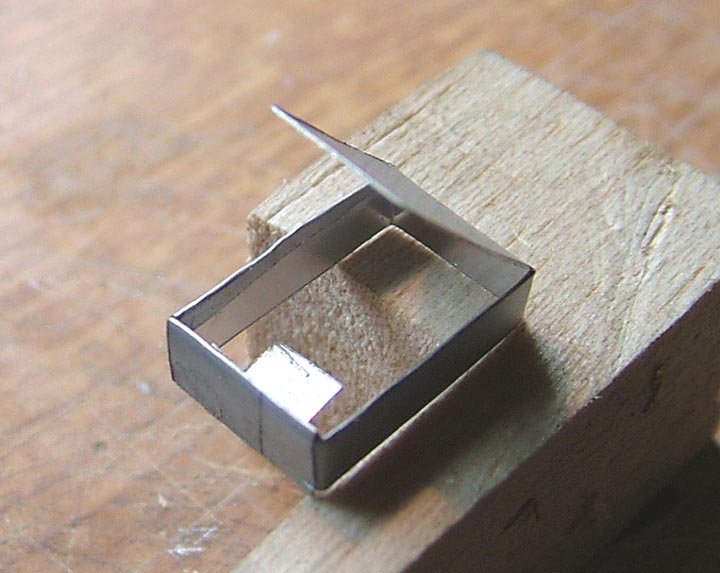

First I mark out the litho plate. Then I cut out the shape and fold over the litho to thicken the hatch for more strength.

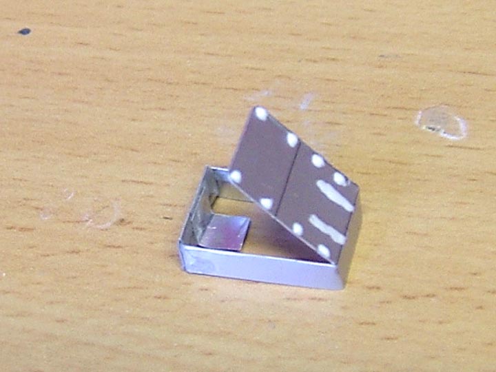

The hatch glued and shaped, the hatch lid raised at 45 deg.
A few crude markings put on the lid, these will be trimmed when set.
A hole cut in the deck to take the ladder, also two storage lockers placed in position.
Viewed from a different angle.
Here you can see the ladder going down in to the ship.
Hatch placed in position and storage lockers painted. Note the new ladders on the gun turret how they come over the top and on to the roof.
enjoy.ARH :wave_1: :wave_1: :thumbs_up_1:

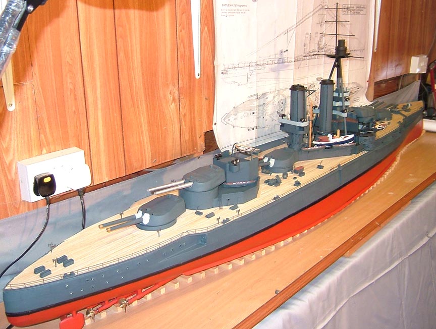

Hi Guys, Here's a few photo's that I took before yesterdays up date, its the overall ship and a few close ups.
Bow shot.
Stern shot.
A shot of the 3 rear turrets.
Bow and superstructure.
A close up of midships.
Close up of the two rear turrets, one still to have its blast bags fitted.
A close up of all the small fittings around the Marine turret.
enjoy, ARH :wave_1: :wave_1: :thumbs_up_1:

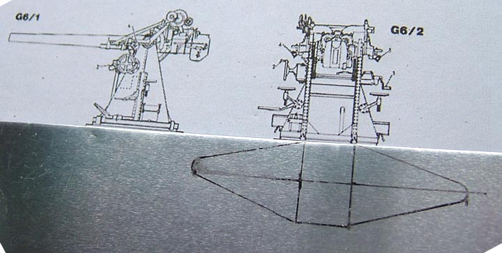

On the rear superstructure are two 3lb guns. I copied the small drawing from one of my books and scaled it to 1/96.
The first thing I did was to cut out the 2 base's and thickened them with a small coin.
Next I marked out the base and sides of the pedestal that holds the gun.
Two were cut out and drilled.

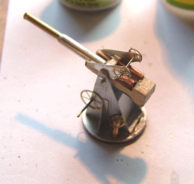

The base was folded using a piece of timber the correct width.
These were then glued to the round base and the side strengtheners glued in place. I also made the gun barrels out of 1 brass rod and 1 aluminium rod with the ends flared slightly.
Next I cut out the breach from some lime wood and drilled a hole though it.
I assembled the gun to the base using a pin as the pivoting point. Under the gun I put in more plates for strength, then I cut 2 angled pieces, drilled and glued them in position. These act as shock absorbers.
A few control wheels have been added. The brass small pieces are dampeners.

Hi Guys, Here's the last few pictures of the 2 guns build.
The second gun is assembled, I have added 2 seats to each gun, 1 either side. One gun painted, one to finish, the lighter colour is the seat.
Both placed in position, note the rear spotting position and the handrails are also fitted.
A long shot of mid ships, both guns are painted and placed in position/ You can view a very large picture of ID in picture post, it gives you a good view of the whole ship and the amount of fittings I have built.
