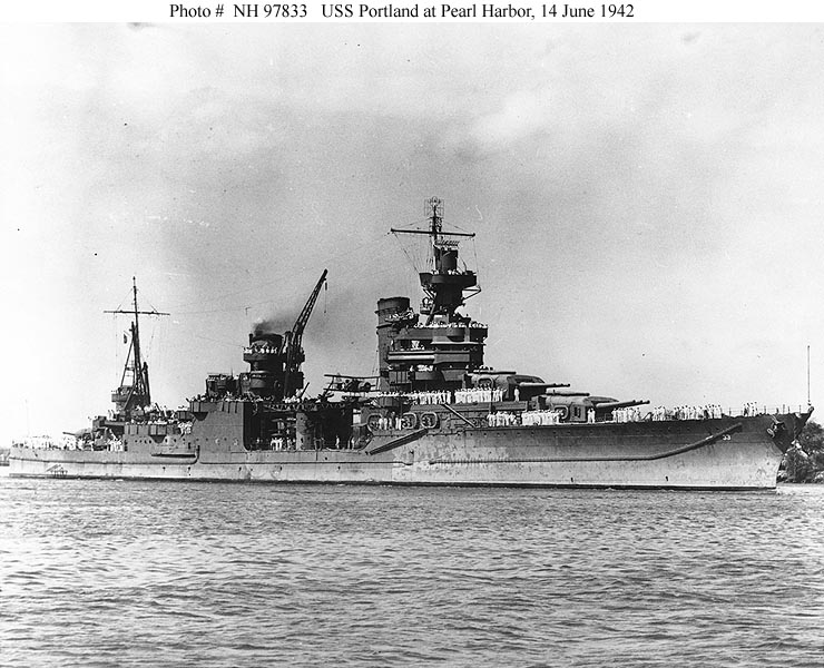

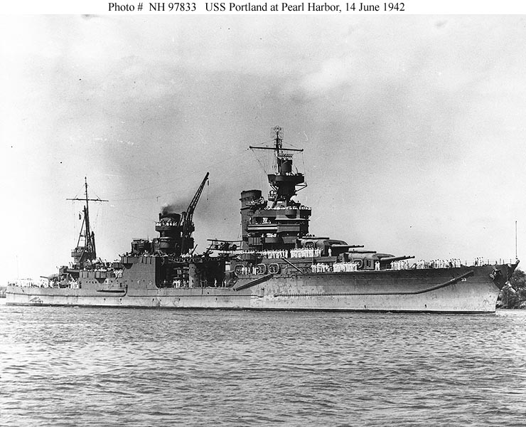

Here are a couple of images for reference of USS PORTLAND (CA-33) in early 1942. First one is a view of PORTLAND at MINY in the background of a photo for another ship dated 15 February 1942 (interesting that there aren't any photos from her MINY visit on Navsource, but it may have been only a short visit/repair). The second image is the same one posted earlier, but this one will be at a higher-res.

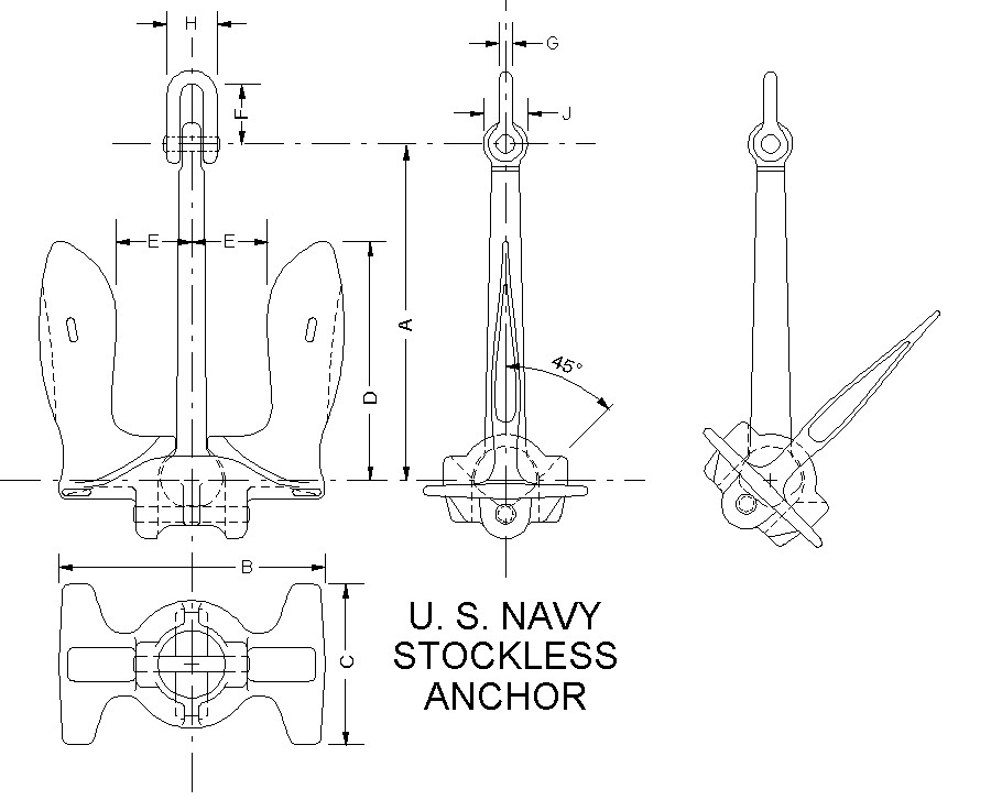

For reference the Clevelands had 13,000 pound Navy stockless bower anchors (Navy versions are slightly different from some commercial versions).
The Portland class and Cleveland class had the same displacement - 10,000 tons - so they may have used the same anchors.
The anchors may not have been exactly the same on similar ships, or both anchors may not have been the same on a given ship. While modeling the USS Oklahoma City CLG-5 I noticed that the two anchors were slightly different. I thought that was odd. Then while reading through the ship's histories I found that CL-91 had lost the starboard anchor and 25 fathoms of chain in the Delaware Bay in April 1945 on the first post-shakedown cruise. The Philadelphia Navy Yard sent a new one out on a barge.
Here is a drawing of a Navy stockless anchor. This is the type used on the Clevelands. For the 13,000 pound anchor:
A = 100"
B = 77-3/8"
C = 46-5/8"
D = 71-1/16"
E = 22"
F = 18-3/8"
G = 3-15/16"
H = 14-1/8"
J = 12-5/16"
The Floating Drydock has an excellent set of 22500 pound anchor drawings showing all dimensions and fluke cross sections, with a table of dimensions for all sizes of Navy anchors. It was done by a friend of mine, Alexy Burdin (his beautiful CAD model of the USS Slater DE-766 is what inspired me to put insane amounts of detail into my CAD model of the USS Oklahoma City CLG-5).

Brilliant, Phil!
I'll offer 13,000 lb. anchors, specified for Clevelands, and let the modeler decide if it is appropriate for their cruiser builds.
Your CAD design is "wicked cool".

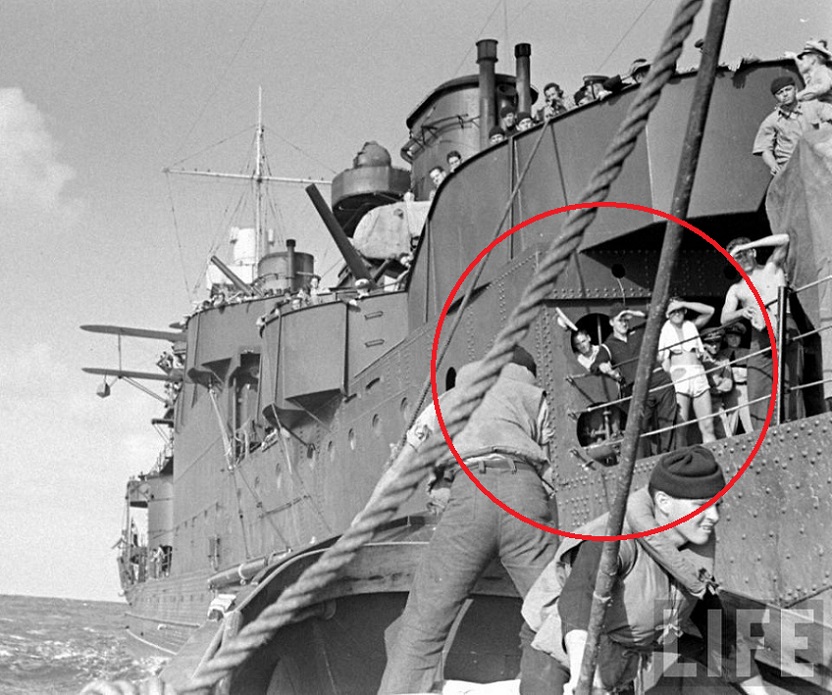

Steve, Really looking forward to your build! Best wishes to you on a challenging conversion project!Steve wrote:As part of my planning for the Tamiya conversion (posted above) I have been unable to determine the extent of an aft cross deck bulkhead below of the aft 5" gun deck. There are no posted photos of this area that I have found nor does the MM part include a bulkhead. I suspect there is a limited but open area on both sides of the aft tower structure to allow access to facilities and storage below the 5" gun deck. Any help will be appreciated.
Yes, your suspicion is correct, that deck is open under the AA deck for quite a distance.
You can see just how far forward in this pre-war photo taken before plating was added to cover the large opening in the shell (hull). Compare the position of the mostly hidden transverse bulkhead in question with the position of the 5"/25 guns above. By 1942, plating containing four portholes had been added covering the large opening but the small openings remain. The new plating's portholes appear to standard 12" diameter "airports". The original shell portholes forward of the new plating appear to be 16". And some other photos that may help. Note that there is a perforated plate at the outer edge.
