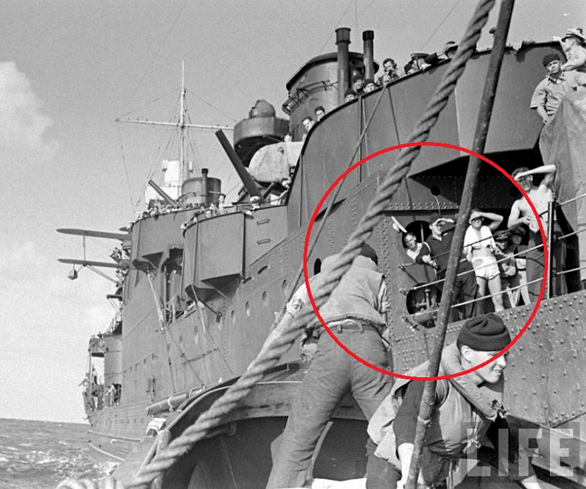

As part of my planning for the Tamiya conversion (posted above) I have been unable to determine the extent of an aft cross deck bulkhead below of the aft 5" gun deck. There are no posted photos of this area that I have found nor does the MM part include a bulkhead. I suspect there is a limited but open area on both sides of the aft tower structure to allow access to facilities and storage below the 5" gun deck. Any help will be appreciated.
Steve, Really looking forward to your build! Best wishes to you on a challenging conversion project!
Yes, your suspicion is correct, that deck is open
under the AA deck for quite a distance.
You can see just how far forward in this pre-war photo taken before plating was added to cover the large opening in the shell (hull). Compare the position of the mostly hidden transverse bulkhead in question with the position of the 5"/25 guns above. By 1942, plating containing four portholes had been added covering the large opening but the small openings remain. The new plating's portholes appear to standard 12" diameter "airports". The original shell portholes forward of the new plating appear to be 16".

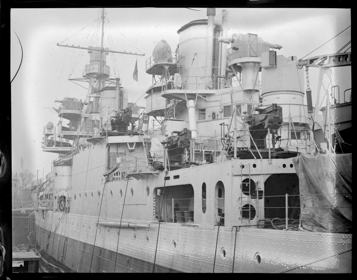

And some other photos that may help. Note that there is a perforated plate at the outer edge.
