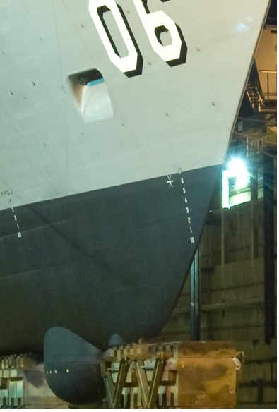

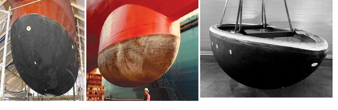

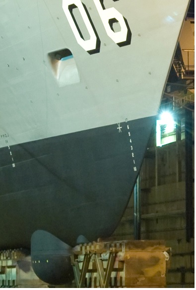

As the Academy kit has been mentioned a number of times, of note the omissions and inaccuracies, there is one other point which has not been brought up, important for those planning to embark on this project if you wish to get it right.
The keel sonar dome is incorrect, it is ridiculously narrow, no one seems to be able to get this right, in drawings or models.
The AN-SQS 56 sonar fitted to a FFG is mounted within a rubber composite blister which is filled with water to maintain shape, on Australian FFG`s there is also a much smaller extension protruding from the keel, forward of the dome, which I suspect is to do with the sonar arrangement, and probably fitted to other FFG`s in other navies, also omitted.
After many years of resin I am having a go in plastic with the Academy FFG, so far have only got as far as the hull which seems to be correct/or close to in dimensions and lines.
The dome is in the correct location, as are the masker emitters and prop shaft, they also got it right with 2 strengthening ribs ( particular for my planned build) but not the sonar dome shape, or the emitters going right round the keel, the bilge keel is totally incorrect, as mentioned earlier, and the stabilizer fins are missing.
Haven`t had a good look yet, but someone mentioned earlier that the duck tail has also been omitted.
Here is a sequence of what the dome should look like, and also a small shot of HMAS Newcastle in dry dock, showing the extra extension forward of the dome.

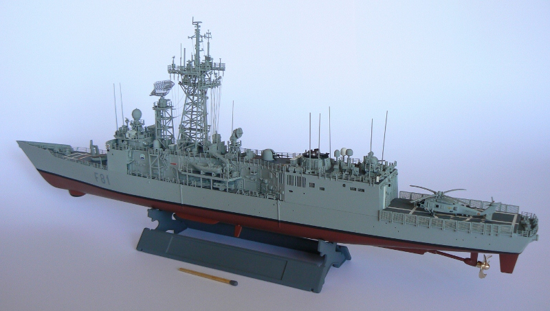

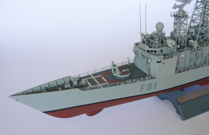

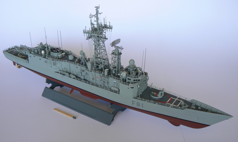

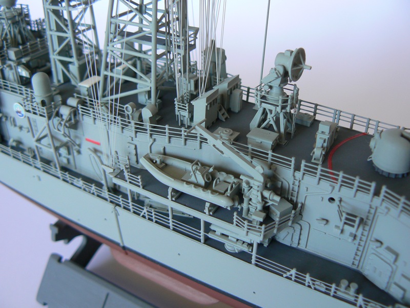

Hi to all of you, folks:
I have realized that after finishing my FFG Santa Mar�a, I simply forgot to post some views of the final product. :bash_2: Maybe I am getting old.
So here you are some pics.
Port side :

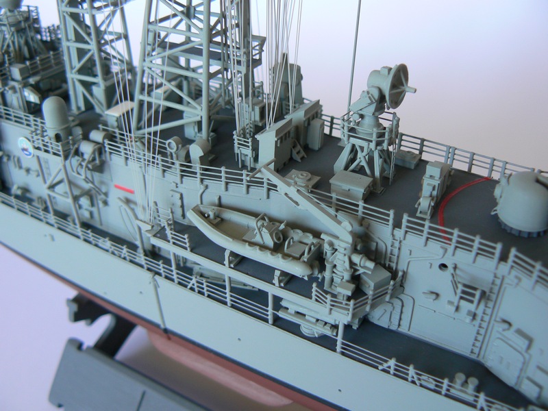

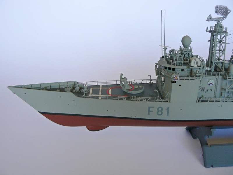

And some closer details. Bridge and flying bridge :
And midships :
I will post some more in the next message. I hope you like them.
Willie.[/size]

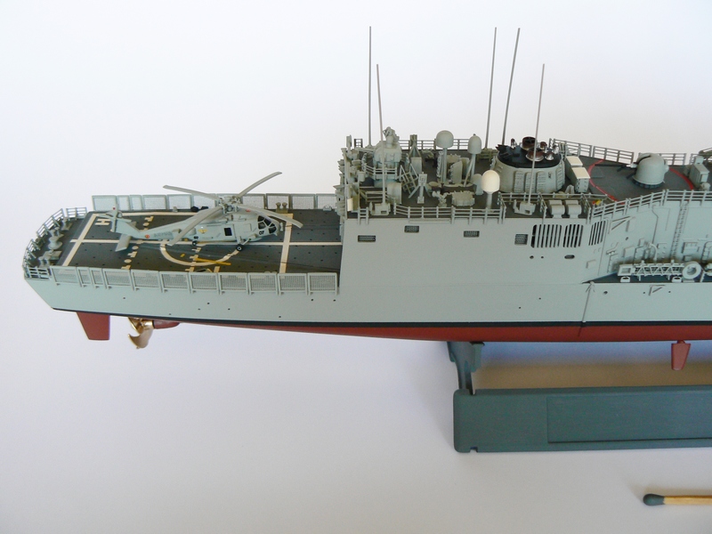

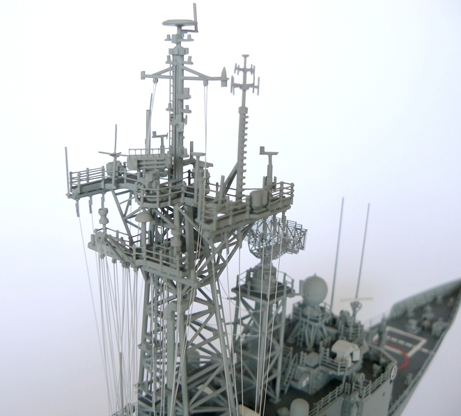

And hi again.
As I said, some more views. Starboard side :
Masts and aerials :
Stbd. structure details :
And flight deck :
And well, I think that�s all.
I hope you have liked it, and very best regards from this side of the Atlantic,
Willie.[/size]

Your craftsmanship is superb! Thank you for sharing the final pictures.
I served on the staff of NATO's STANAVFORLANT (old name) and have a tie clasp from the Frigata Santa Maria which I wear often.
