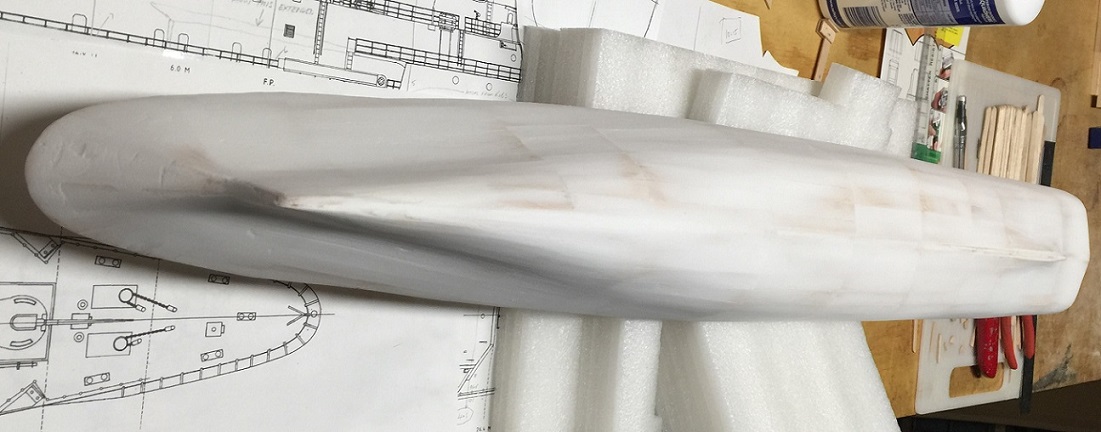

I used a rapid spak-filler on the hull to give it a smooth finish. Big mistake!! :Mad_6:
After painting then sanding, then filling again and sanding and painting again, I’ve either made a mistake using spak-filler, or I’m not proficient enough with it. I can still see cracks along the stick joins and pock marks from bubbles in the spak-filler and it’s too soft. Also, I was surprised to see beads of paint stick to the 400 grit sand paper, which seemed to make more scratches. It’s hard to see what I mean from these photos but the hull needs more work.

I've re-worked the hull with wood filler and lots of sanding, than fill again and sanding, what a workout, I've got sore arms! :dead:
Hi Bob Carr, I looked into the auto body filler but was reluctant to use it because I was unsure of adding hardener to it, instead I found a wood filler which turned out to be quite hard as well, you can see by the sanding that I exposed a lot of high spots. These were where the ribs are, which means next time I should probably make more ribs to avoid any sagging between the ribs. It seems odd that the popsicle sticks had lower points between the ribs... Also next time I'll have to try the auto filler to see how it works. One thing with the wood filler though, I could add water to it and make it as thick or runny as I liked. For little touch ups, I just thinned it out (to like glue) and painted it on over little scratches, and it worked well.
I also closed in the stern windows, as per the ASMD upgrade.

Hi All,
I've finished the propeller shafts and attached them to the hull. I've also added the anchors, ASW sonar, rudder and stabilizers:
HMAS Anzac's anchor bays are different to the other 7 Anzac class frigates for some reason...
I painted the propeller shafts because I wasn't sure how easy it would be to paint them once attached.
