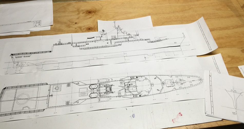

I was able to get some plans for the ANZAC FFH which unfortunately are before the ASMD upgrade.
I enlarged them enough to what I thought would be easy for working with popsicle sticks. So the ship will be 86.7cm (34”) long and if my maths is right it will be a 1/136 scale model. I discovered the plans are not very symmetrical, probably due to scaling. I’ve had to redraw some hull cross-sections to ensure the ribs will be symmetrical.

For the plans, you might want to look into some Australian national archives? I don't know if they will have these modern ships, though.
Aop
