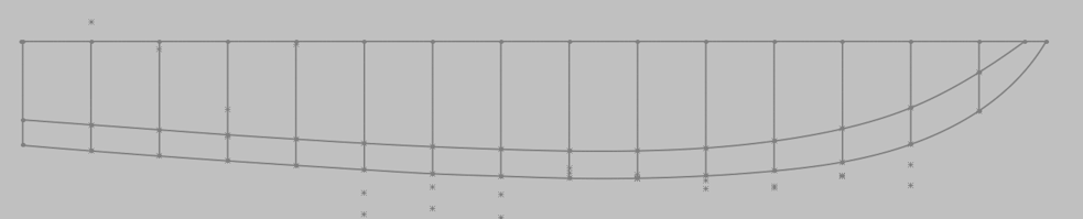

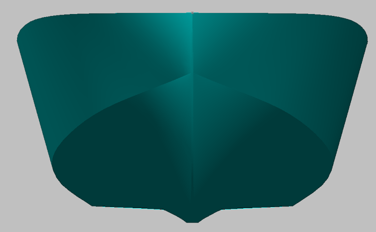

some screenshots

right now I am just trying to figure out the transom set up. I re lofted the hull as i was doing it backwards was why i had several different short lofts. then once i get the transom finished I need to see if I can find how the keel and frames were built

Ok got the transom set and the top deck so now I have a completed shell for all my stations. need to try and find info on how the keel was fabricated and that the station bulkheads looked like. I am guessing Higgins kept most of his boats very similar for cost control and efficiency. if that was the case it would be lamination of oak and mahogany for the bulkhead stations.
