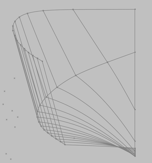

I finished downloading 643 odd images of PT Boat Microfilm and started working on the hull.
I will model it after PT 658 a late war Higgins 78' design because it was cool and loaded to the gills with cannons, rocket launchers, depth charges and the works.

right now I am just trying to figure out the transom set up. I re lofted the hull as i was doing it backwards was why i had several different short lofts. then once i get the transom finished I need to see if I can find how the keel and frames were built

Ok got the transom set and the top deck so now I have a completed shell for all my stations. need to try and find info on how the keel was fabricated and that the station bulkheads looked like. I am guessing Higgins kept most of his boats very similar for cost control and efficiency. if that was the case it would be lamination of oak and mahogany for the bulkhead stations.

Re: PT 658 Higgins 78' PT Boat
and here is the lines the table made. it says bottom wing but i dont have a clue what a wing is on a ship and dont see a top wing listed.
