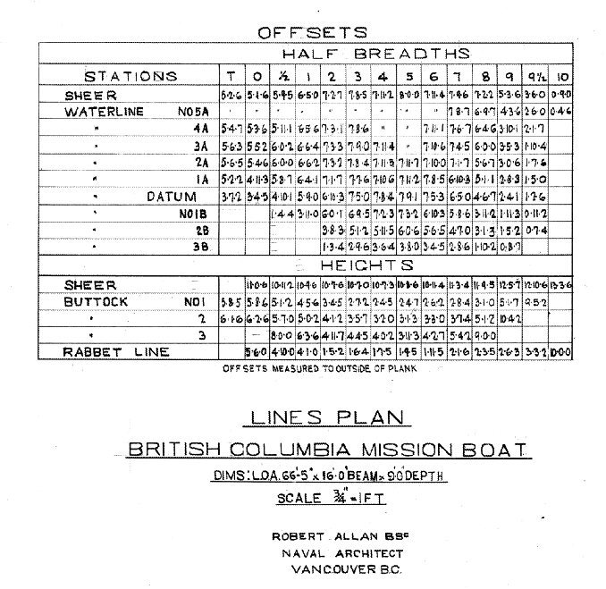

My Problem I am used to stations being on the left, waterlines on the top listed plainly as feet, and then the offsets
here they are listed differently and no matter what I do I cannot seem to get the correct sequence.
is there anyone that knows enough about offset tables to help me figure out the correct sequences of numbers for the tables

Just remember that somewhere in all those numbers there is elevation data, length along the keel data and hull width information.
The "Stations" are ALWAYS the length along some imaginary "Base Line," but always the length from bow to stern for US ships, and from stern to bow on European (French, German) drawings. I'm not sure what direction the Brits used - probably bow to stern to be different from the French.
The "Fore Peak" (FP) is ALWAYS near the bow (forward or fore) and the "Aft Peak" is always near the stern. These are the points on the normal load waterline where the fore and aft most parts of the hull cut the water.
So for the entire table the "Stations" are the length information. The catch here is the table doesn't say what the distances are between stations - you have to look at the profile or plan view drawings to find this distance. Station to Station spacing is not the same for all ships!
Normally the length along the load water line (between Fore and Aft Peaks) is divided into equal spaces called "Stations." So the distances between stations from Station 0 (usually the fore or Aft Peak) to the highest integer numbered stations are equal. However, sometimes fractional stations (1/4, 1/2, etc.) are given. The distances between these are 1/4, 1/2 or whatever the distance between integer numbered stations. You sometimes see fractional stations at the bow and stern where hull curvature is greatest.
"Waterlines" are ALWAYS horizontal planes that cut across the hull from port to starboard - perpendicular to the vertical. Think of them as the levels of water on the hull surface in a drydock as it is being flooded. They are elevations above the "Base line."
The "Base Line" can be anywhere - it doesn't matter. The elevations offsets from the "Base Line" tell the vertical position of the other numbers in the table. The "Base Line" may be the floor of a construction frame for boats, or it might be the top of one the keel plates on larger ships. It doesn't matter. All elevations are relative to one another so the actual "Base Line" is irrelevant. It should be shown on the profile drawings. Just use the Waterline elevations for your vertical coordinate for the points on the hull surface.
In the table you posted the "Half Breadths" portion (the top part) gives coordinates (distances from the center line) of points on the outside of the hull planking for distances along the length of the ship (Stations) and elevations (Waterlines).
If we let the length of the ship be on the X axis, the height on the Z axis and the width be on the Y axis, Stations are the X values (length), Waterlines are the Z values (vertical) and the Table of Half Breadths gives the Y values (horizontal) from the center line to the outside of the hull planking. The table defines only one side of the hull, the other side is a mirror image. That's why they are called "half-breadths."
NOTE: The text under the tables says "Offsets measured to outside of plank." This is common for small wooden boats. However, for larger steel hulled ships the half breadths are usually to the inside of the shell plating.
The "Heights" part of the table gives elevations at "Buttock Lines" (Butt Lines). These are vertical slices through the hull parallel to the center line at specified distances from the center line. Elevations along these Butt Lines are given for various positions along the length of the ship at the specified "Stations."
Again, the distances from the center line to the Butt Lines is not specified in the table. You have to get this information from the plan drawings. But all points in each Butt Line are the same distance from the center line.
The "Sheer" line is points along the top edge of the hull at each Station. The width offset from the center line varies with the curvature of the top edge of the hull, being at the center line for the fore and aft most Stations.
The "Rabbet Line" is where the planking in a wooden ship/boat meets the keel from bow to stern. It is typically half the keel width from the center line.
A "rabbet joint" is a cut or groove into one board that another board fits into. Historically, in wooden ships a notch was carved into the keel beam for the first plank (Garboard Strake) to fit into. This was the "Rabbet" or "Rabbet Line." This terminology goes back many centuries and is still used.
Finally, the numbers (such as 4-11-3) are feet-inches-eighths of an inch from the centerline outboard to the point on the hull. These are the distances (Y) at each Station (X) and each Waterline elevation (Z) from the centerline. So 4-11-3 is 4' 11-3/8".
Simple, isn't it?

I think I got them figured out. the stations are 6'-6" apart and a 1/2 distance between station 0 and 1 and 1/2 distance between station 9 and 10
Waterline 3B is 36" then each waterline above that is 1' between each
my problem was trying to organize them to be similar to the Fletcher which was easy to read here they mixed everything around. also the stations go backwards where 0 is the AP and 10 is the FP
I think I have the excel file rearranged will be testing it out shortly but still have to figure out the curve for the rabbet and the buttocks

well got the curves all in but man are they screwed up gonna take a while to adjust them
- DrPR
- Posts: 1693
Re: Need Help With Tables of Offsets
I have found two types of errors when working from the Table of Offsets. Most of the time I have typed in the wrong number - a 4 for a 5 and such. Occasionally I have found errors in the original table, and again they appear to be the substitution of one number for another. I guess most of the original numbers were calculated with a slide rule and every now and then the draftsman read the wrong number.
The result of these errors is a kink in the curves like you see in the picture you posted. But they are easily corrected because the error is always an increment of one foot, one inch or 1/8 inch.

yea I remember what you taught me on the fletcher. these offsets were almost all even numbers I need to take into account the rabbet location for the endings too. this is mainly a practice to keep figuring out these offset tables but this would be a nice radio control boat to do with my grandsons

well after work this afternoon i am starting over lol I cant seem to get this offset file to work dunno if reading wrong or what but i keep getting the wrong numbers for those 3 i need for each station

Ok so now i started all over and got my main cirves now I will play around with numbers trying to get the top and bottom of the curves finished up.
