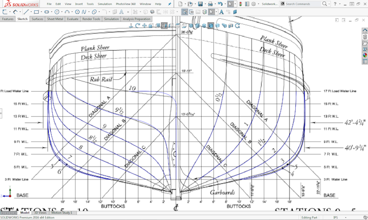

hey guys I finally came across some awesome drawings and the cool part is they have already been corrected of errors by the team that was going to restore one of the ships.
I am giving a link to all I have on the ship along with my excel sheet for the offsets and my curve files
here is my problem I got all the curves tested in solidworks and they indead have been fixed up however I am missing the info for a couple dimensions to enter into the curves for the stations to complete them.
I am missing the Half-Siding, the Deck Sheer and the Plank Sheer Dimensions to finish the curve files off properly

the station offsets are Great they work fine.
however there are 3 dimensions for each station I cannot find or figure out where to get from. so my stations are incomplete.
one dimension is called a half-siding, the other 2 are the deck sheer and the plank sheer. if i can figure out where to get those 3 dimensions from ill be all set to go and start lofting up the hull

Drawing 00010a.tiff table of offsets has the deck sheer, plank sheer and half siding dimensions. Deck sheer and plank sheer are also shown in the drawings.
Half siding is the distance from the center line to the forward edge of the shell plating, or the distance from the center line to the bearding line.
The bearding line is the line of intersection of the plating and the stem or stern post.

ok here are the dimensions
sheet 00006a i used for profile on the front plane and also for the stations on the right plane. I didnt cut the sheet I just used the wole sheet but the drawings are different scales thus the different szes.
for profile view:
Length: 3167.24720294in
Height: 2446.57474368in
For the Stations:
Length: 2111.33276274in
Height: 1630.92208528in
using those dimensions when you do the curve files in cad program with the offsets I have in the excel file they match up perfectly
PostPosted: Fri Dec 30, 2016 9:42 pm
Joined: Fri Nov 12, 2010 3:19 pm
Posts: 213
Location: Moline Illinois
as you can see here most of my curves are there just missing the top and bottoms thats where the sheer numbers etc go.
9 1/2 and 10 are off so I need to mess with them but the rest are spot on.
