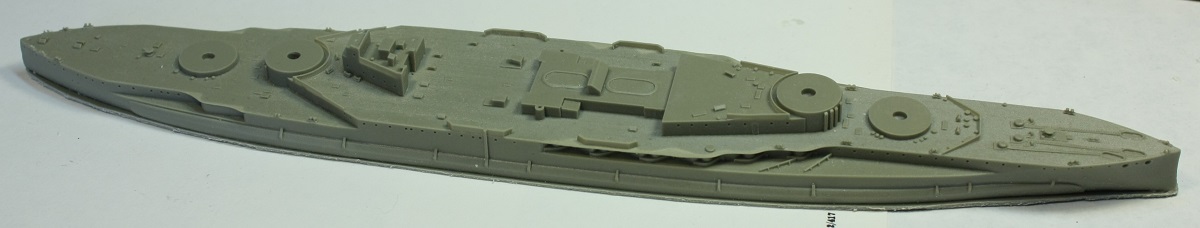

In fact I did the preparations and some preliminary work this spring in my old appartment but then had to wrap everything up and wait for some months to recommence the build at my new place.
The WEM kit has a large „plate” of resin cast on the underside perhaps to reinforce the hull and prevent it from warping – a phenomenon often seen in their models. This plate is supposed to be sanded off but I decided to to leave it there and sand it flush with the ship’s sides to gain extra freeboard which will allow me to position the model into rather than on the seascape.
The following pictures illustrate this process with the bulge’s fore end being sanded level with the hull.

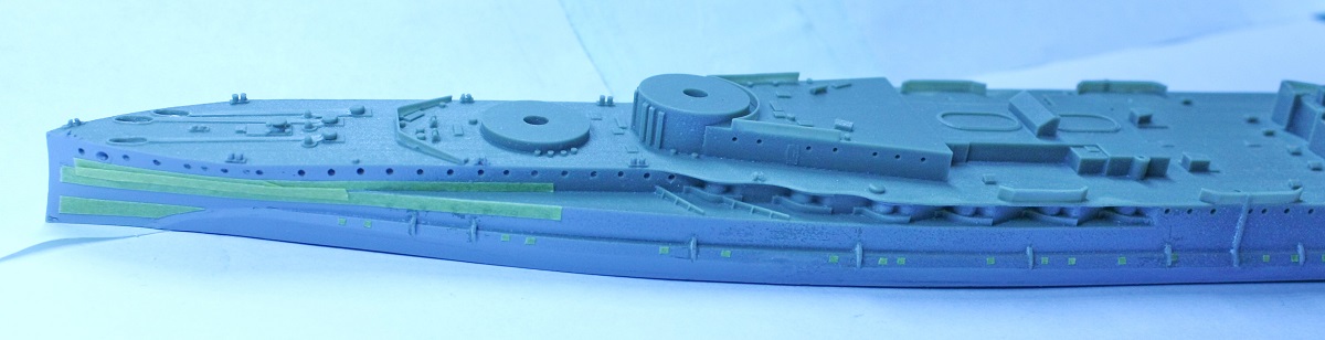

Construction has been delayed by the delivery of my new modelling desk. Once installed it provides much improved working conditions, though.
The ship’s hull has been screwed to my old temporary base. Portholes have been drilled out (perhaps too big, but these old dreadnoughts seem to have had larger portholes than later ships). The armour strakes were simulated by masking with strips of tape then applying coats of Mr. Surfacer.

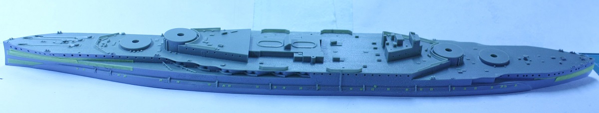

I did not mask the decks but there was just a little overspray. The bulges have dozens of vents which are not present in the kit. Upon studying photographs I stated that these vents were flush with the surrounding plates, or even somewhat recessed. I put small rectangular pieces of masking tape the appropriate locations before spraying the primer and reinforced the outline with a pin after the primer had dried. It hasn’t turned out very regular and uniform in shape… If I knew then what was available, I wouldn’t have gone through all this.

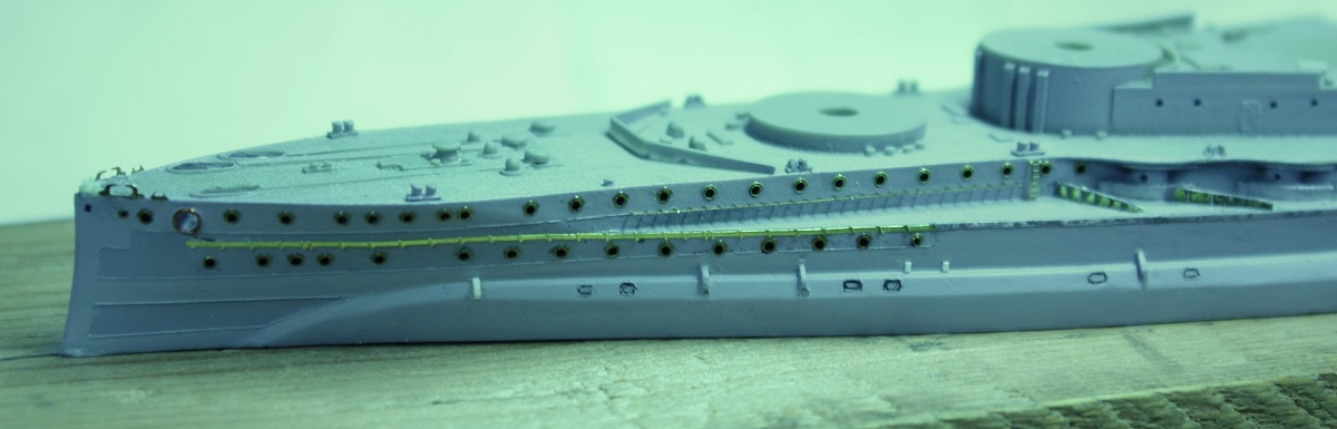

Next I added some details to the sides.
When Dino Carancini built his Barham there was a little debate here about the degaussing cable – it can be made out only in a few photographs from the last phase of the ships’s carreer. It seems to be present only in the fore part of the ship. Some people suggested that is is not appropriate to build a model like this as a degaussing cable is only effective when the ship is completely encircled by it. This is valid but the picures suggest otherwise. Anyway, I show this incomplete degaussing cable in my model and try to convince myself that under the circumstances of war the RN may not have had the opportunity to finish the installation of this device.

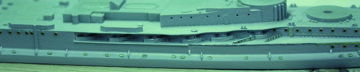

I realised almost too late one flaw of the WEM model: the casemate battery is set too deep inboard. I tried to alleviate this problem by gluing strips of aluminium to the armour plates below and above the cylinders from which the guns will protrude – it has got better, but is still not perfect.

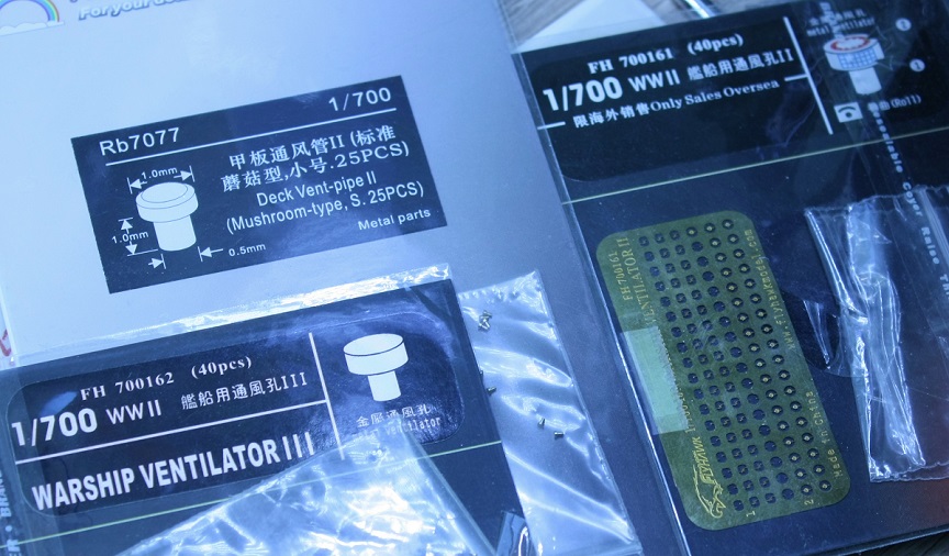

Well into the construction I was made aware of the existence of FlyHawk’s superset for the 1:700 Warspite
and Queen Elizabeth (sadly no Barham here) by Trumpeter - I didn’t hesitate to order both (my next ship will be Valiant, almost identical to QE at this time). Even in this early stage I could benefit from this marvellous set by utilising the finely etched blast covers for the bulge which improved my scratchbuilt ones tremendously.

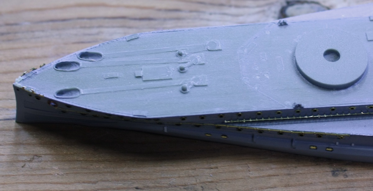

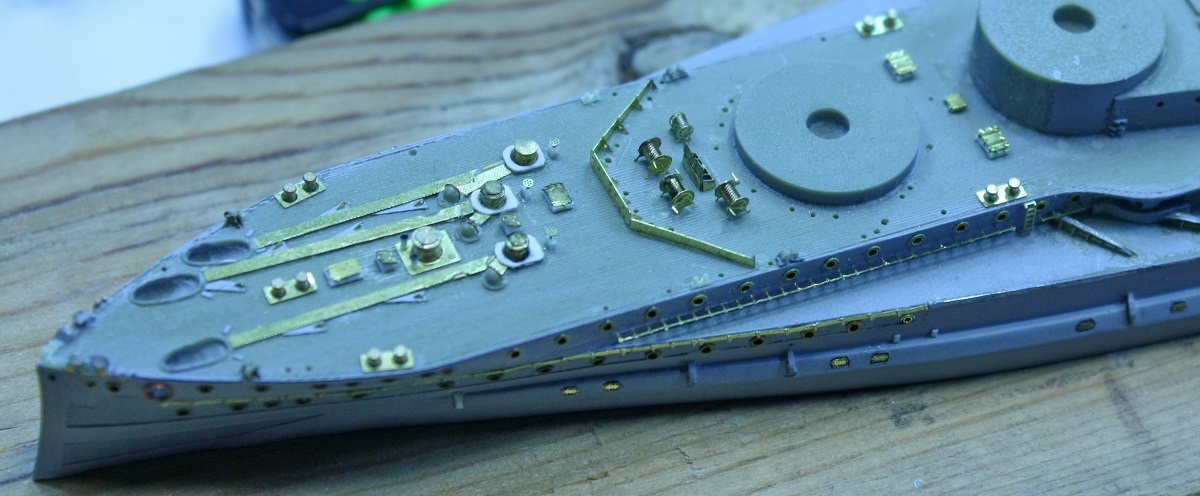

the ground tackle and the fittings surrounding it have been rebuilt using various detail sets and some scratchbuilt parts. The the rest of the forecastle deck and the quarterdeck will be treated similarly.

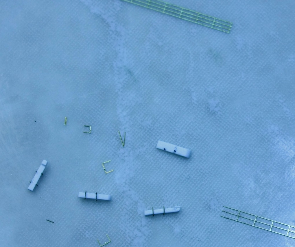

Thus I assembled eight washdeck lockers, 21 small and four large skylights plus two night lifebuoy casings from the Artist Hobby set of RN deck fittings which I found the most accurate and impressive of all that I had.

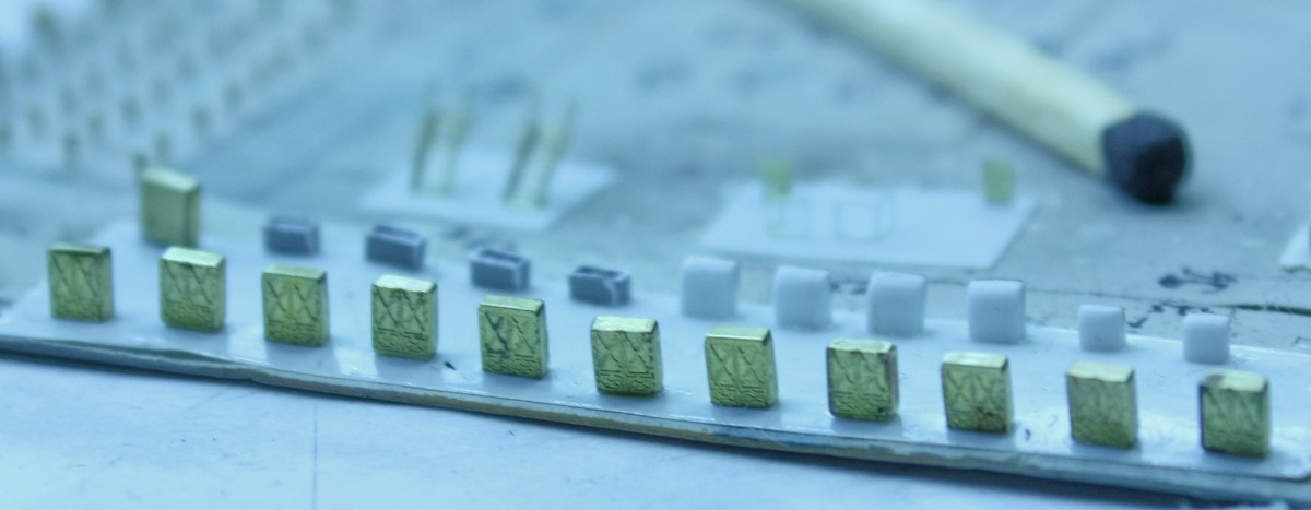

I glued them along with a total of 82 mushroom vents of three sizes from two manufacturers (FyHawk and Rainbow)
to two pieces of cardboard for the two camouflage colours (AP 507B and C) to make pre-assembly painting convenient.

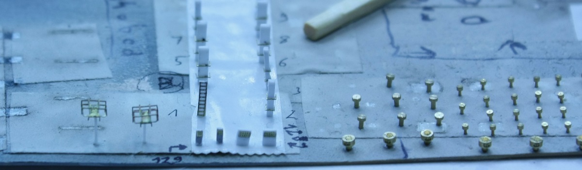

The quarterdeck skylights in various stages of assembly:

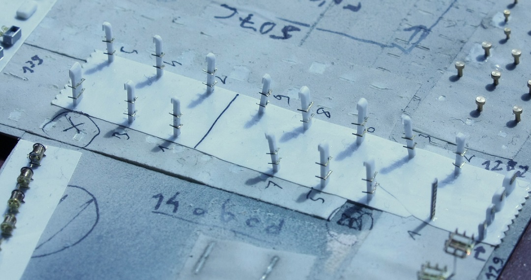

There are 14 four inch ammunition lockers - these were folded to shape using the Lion Roar caisson and store box set with very nice relief etched front plate.
