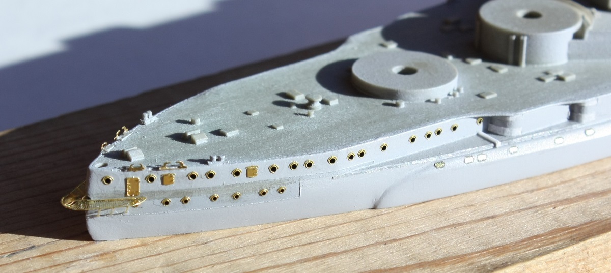

In fact I did the preparations and some preliminary work this spring in my old appartment but then had to wrap everything up and wait for some months to recommence the build at my new place.
The WEM kit has a large �plate� of resin cast on the underside perhaps to reinforce the hull and prevent it from warping � a phenomenon often seen in their models. This plate is supposed to be sanded off but I decided to to leave it there and sand it flush with the ship�s sides to gain extra freeboard which will allow me to position the model into rather than on the seascape.
The following pictures illustrate this process with the bulge�s fore end being sanded level with the hull.

.... I decided to to leave it there and sand it flush with the ship�s sides to gain extra freeboard which will allow me to position the model into rather than on the seascape.....
what a good idea-- !

An update at last.
Construction has been delayed by the delivery of my new modelling desk. Once installed it provides much improved working conditions, though.
The ship�s hull has been screwed to my old temporary base. Portholes have been drilled out (perhaps too big, but these old dreadnoughts seem to have had larger portholes than later ships). The armour strakes were simulated by masking with strips of tape then applying coats of Mr. Surfacer. I did not mask the decks but there was just a little overspray. The bulges have dozens of vents which are not present in the kit. Upon studying photographs I stated that these vents were flush with the surrounding plates, or even somewhat recessed. I put small rectangular pieces of masking tape the appropriate locations before spraying the primer and reinforced the outline with a pin after the primer had dried. It hasn�t turned out very regular and uniform in shape� If I knew then what was available, I wouldn�t have gone through all this.

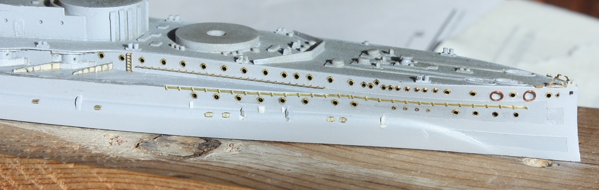

Next I added some details to the sides.
When Dino Carancini built his Barham there was a little debate here about the degaussing cable � it can be made out only in a few photographs from the last phase of the ships�s carreer. It seems to be present only in the fore part of the ship. Some people suggested that is is not appropriate to build a model like this as a degaussing cable is only effective when the ship is completely encircled by it. This is valid but the picures suggest otherwise. Anyway, I show this incomplete degaussing cable in my model and try to convince myself that under the circumstances of war the RN may not have had the opportunity to finish the installation of this device. PE portholes of two different sizes have been used along with a variety of other details like strakes, grab rails, rectangular scuttles, etc. The sternwalk (strangley missing from the Profile Morskie drawings but even from the sources deemed more reliable like Raven & Roberts or the Shipcraft publication, whereas its presence is clearly evident in contemporary pictures) canopy is not fitted yet for easy of painting. I realised almost too late one flaw of the WEM model: the casemate battery is set too deep inboard. I tried to alleviate this problem by gluing strips of aluminium to the armour plates below and above the cylinders from which the guns will protrude � it has got better, but is still not perfect.

Well into the construction I was made aware of the existence of FlyHawk�s superset for the 1:700 Warspite
( and Queen Elizabeth (sadly no Barham here) by Trumpeter - I didn�t hesitate to order both (my next ship will be Valiant, almost identical to QE at this time). Even in this early stage I could benefit from this marvellous set by utilising the finely etched blast covers for the bulge which improved my scratchbuilt ones tremendously. Next I will cut almost everything off the main and forecastle decks and pour all the brass I have on them.

Wow--you have been busy!
The brass PE lids have tidied up the vents!
On my 1/700 Royal Oak build ( seems like eons back but a mere 13 tears ago! ) from the WSW base...
I also concluded the lids on the bulge were flush--
and I recall I suggested them with a paint tone differential outlined in pencil see images x 2 below
If I was going to do it again-
-I would make a small metal blade punch ( out of a strip stainless steel PE waste; edge sanded into a blade )
bent into suitable desired shape, then pressed into a blob of filler paste ( to stabilise the shape and make a handle)
and press this cutting punch( with a small hammer tap ) onto black or grey decal strip
==> apply the hatches as a decal and later paint over the whole lot
could work!?

Jim, with hindsight I am glad that I initially made a shallow recess for those bulge vents. I also sanded down the backside of the PE covers. This way they don't really protrude from the surface surrounding them.
The method outlined in your post is truly ingenious - I am sure it works.

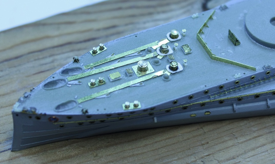

Some progress to report:
after almost everything has been shaved off the forecastle deck the ground tackle and the fittings surrounding it have been rebuilt using various detail sets and some scratchbuilt parts. The the rest of the forecastle deck and the quarterdeck will be treated similarly.

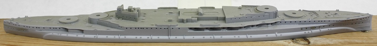

It�s been a long time since I last posted an update. Alas I�ve been extremely busy with work and the progress I have made is moderate at best.
I carried on with the detailing of the deck fittings. Barham had less superstructure than the other members of the class (in their rebuilt configuration). Consequently there is quite a lot of equipment on the forecastle deck and quarterdeck. I tried to use the most accurate items of the photoetched details at my disposal. Unfortunately the state depicted (as sunk) is poorly documented (at least I was unable to unearth good quality photographs aside from a nice, high-res starboard view). On the other hand even the most respected plans contain errors. The only commercially available plan containing every detail to scratchbuild a 1:350 scale replica, the Profile Morskie booklet should be interpreted with caution. I adopted a policy of confirming every detail with other sources, correcting not- too- infrequent errors and only accepting info from that booklet when no picture or drawing from the detail in question was available (to me).
Thus I assembled eight washdeck lockers, 21 small and four large skylights plus two night lifebuoy casings from the Artist Hobby set of RN deck fittings which I found the most accurate and impressive of all that I had. I glued them along with a total of 82 mushroom vents of three sizes from two manufacturers (FyHawk and Rainbow) to two pieces of cardboard for the two camouflage colours (AP 507B and C) to make pre-assembly painting convenient. The quarterdeck skylights in various stages of assembly: There are 14 four inch ammunition lockers - these were folded to shape using the Lion Roar caisson and store box set with very nice relief etched front plate. 11 cable reels were also prepared for later assembly � I attached handles to them cut from pieces of railing.

Of course not every deck detail is available from aftermarket manufacturers � there is still room for scratchbuilding. A good example for this is the variety of tall vents surrounding barbette B and X. The moulded-on vents were cut off the barbettes, then new ones have been fabricated from Evergreen strips, laminated, sanded to shape and provided with bracing cut from 1:700 and 1:600 railing.
The tiny vents were somewhat difficult to handle.
I similarly scratchbuilt 12 short vents which will be located on the after part of the forecastle deck.
