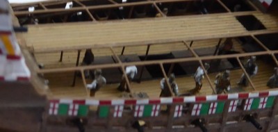

- JIM BAUMANN
- Posts: 5698
Re: HMS Mary Rose sailing warship Henry VIII English Navy 1

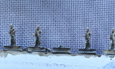

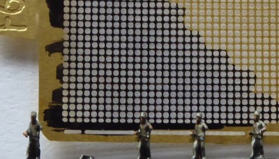

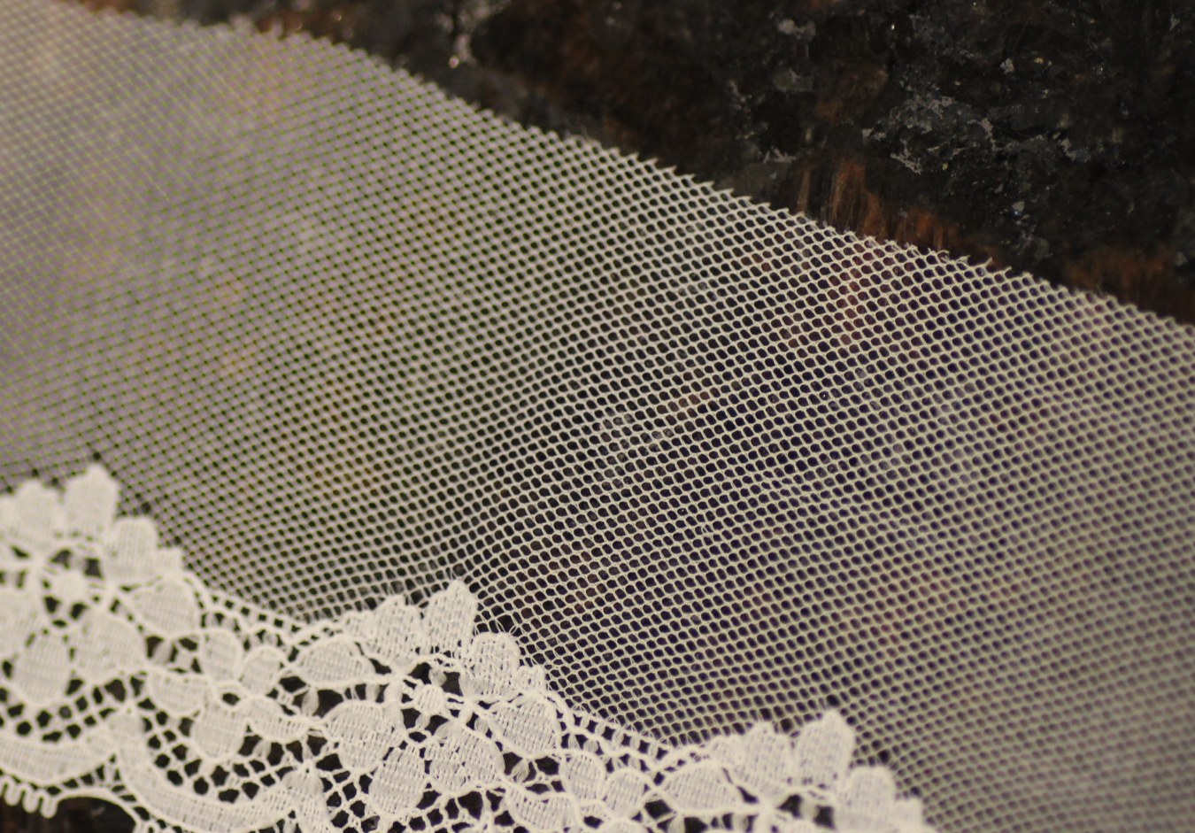

Thank you all for thoughts and advice

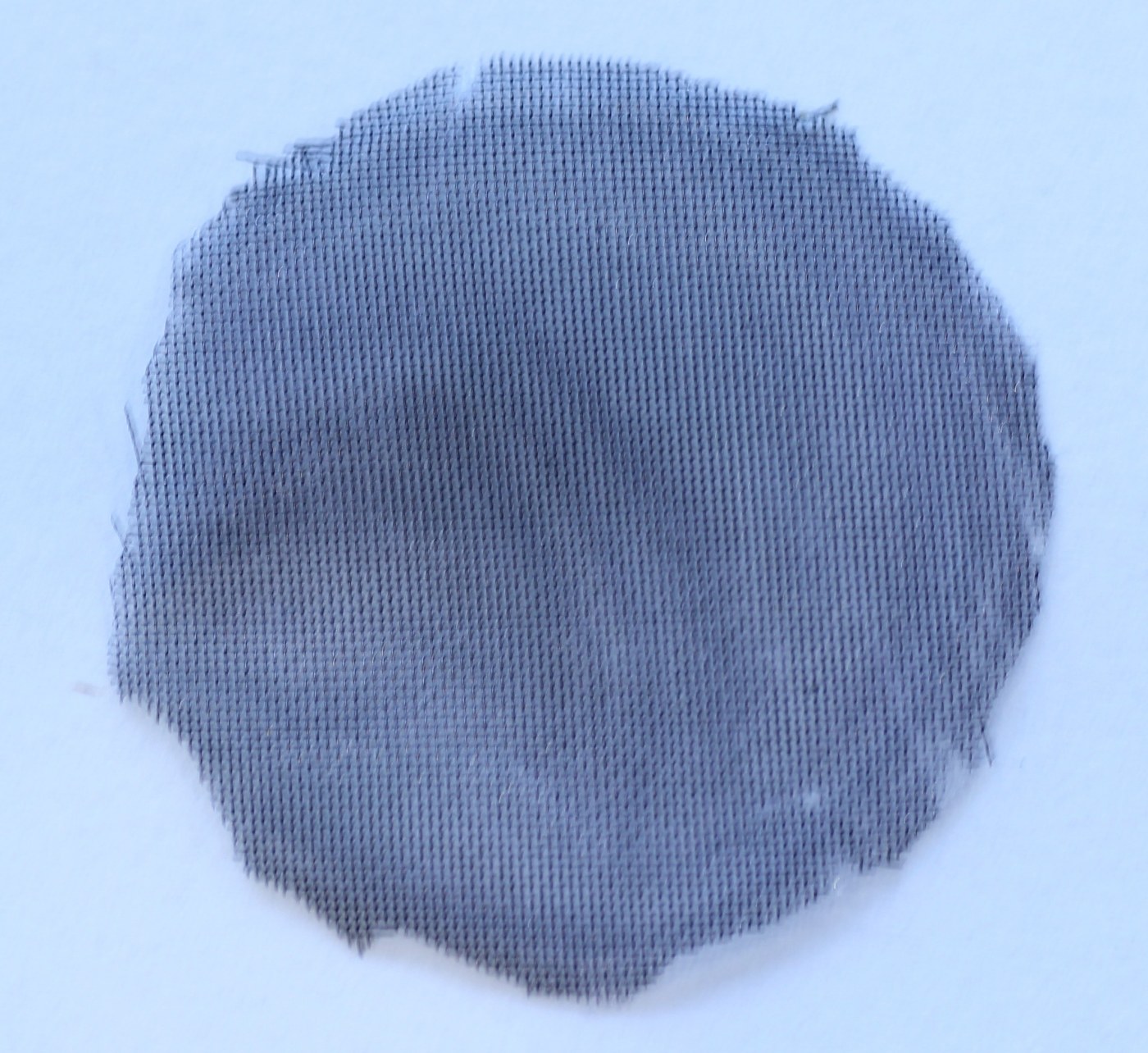

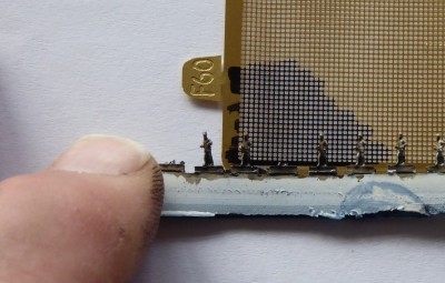

I am still in a 'net ' dilemma ...
THE PE mesh from scale-link arrived-- size is OK ish--but I did not like the thickness ( lack of finesse) of the etching at the junctures
what do you all think?

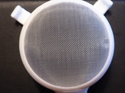

I Germany I bought some small domestic sieves with a fine mesh to experiment with....
any thoughts?
any thoughts?
- JIM BAUMANN
- Posts: 5698

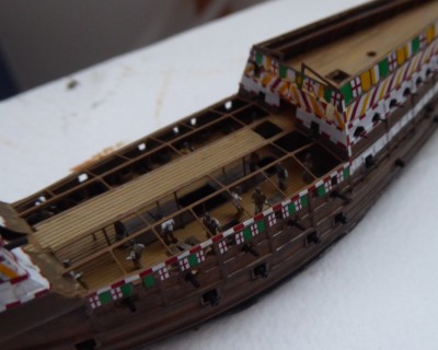

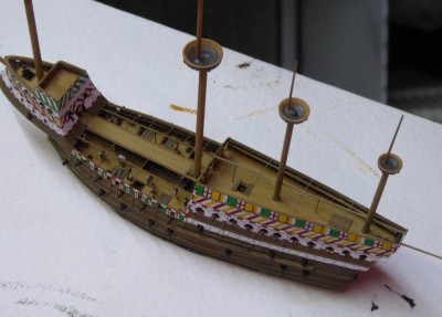

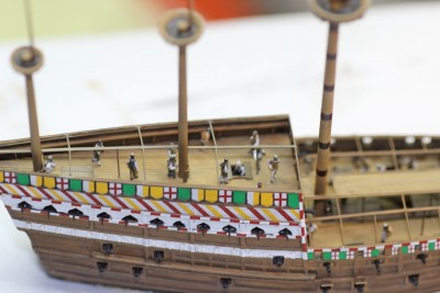

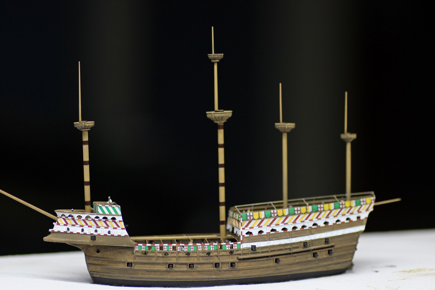

whilst trying to find an answer to the mesh conundrum issue-
-I started to populate the waist deck with some crew-members
using some elderly Goffy figures
these are NOT as fine, well cast or nice as the L'Arsenal figures--but are a bit smaller-- nearer 1/400.
I shall use some North Star and and some L'Aresenall figures in other areas

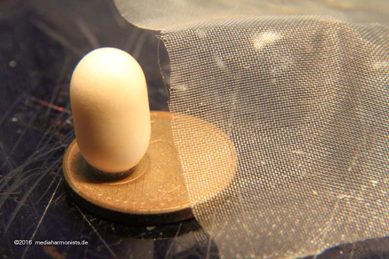

There are new tea bags with a extra fine PE-Netting on the market now.
XXXDAn
XXXDAn
To Victory and beyond ...

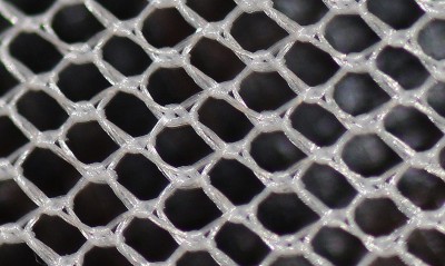

- dafi
- Posts: 1005
- Joined: Mon Mar 12, 2012 11:13 am
- Location: Ludwigsburg/Germany

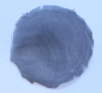

Hello Jim,
this is the finest mesh I have seen so far. Comes out of a "pyramid tea bag", that I found already in Germany and England
A similar material I once dyed with cloth dye for synthetics.
XXXDAn
XXXDAn

@ dafi-- dumb question-- there is an array of pyramid tea bag manufacturers in the UK--soem of which use paper bags
Now then ...to stop me opening all the tea packets in the local supermarket
( bad form eh!)
which tea manufacturer did that good looking mesh come from?
I am willing to look at and try anything for the 'correct' effect...
something that 'looks' to scale-
-but gives sufficient see-through to not obscure the waist deck...
many thanks all
regards
JB
many thanks all
regards
JB

Mark & Spencers is the winner
Possibly you get the stuff for cheap if they have X-Mess clearance

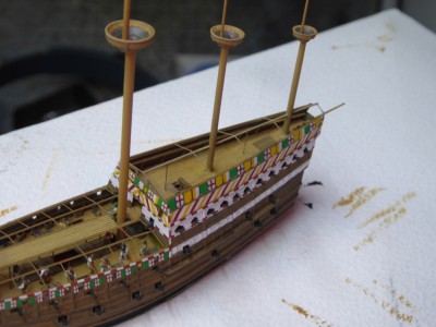

- JIM BAUMANN
- Posts: 5698
Dear all!
Thank you for inputs and samples sent!

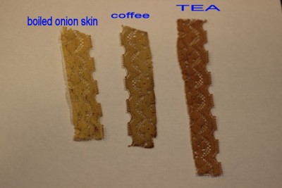

I have amassed quite a collection of small pieces of mesh of all sorts of sizes...
you may recall the oversize edging to the flowery lace ( Mk1 idea )
link below
download/file.php?id=98103&mode=view
aha!!!

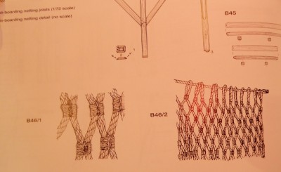

maybe its was not so wrong after all... albeit this sample was somewhat large ad ergo overscale ...
the AOTS Mary Rose book has some quie useful drawings within.. of guns, sails mastes etc
including this one...
Hmmnnn--food for thought!--...off to find a millinery shop nearby

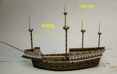

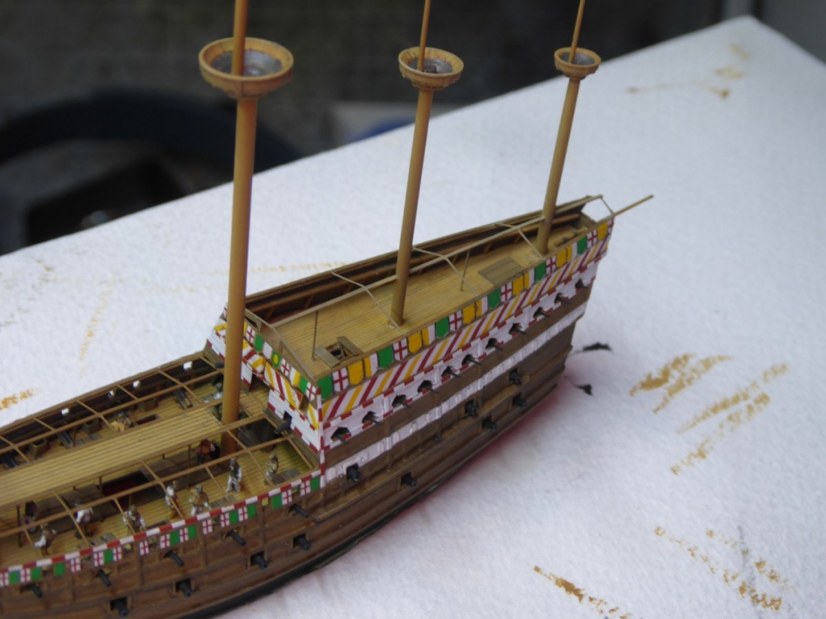

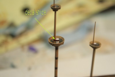

the all-metal tapered masts were assembled, painted and installed-- so as to allow the boarding netting frame to be constructed
i then ( laboriously !) constructed the aft deck anti-boarding netting support frame in situ , using small pieces of wire and styrene strip,
all butt glued minute glue contact surfaces--so ...-mainly using will-power to make the adhesive hold!
The dedicated Scale-Warships ratlines had their basecoat in dark brown--I plan to pick out the footropes in a lighter colour and add soem contrasts

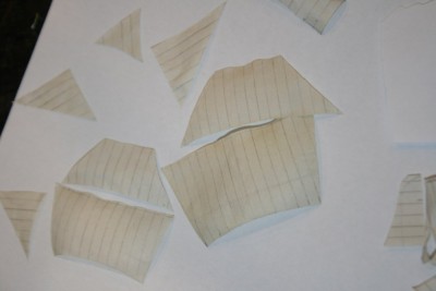

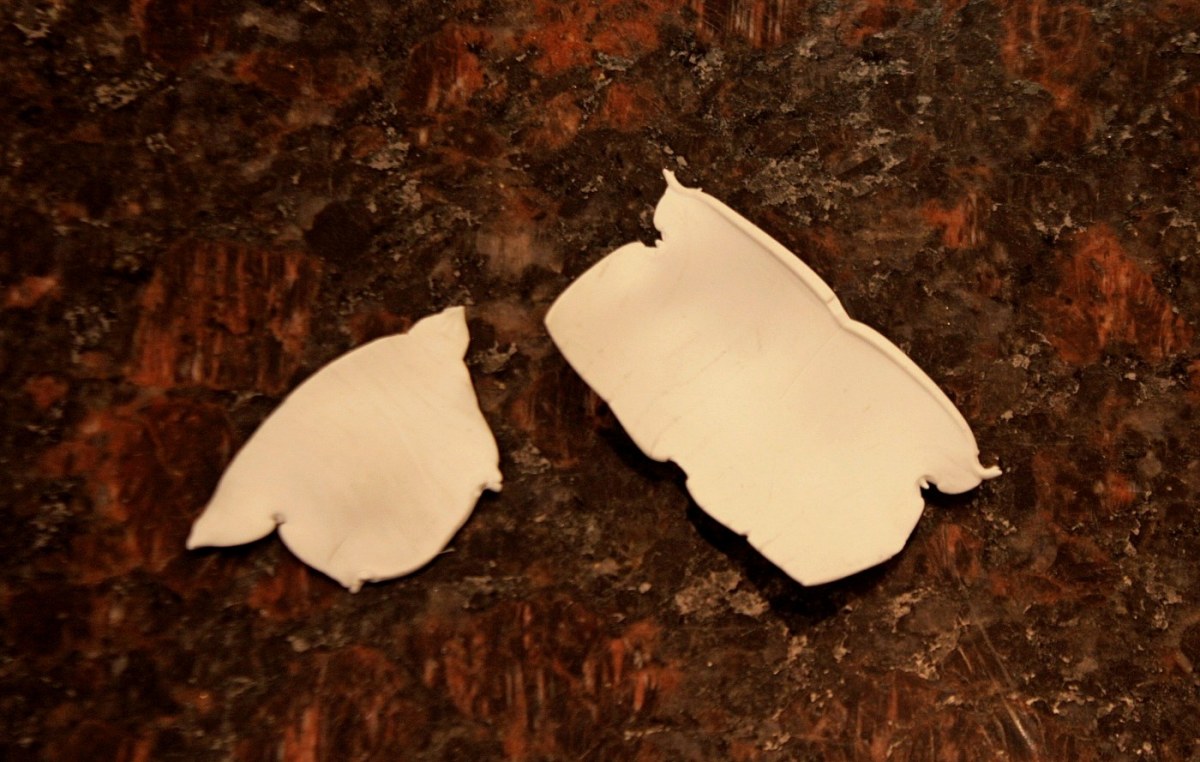

... making the sails
I decided on fine thin paper-- non waxed newprint base in off-white
I needed to do some experiments... not least because of conflicting information.
One book suggests the sails were made of 2ft wide panels- ; this = 601 mm and in 1/400 scale this translates into 1.5 mm wide panels.
this may be correct--but I think that it is perhaps beyond my skill to draw them out accurately and consistently finely enough
the AOTS book has scale drawings in 1/192 scale-- measured off and roughly halved for 1/400
these panel lines work out at 3.7 mm-- for easy maths I aimed at 4 mm intervals
Having made a set of sails with 4mm panels I felt they looked a bit ... err... clunky.
especially when compared to the 'modern' painting by Geoff Hunt of the sinking.
..( which is also based on best guess--albeit perhaps rather more educated best guess..!
so I made another set using 3mm drawn lines( drawn on both sides of the paper back to back )
drawing lines is laborious and slow...
The kit sails in plastic are actually quite good in shape and outline--alas rather thick and chunky
My paper sails were shaped wet-over the plastic sails --using them as a 3D shaped mould -
this was then placed in the oven -on a fan-setting to get them dry quickly and thereby preserve the shape.
I learnt something though....
Do ensure the oven is not too hot...
my moulds for the main and fore-course were rather misshapen( destroyed) by the oven being "a trifle " too warm
( best not ask! )
.... I only wanted some speedy drying!
link below
aha!!!
I also painted some older Saemann ratllnes which I may chop about for the upper masts...
then I tried to face down " the elephant in the room.."..
( best not ask! )
suffice it to say that 50 degrees C is the correct temperature...

did however have one success.
found at last 'net' that was the correct size and diamond shape.
My friend Lucy --who collects EVERYTHING ( much like me! ) has a vast arsenal of "stuff"
and was- to my unbounded joy! - able to produce the just about optimal netting pictured below.
Thanks babe! xx
it is a " knit" but is the correct size and in proportion to the model ' looks' right to my eyes...
a really Huuuge enlargement below
I have experimented in colour dying the stuff...( using the flowery waste)
with Tea being the current winner..(! )
will also now also try some diluted wood dye...

Despite none of the drawings of the ship/ rig/ spars in Anatomy of the ship book, paintings, other plans and illustrations in other Mary Rose books ( Marsden et al)
showing the mast tops as NOT visible.... but terminating in the platforms,
-- indeed none of the above publications showed any mast wolding either...
( wolding-- as I understand it-- is sailing ship practice of wrapping rope around a spar in intermittent sets around ( tall ) wooden masts to help prevent/ inhibit splitting--or in the case of long yards to hold the two halves together )
hence I proceeded--maybe with haste (?) --and installed all the masts as previously posted.
Upon the advice of my sailing ship e-mentor ,
-- who took the step that eluded me of course ( doh!! ) of looking at other contemporary ships of that era ....
( obvious really! )
anyhow he supplied me with some pretty compelling images that spoke for both visible tops and wolding...
The tops were easy enough to simulate, strips of appropriate sized styrene rod glued on the metal mast tops
the banding ( my guesswork ) ( twixt mast lower and upper) was made using decal stripe
These tops were made so that they are only just visible above the crows nests( right or wrong..)
no spars were recovered from the Mary Rose wreck anyhow so...
meanwhile the wolding process...
==> normally this would be done by winding fine thread around the mast. easy enough when the mast is in its pinchuck/ mandrel...
rather harder when the masts have already been fitted to the ship and epoxied in for keeps...( my own fault )
I could just have not ..
but that would have been too easy...
I used dark brown decal strip, lightly drybrushed in situ with a coarse brush and some black on ..
the effect is ok and not overscale....
the monotony of painting linen shirted leather 'jerkined crew members ( all of whom will be ' soft-focussed' underneath the netting in the end....

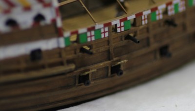

I started adding some of the guport lids
these--unlike gunport lids on later vessels that are often seen opened at 90 degress to the waterline,
Mary Rose had a recessed facet in the hull timber above each port
( this can be seen on the wreck remains in the museum )
so as to facilitate the raising of te port lids to approx 45 degrees.
anyhow--it makes for a more interesting looking model!
The gunport hoist line is reckoned( AITS and others ) to have been operated from much higher up ...==> though that still needs investigating... !! ?
