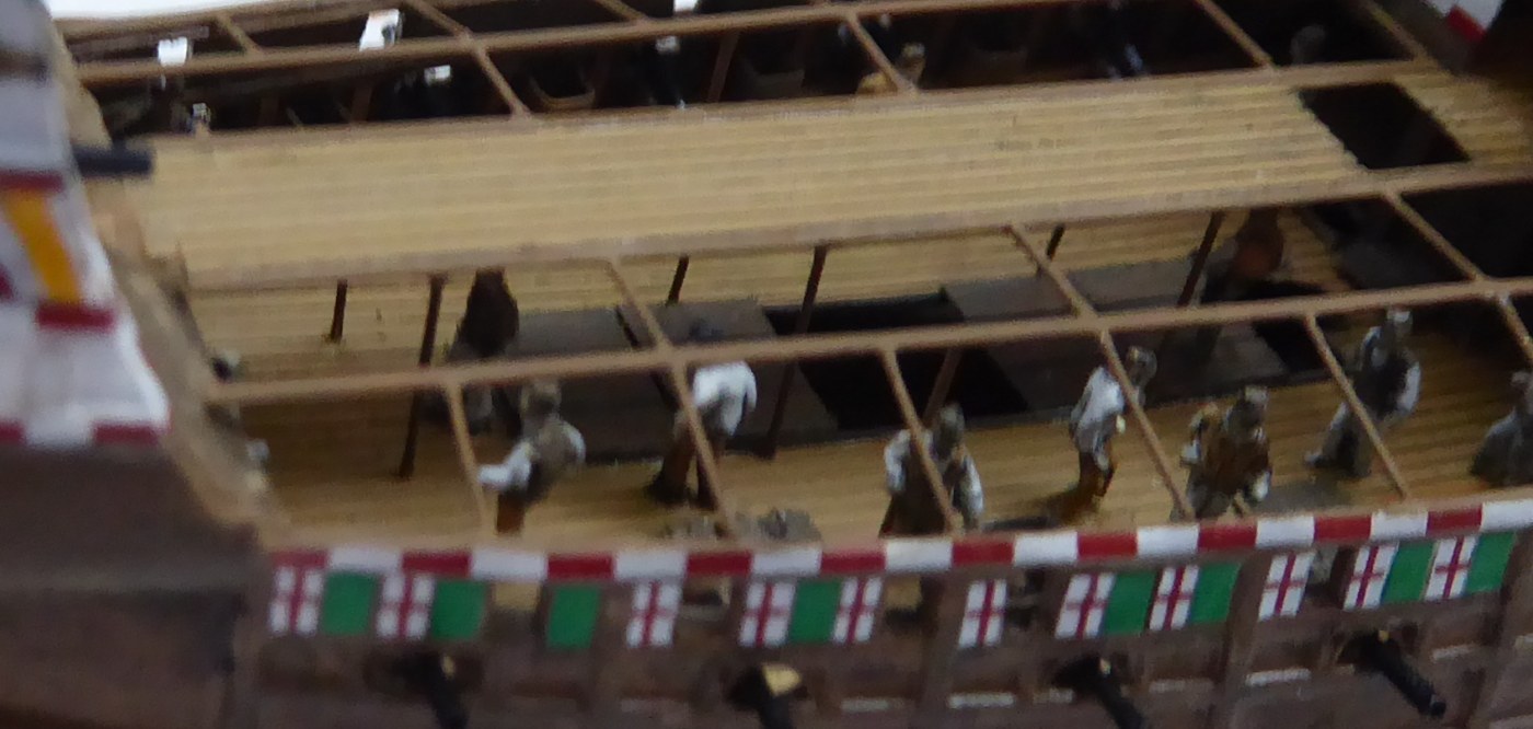

whilst trying to find an answer to the mesh conundrum issue-
-I started to populate the waist deck with some crew-members
using some elderly Goffy figures
these are NOT as fine, well cast or nice as the L'Arsenal figures--but are a bit smaller-- nearer 1/400.
I shall use some North Star and and some L'Aresenall figures in other areas

Despite none of the drawings of the ship/ rig/ spars in Anatomy of the ship book, paintings, other plans and illustrations in other Mary Rose books ( Marsden et al)
showing the mast tops as NOT visible.... but terminating in the platforms,
-- indeed none of the above publications showed any mast wolding either...
( wolding-- as I understand it-- is sailing ship practice of wrapping rope around a spar in intermittent sets around ( tall ) wooden masts to help prevent/ inhibit splitting--or in the case of long yards to hold the two halves together )
hence I proceeded--maybe with haste (?) --and installed all the masts as previously posted.
Upon the advice of my sailing ship e-mentor , :big_grin: -- who took the step that eluded me of course ( doh!! ) of looking at other contemporary ships of that era ....
( obvious really! )
anyhow he supplied me with some pretty compelling images that spoke for both visible tops and wolding...
The tops were easy enough to simulate, strips of appropriate sized styrene rod glued on the metal mast tops
the banding ( my guesswork ) ( twixt mast lower and upper) was made using decal stripe
These tops were made so that they are only just visible above the crows nests( right or wrong..)
no spars were recovered from the Mary Rose wreck anyhow so...
meanwhile the wolding process...
==> normally this would be done by winding fine thread around the mast. easy enough when the mast is in its pinchuck/ mandrel...
rather harder when the masts have already been fitted to the ship and epoxied in for keeps...( my own fault )
I could just have not .. :cool_2: :wave_1: :thumbs_up_1: but that would have been too easy...
I used dark brown decal strip, lightly drybrushed in situ with a coarse brush and some black on ..
the effect is ok and not overscale....
the monotony of painting linen shirted leather 'jerkined crew members ( all of whom will be ' soft-focussed' underneath the netting in the end....
I started adding some of the guport lids
these--unlike gunport lids on later vessels that are often seen opened at 90 degress to the waterline,
Mary Rose had a recessed facet in the hull timber above each port
( this can be seen on the wreck remains in the museum )
so as to facilitate the raising of te port lids to approx 45 degrees.
anyhow--it makes for a more interesting looking model! :big_grin:
The gunport hoist line is reckoned( AITS and others ) to have been operated from much higher up ...==> though that still needs investigating... !! ?
