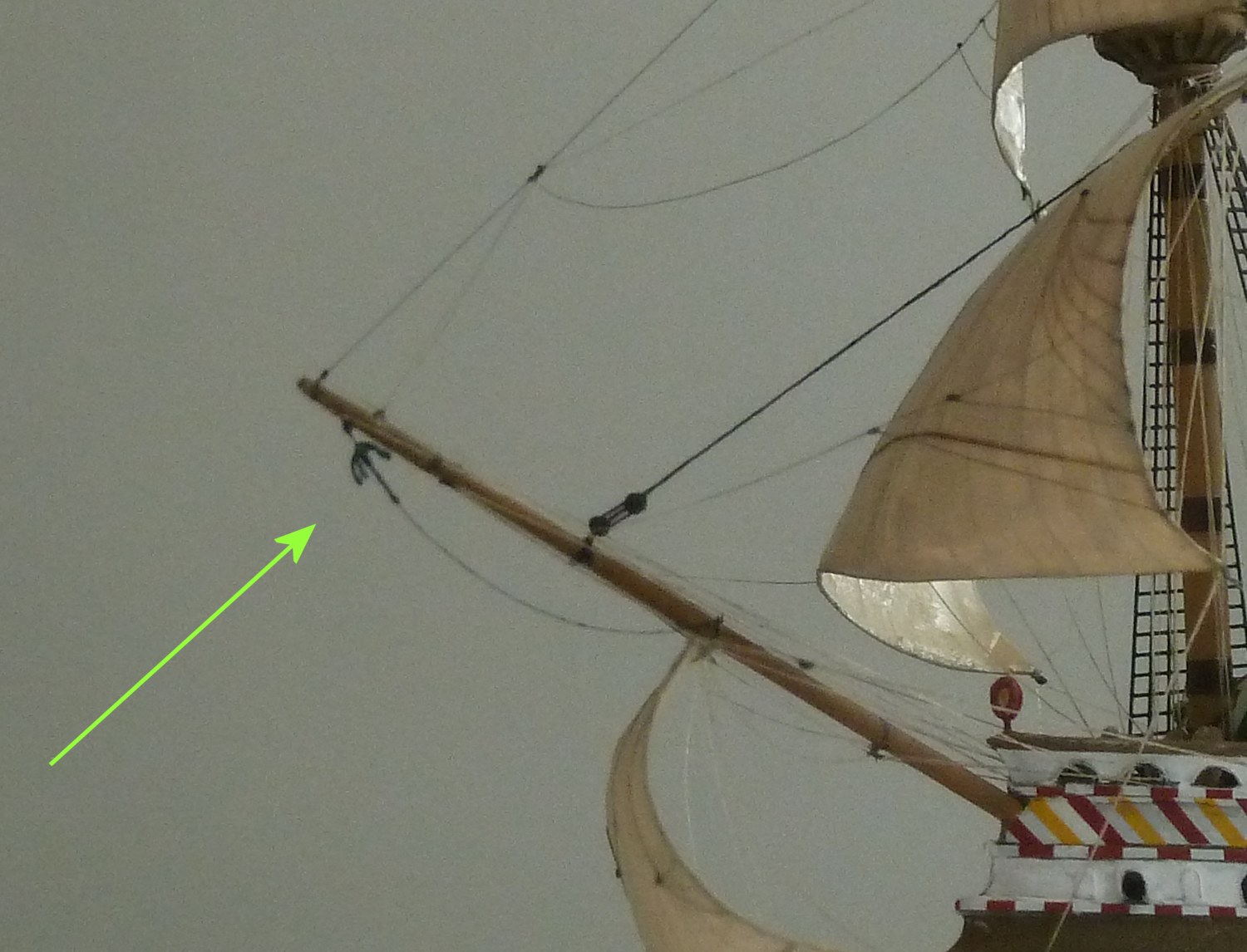

Mary Rose carried a grappling anchor at the bowsprit--
I made mine of wire circles ( different size this ime! ) cut in half...
glued together --the flukes were made of small bobs of white glue
--when set- flattened with pliers
The main anchors were placed, catheads made and the anchors slung--held in place with sprue ropes...

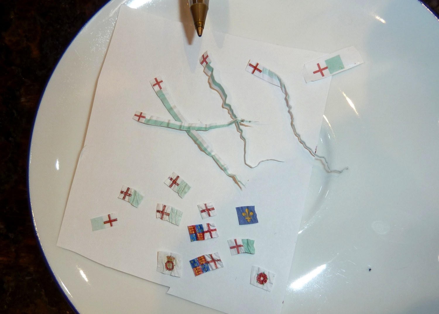

alas I was unable to print the satisfactorily onto white decal sheet on my inkjet printer,
and chum Steve's laserprinter was unhappy with paper thickness and jammed....
Having asked around in the main forum --I was helpfully given numerous suggestions for pro decal printing.
However the laser printing onto high quality regular printer paper looked very sharp and the colours were more subdued...
so I decided to go with paper flags--I acted upon the suggestions and instruction of fellow Modelwarshiper SgtRyan13
who said:
Hey Jim,
I ran into the same issue with trying to print some intricate flags at home as well. The solution that ended up working for me quite nicely was actually very simple. I printed them on regular white paper, and then cut around the flag I wanted to use, and with magnifiers and a frest #11 blade, I was able to peel apart the different layers of the paper taking only the very top layer with the flag printed on it and folding and gluing it. They came out looking every bit as good as decals and not noticeably thicker than the decal flags in 1/350.
and this is what I ended up with
.... what I did ...
Splitting the paper to make the thin flags
the difference being that my flags were separate and not hinged at the hoist end
-I did not cut them to size until after the glueing stage, outlining afterwards with scissors
so after separating the paper layers to end up with a very very thin piece of paper indeed
I joined them back to back on a " light-box" for accuracy
After a few short hours...( !) of carefully separating paper--quite laboriously-- along with a fair rate of failures (!)
I ended up with a saucer-full of (flat ) flags.
These were first thoroughly dried on a radiator
and then the fun begins!
Crinkling flags into believable shapes is actually quite tricky--but ultimately rewarding.
I sandwich my flags between a folded sheet of paper
and then set to with a pair of pointed tweezers to crease and counter crease the paper containing the flag and this also softens the paper of the flag within
(I do the same with a water-slide decal flag-- the folded sheet of paper softens the radius of the folds and prevents them cracking)
I plan to attach them to the vessel over the weekend.
will report in thereafter!
