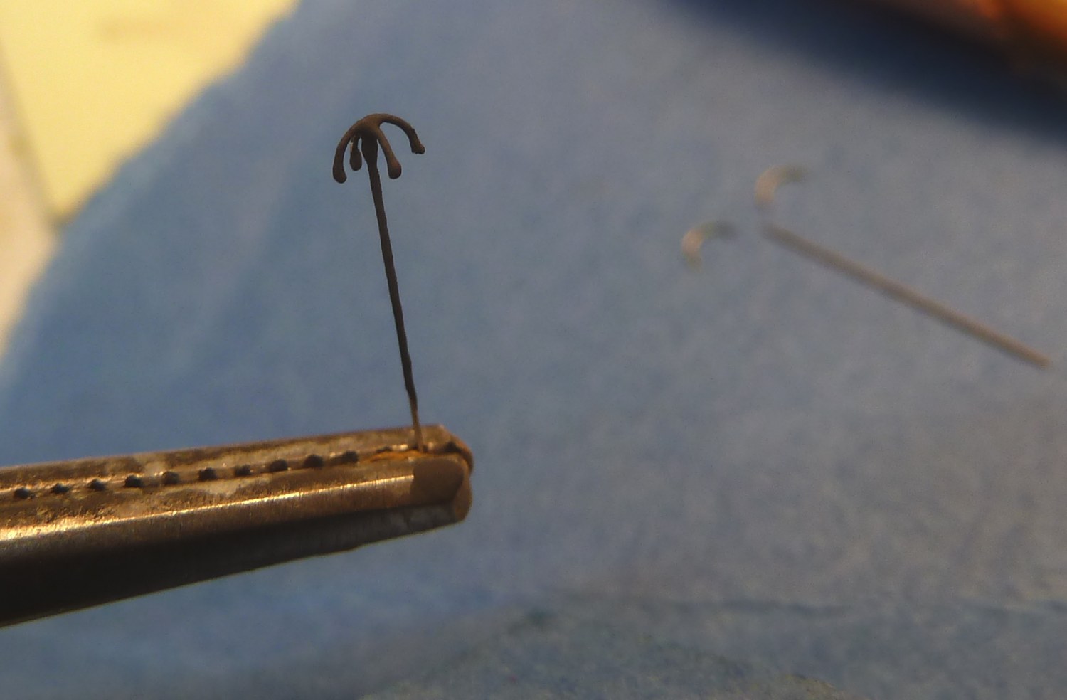

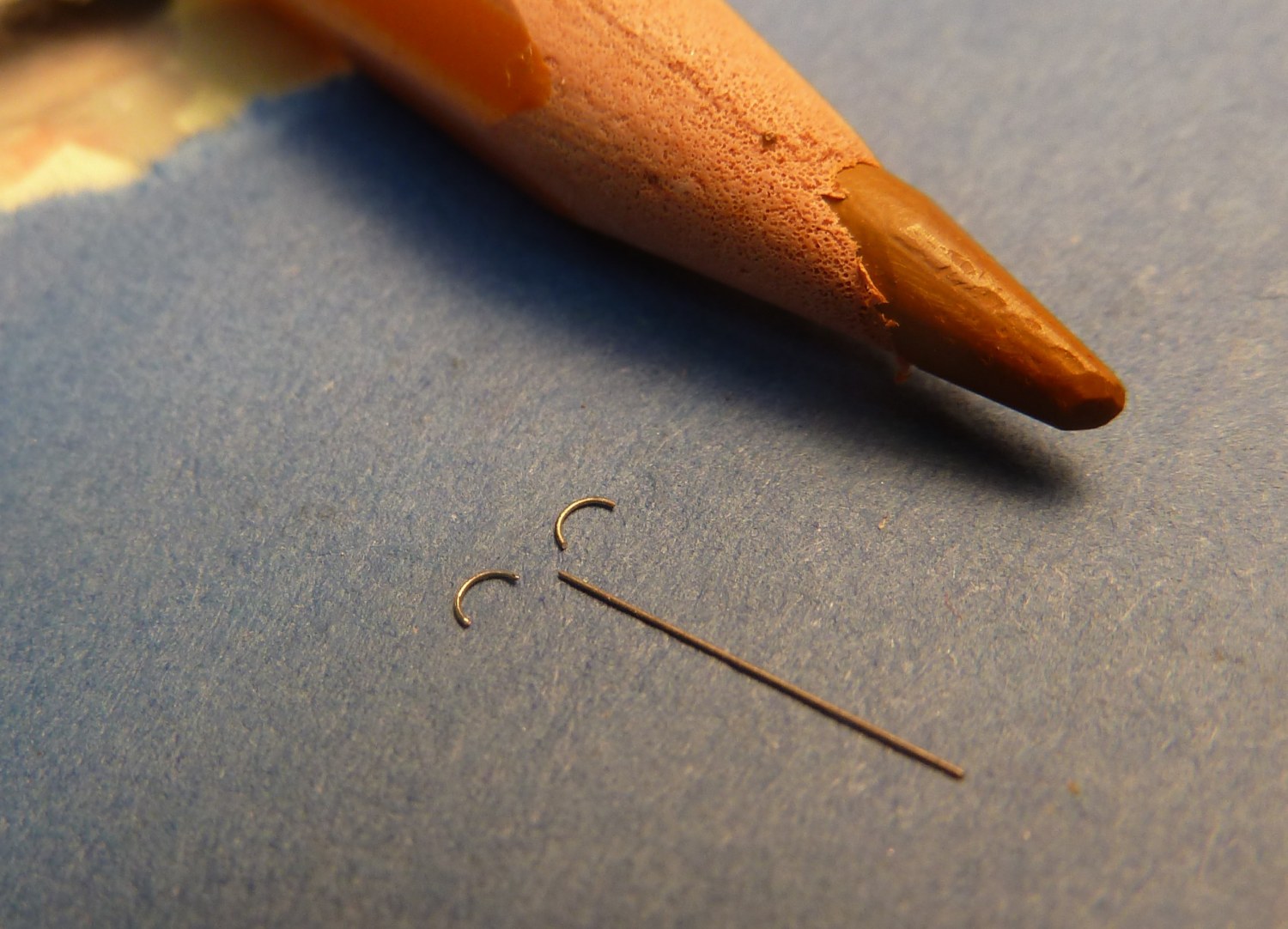

I made my own out of small wire circles cut in half and spliced together with CA glue
I decided to join the vertical disposition camp-- as it will look more interesting in photos :big_grin:

I made mine of wire circles ( different size this ime! ) cut in half...
glued together --the flukes were made of small bobs of white glue
--when set- flattened with pliers

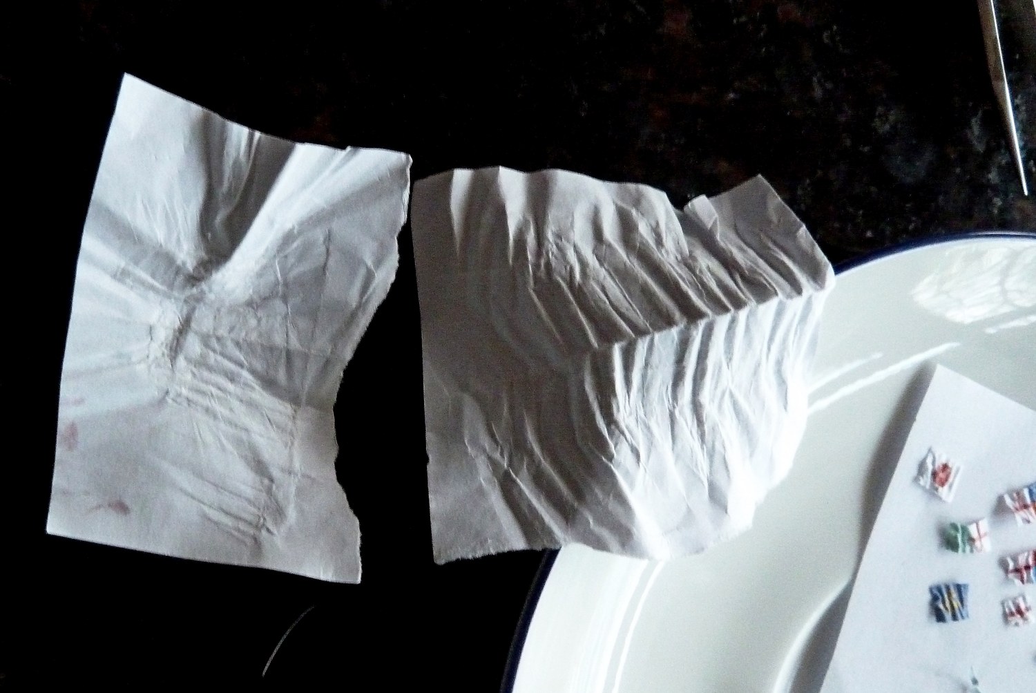

.... what I did ...
Splitting the paper to make the thin flags
the difference being that my flags were separate and not hinged at the hoist end
-I did not cut them to size until after the glueing stage, outlining afterwards with scissors
so after separating the paper layers to end up with a very very thin piece of paper indeed
I joined them back to back on a " light-box" for accuracy
After a few short hours...( !) of carefully separating paper--quite laboriously-- along with a fair rate of failures (!)
I ended up with a saucer-full of (flat ) flags.
These were first thoroughly dried on a radiator
and then the fun begins!
Crinkling flags into believable shapes is actually quite tricky--but ultimately rewarding.
I sandwich my flags between a folded sheet of paper
and then set to with a pair of pointed tweezers to crease and counter crease the paper containing the flag and this also softens the paper of the flag within

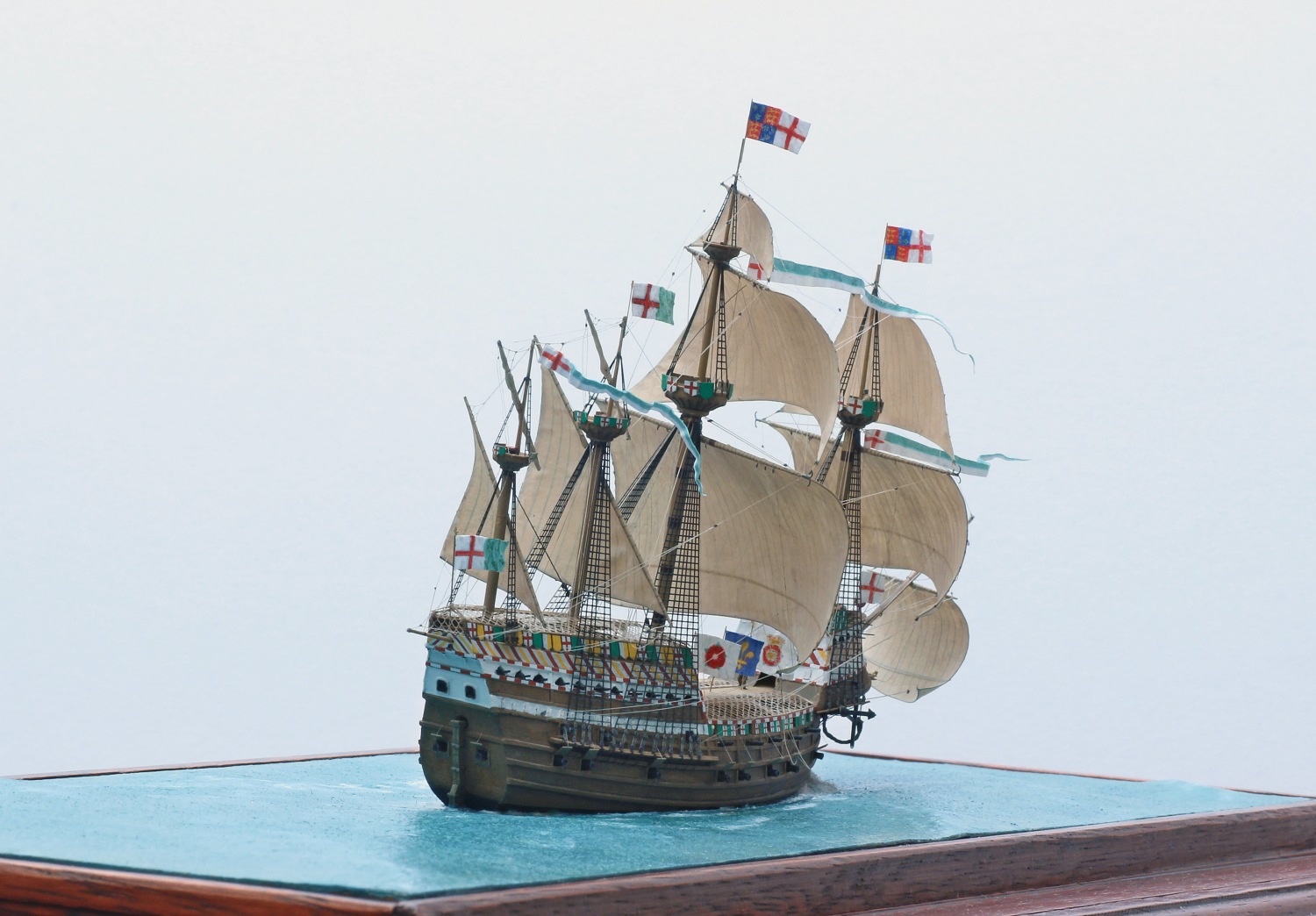

we are on the final run now.....
Having made the flags-- I had to attach them to the vessel.
The conventional ' square' flags were relatively straightforward --tack on the upper corner to the staffs with thinned white glue , back up with CA
and then add the wind-dragged halyards
the overall effect is pleasing

The large long streamers were rather more tricky...
( on the real ship--the mainmast streamer was 50 feet long!! )
We did succeed in printing some acceptable decals in the end...
but they did not take a nice ' snake '. being springy and a bit saggy
We also used a photo printer , and then de-laminated the paper off the image film, glued back to back
But they did not snake nicely--being a bit too springy and ' inorganic '
In th end I used the paper prints-- these "stood " up well
more in a moment... :cool_2:
the ship being mounted on a base made it very easy to manipulate...
whilst the glue holding the streamers at the desired angle took its merry time to set...(!!! )
The overall effect was pleasing to the eye....
