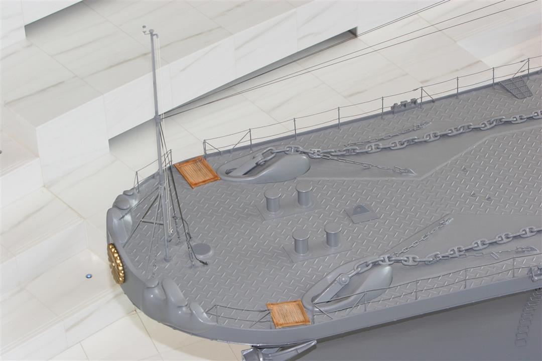

The Jackstaff is a vertical flagpole of 9,55 meter high that is placed 1,30m behind the front ornament on the bow. See Pic 01.
On the top of the Jackstaff we see a lantern. The lantern is facing forward and standing slightly higher than the tip of the Jakstaff. See pic 02
On the AFT side of the flag-pole, just under the lantern( front-side), we see a small pulley with a white cord. This white cord will serve to raise the Jack, a small flag typical for military vessels. Jacks, following Wikipedia are only attached while the ship is at anchor or moored pierside, but NOT under way.
The jackstaff pole is standing on a round flag-base, 300mm in diameter, see pic 03-04-05-07-10. At the base, the jackstaff pole has a diameter of 140mm.
On its top , just under the pole-knob, the pole-diameter is 90mm. See pic 02.
At a height of 605cm the staff is equipped with two pulleys , one on the left side of the pole , and one on the right side. See pic 01-04-05-06.
These 2 pulleys are the devices where the Main Cables Nr 1&2 in the port side pulley, and Main Cables Nr 3&4 in the starboard side pulley will be guided above the ship deck. See detail Pic 06.

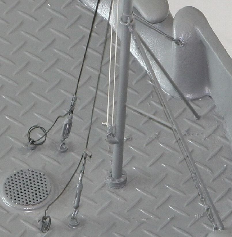

Main Cables Nr 1&2 and Nr 3&4 are secured to the deck with bottle-screws: 1 bottle-screw for MC Nr 1&2 and 1 bottle-screw for MC Nr 3&4.
The bottle-screws are each 500mm long and are secured to the deck via round deck fittings that are located 750mm BEHIND the flagpole and at about 600mm at the Left and the Right from the pole. Check your ref drawings on page 92 in AOTS and check pic 05 -07 in this post.
Remark : the bottle-screws hold the cable ends of MC Nr 1-2-3-4, but the surplus of the cable-ends are guided to a smaller deck fitting, somewhat behind the botte-screws. See detail pic 07.
The 2 smaller deck fittings are 85mm in diameter and are equipped with a lug-ring to catch the loose ends of MC Nr 1&2 on the left and MC Nr 3&4 on the right side.
The surplus of the cables are nicely rolled-up to avoid Japanese Sailor Tackling.
One could imagine that the weight of- and the tension on the MC Nr 1-2-3-4 would slightly bend the Jackstaff. To counter this phenomenon , the Jackstaff is secured to the front of the deck with 2 different devices.
The first device is a solid steel rod of 50mm diameter , bent in a V-shape and surrounding the Jackstaff circumferentially on a height of 330cm above the deck. The V-ends are attached to the deck , just behind the ornament, 240cm separated from each other. See pic 04-05.
The second device: 2 cables that start in a lug-ring at BOTH sides of the Jackstaff , right above the solid rod , at a height of 335cm above the deck. Both cables are led down , sidewards and in front of the jackstaff to a lug ring.
Remark: this lug ring is NOT attached to the deck but to the rear side of the ornament, see pic 07.
The lugs in the ornament are separated 540cm from each other and are at an unknown height : dimension not available. Check pic 07 to get an idea.
Securing of both cables is done with a bottle-screw : see pic07 . Remark : front view of the pic 07 : see the attachment location of the solid rod and the cable attachment to the ornament.
Pic 10 gives a better view where the solid rod arms are attached and where exactly the securing cables are attached to the ornament lugs, each with 1 bottle-screw.
Note : the solid rod arms are attached to the deck without any other deck fitting.
I suppose that a solid metal bar of 50mm diameter that is correctly welded to the steel deck plate should not need an additional fitting to hold.

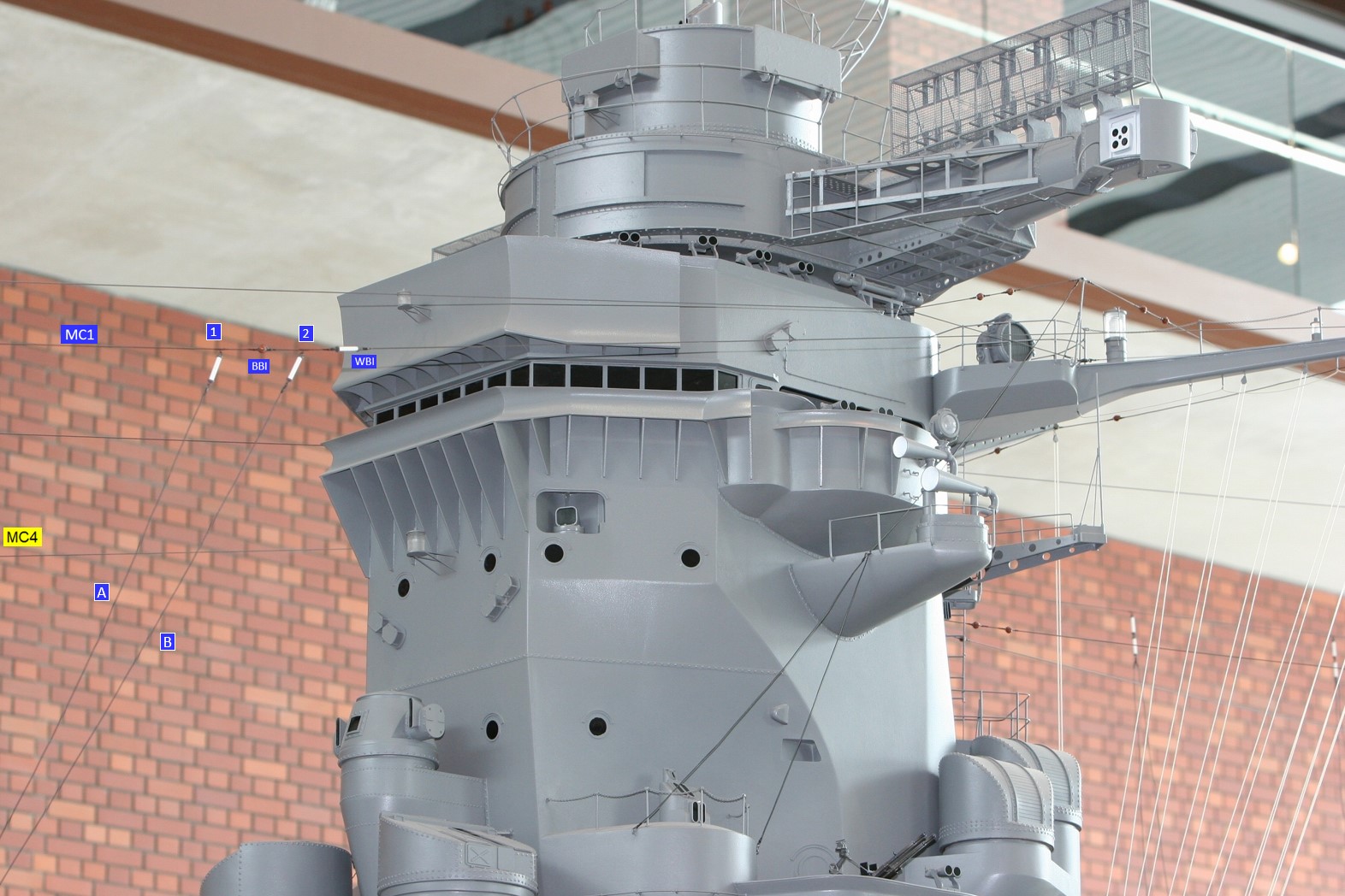

The 4 Main Cables depart per pair from their 2 deck fittings nearby the Jackstaff. MC Nr 1&2 run over the left pulley and MC Nr 3&4 run over the right pulley of the Jackstaff towards the bridge. ( See previous rigging step 01.01.)
See Pic 001 : Use your zoom.

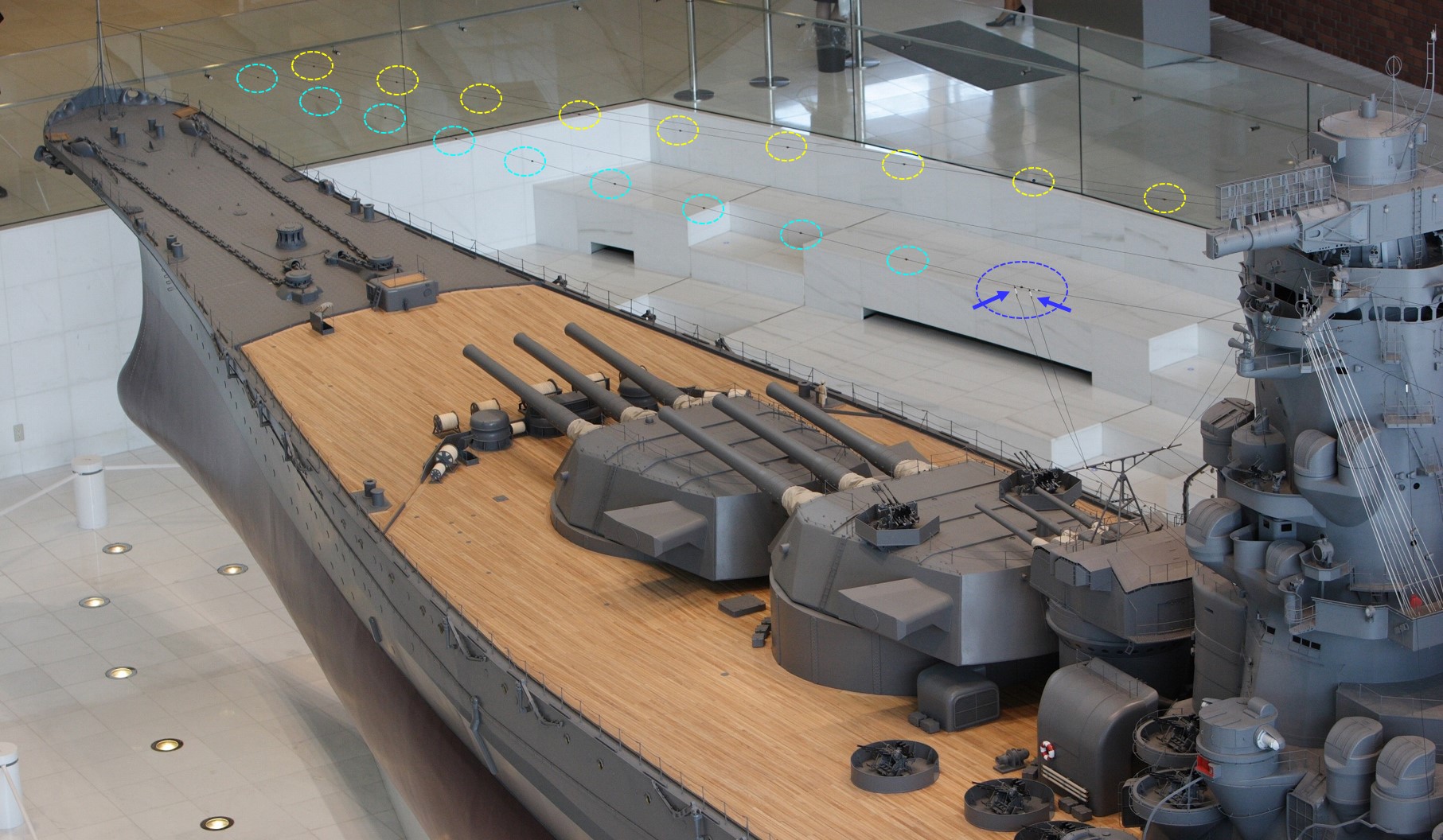

Light Blue Ovals : qty = 9 Brown Ball Insulators are installed on Port side Main Cable Nr 1 (MC1).
Yellow Ovals : qty = 9 Brown Ball Insulators are installed on Starboard side Main Cable Nr 4 (MC4).
The 10th Brown Ball Insulator (yellow oval) on Starboard side Main Cable Nr 4 is not visible in this picture. Keep in mind that MC Nr 1 is the mirror view of MC Nr 4.
Dark Blue Oval & Arrows: Brown Ball Insulator Nr 10 on MC 1, is flanked by 2 White Bar Insulators that are hanging on MC1. In Pic 001 you can not see much detail and therefore I introduced Pic 002.
In Pic 002 you see :
dark blue oval : Brown Ball Insulator Nr 10 on MC1
dark blue arrows : 2 White Bar Insulators installed on MC1, leading 2 cables to the Front 155mm Gun Antenna. These 2 cables will be treated in a future rigging step.
Red arrow: White Bar Insulator installed on MC Nr 1 going to Bridge. This Insulator is part of todays rigging step.

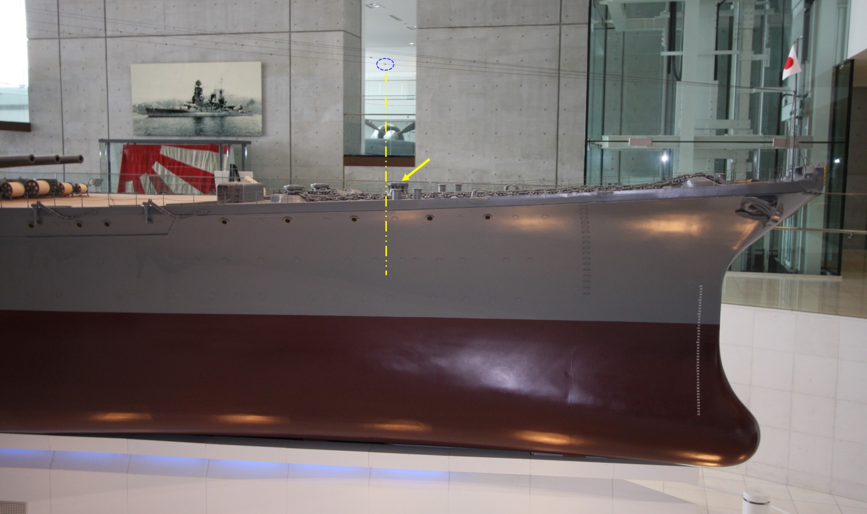

Notice : from all the 4 Main Cables that travel above the Foreship, only MC 1& 4 carry Insulators. When you look close , you’ll see that Main Cables Nr 2 and Nr 3, which travel also over the foreship, have NO insulators installed.
So, where exactly is the first (front) Brown Ball Insulator installed on MC1& 4 ?

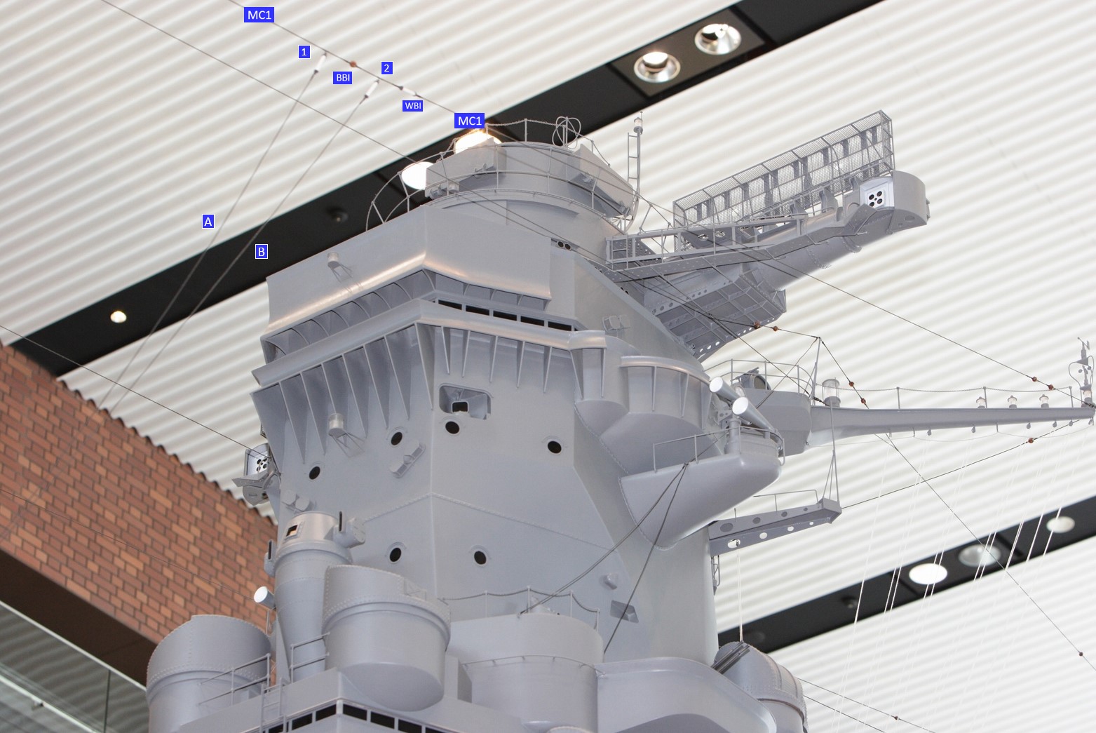

Picture 003, 004 gives you the exact location of Brown Ball Insulator Nr1 on Main Cables 1&4 versus their relative position on the Foreship.
Blue oval = location of Brown Ball Insulator Nr 1
Blue/ yellow arrow = location of Capstan on Deck
Blue/ Yellow line = vertical position of Brown Ball Insulator Nr 1 versus its Deck location
Picture 005 is a detailed view with the same subject.
Blue oval = location of Front Brown Ball Insulator
Blue arrow = location of Capstan on Deck
Blue line = vertical position of Brown Ball Insulator Nr 1 versus its relative Deck location.
Pic 006 is not a side view but gives you a better idea where the 2 Brown Ball Insulators on MC1&4 are located towards the position of the Capstan on the Foreship.
Blue arrows = location of the 2 Brown Ball Insulators Nr 1 on Main Cable Nr 1&4.
Yellow arrow = location of Capstan on Deck.
After looking at Pic 003-004-005 and 006, we get a good idea where the first (front) Brown Ball Insulator is located on MC1&4, but that leaves Us with the other question :
Where is the last (aft) of the 10 Brown Ball Insulators installed on Main Cable Nr 1 and on Nr 4 ?
Please take a look at Pic 007. This is a Side view of the Bridge, where, high above the Deck, several Main Cables travel towards the Bridge.
On Main Cable Nr 1, you see the blue arrow pointing at the blue oval that surrounds Brown Ball Insulator Nr 10 above the Foreship.
A little further on MC Nr 1 a green arrow points at a green oval that surrounds a White Bar Insulator that is also installed in-line on MC Nr 1.
Please keep in mind that what happens on MC Nr 1 is the mirror view of what happens on MC Nr 4 : note the white oval and white arrow that point at the location of Brown Ball Insulator Nr 10 and the nearby White Bar Insulator, in-line installed on MC Nr 4.
Also visible in this picture is the yellow striped line that indicates the relative vertical position of the Brown Ball Insulator versus its location above the Deck.
Please note that Brown Ball Insulator Nr 10 is located above the Aft-part of the Front 155mm Gun Tower, and also quite behind the 155mm gun Antenna.
The exact location of Brown Ball Insulator Nr 10 will play an important role in next rigging step : "01.03. Branches from MC1&4 to Front 155mm Antenna Brackets".

Today we will talk about the 4 (Split Cables)/ Branches from MC1&4 to the Front 155mm Gun Antenna. I prefer the name “branch”.
To show you the different items in this rigging step, I introduced 17 pictures on which I added some tags and numbers.
What is common in all these pictures :
The 2 main colours of tags that were used are Blue (Port Side) and Yellow (Starboard side).
All cables, branches, insulators on Port side have their mirror view counterpart on Starboard side, even when not clearly visible in a picture.
As a guideline, to understand all these pictures, we have Pic 001 Template which is a schematic drawing (not to scale) that shows you a quite simple overview of all the cables & devices that are of interest in this rigging step.
Also the special items of (next) rigging step “01.04. Rigging Antenna Cables to Front Bridge Structure“ are present in this drawing because their function highly impacts this rigging step.
On each Main Cable a Brown Ball Insulator present in this drawing but it is not part of this rigging step: It’s only used to clarify the start location of this rigging step.
On the other hand, we see quite a lot of White Bar Insulators (WBI’s) that have their own identification Nr.
Each WBI has a Front and an Aft connector to which cables or brackets are attached.
All Cables have an identification Nr, as do the attachment points of the Perpendicular Tubes on each side of the Front Bridge Structure.
Notice : For easy use, the Perpendicular Tubes in this drawing are drawn upside-down. Much easier to show the rigging connections.
I strongly recommend you to use Pic 001 as a reference guide when you read this rigging step.

Main Cable Nr 1and Nr 4 are shown as the 2 big cables at the left and right side of the picture.
High above and near the Bridge, (port & starboard side) ,just before- and right after Brown Ball Insulator Nr 10, two White Bar Insulators (WBI’s) are installed almost perpendicular on the 2 main cables MC1&4.
The Front White Bar insulator is called Nr 1 and the Aft White Bar insulator is called Nr 2. See Pic 002-003-004-005-006-007
On their aft connectors, a cable is heading downwards to the Front 155mm Antenna. The front insulator Nr 1 holds cable A and the aft insulator Nr 2 holds cable B. See Pic 003-004-005-006
To everyone’s surprise, cables A &B end-up on the Antenna in the same aft connector on WBI Nr 3. See Pic 005-006-007
The Outer WBI’s Nr 3 are attached to the Outer Antenna Brackets Nr A-1. See Pic 005-006-010-011-012
The Inner WBI’s Nr 4 are attached to the Inner Antenna Brackets Nr A-2. See Pic 005-006-010-011-012
Between the WBI’s Nr 3 and 4 Aft connectors, you find the small connecting cable E. See Pic 006-008-009-010-013-014
In the Outer WBI Nr 3 connector, not only cables A & B arrive from MC1 & 4, but here’s also a cable that departs from this point.
Cable C goes from the 2 WBI’s Nr 3 aft connectors to the Aft WBI Nr 5 front connector.
And from the WBI Nr 4 aft connectors, cable D runs also towards the Aft WBI Nr 5 front connector. See Pic 002-006-007-008-012-017
On the Aft WBI Nr 6 rear connector, Cable F goes to the Perpendicular Tube Retaining Flange Hole Nr 7. See Pic 006-007-008-017
And from the Perpendicular Tube Flat Surface Connector Nr 8, Cable G returns to the Aft WBI Nr 5 front Connector. See Pic 006-007-008-017
So far the trajectory of all the cables in this rigging step.
