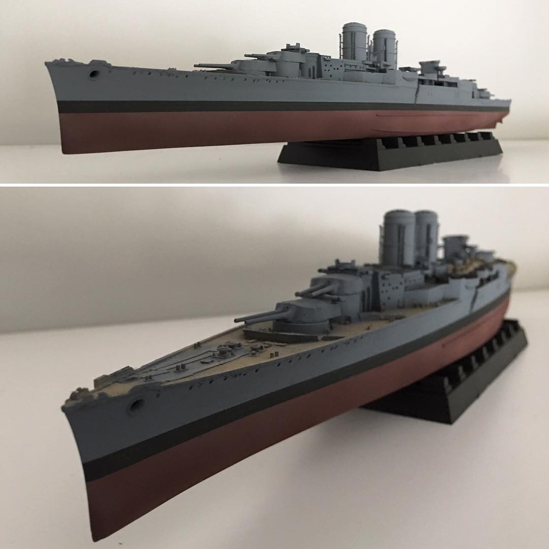

Some progress shots to update the thread. Ive been busy, as it seems to happen to many, but I had struggled so far a lot with the build. Mainly the PE from Flyhawk is hell so I need to figure out better ways to add it but so far, here is the progress.
Painted hull, boot topping, turrets, funnels, did few superstructures. Going to focus properly on the wooden deck next.
