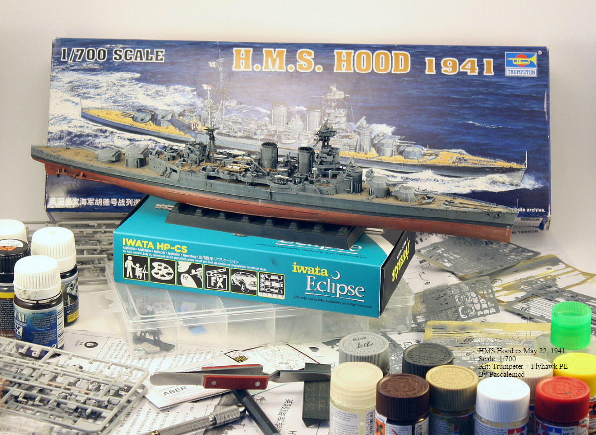

Hi all here is my WIP thread of HMS Hood as sunk, 1941 by Trumpeter using 3D printed parts from Shapeways and PE from Flyhawk.

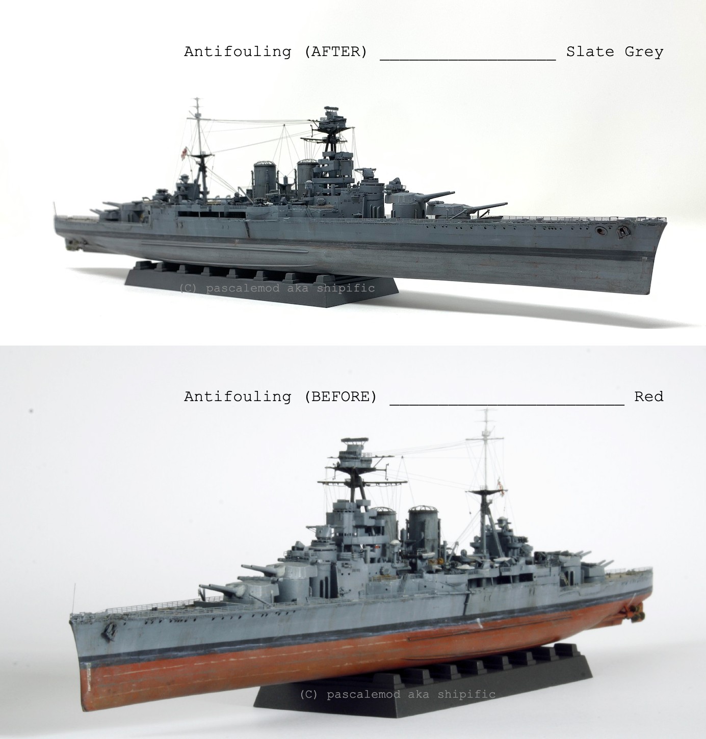

7) amount of weathering on the anti-fouling paint - discolored already or still bright red? Survivors said it was black when it upturned, but it could have been oil I guess...?
(?) Don't know

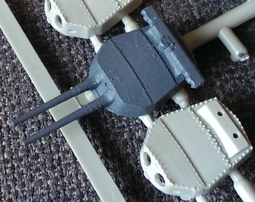

The turrets on the Trumpeter kit are too angular. They look almost OK from the side but not really from the top. Dressing the turret in PE won't change this unless the set you have completely alters the turret face. Ultimately, it's up to you to look at pictures and drawings and decide if this bothers you enough to make it worth the cost. 3D printing is still a fairly young technology, hence the expense, but in my opinion worth every penny (or cent if you like). There may be resin replacement turret sets as well, which would be cheaper, but I haven't searched for them in great detail. In any case though, Trumpeter kits are pretty cheap to start with and it looks like you've already spent more on PE than the base kit, do you want that blemished by sub-par turrets? Put it this way, I am using no other after market parts in my build but still considered it worth it to double the cost of the whole project just for those turrets. If you do go for them though, I recommend reading some of the other topics on here about working with 3D printed parts, as they have some more specific preparation, cleanup and painting needs.Guest wrote:

Regarding turrets - are they obviously wrong, even with PE added? Im asking because those you linked to are 21 dollars, the kit was cheaper, so something is off with the pricing of something here.Is it a must? Looks like a ripoff, its like a dollar part in material so labour at x20 seems crazy.

Are you replacing the turrets? If not you should be, the basic shape of the Trumpeter ones is somewhat off. My personal recommendation would be these: https://www.shapeways.com/product/S4P7X ... d=61572631 3D printing knocks the competition out of the water for replacement parts these days. You can remove the barrels and replace with brass if that suits you better.

I do agree with the others though - the Trumpeter turrets are noticably off. Trumpeter's 15" gun barrels are not very representative of the real thing either in many of their 1/700 RN subjects.
You are right, im gonna get the blasted turrets in the end, the perfectionist in me kicked in and I gotta have the best. While Im not interested in buying the deck, I suppose this could be my alternative:). Flyhawk was more than the kit, you are correct!Vlad wrote: do you want that blemished by sub-par turrets? Put it this way, I am using no other after market parts in my build but still considered it worth it to double the cost of the whole project just for those turrets. If you do go for them though, I recommend reading some of the other topics on here about working with 3D printed parts, as they have some more specific preparation, cleanup and painting needs.

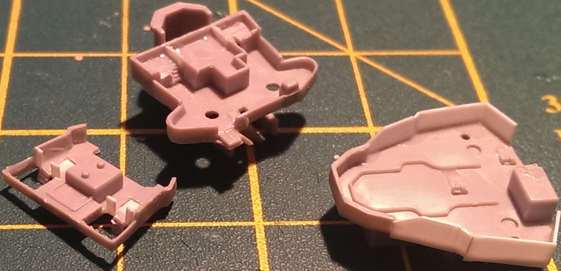

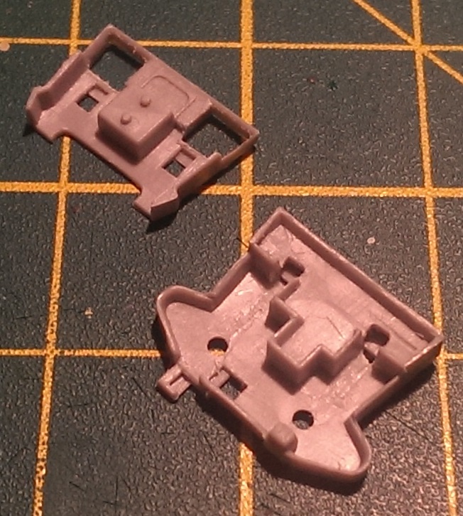

Right, here are the pictures as promised. Note the modifications to the two major bridge pieces in the Trumpeter kit.
On the upper piece (kit part F19), I drilled and sanded out the forward section to leave only the walls. I also filled the kit's ladder holes (these are incorrect) and added partial shields and a half-height ladder down to the compass platform level.
On the lower piece (kit part F13), the raised portion at the front becomes the "floor", level with the compass platform. I cut out a notch in this part to fit the half-height ladder up to this deck.
Excuse the rough paintwork on the final assembly shot, kit is still very much WIP at this point.
As for the turrets, here is a link to my original preview: viewtopic.php?f=85&t=164867
Below is a shot of the turret (now painted) next to Trumpeter's sprues. As you can see, the kit turrets are too angular and just look off, as well as having hugely overscale rivet details. The 3D printed ones have very fine rivet detailing (not sure my paintwork does it justice) and the blast bags are very finely rendered based on pictures. The barrels are as the turrets come from the printer but I don't see why you couldn't cut these off and drill a hole for brass replacements.
I hope that helps!
Oh, one more thing. Since you're building full hull, it may be worth noting that Trumpeter's paint instructions leave a bit to be desired. The ship sat quite low in the water and the black boot stripe is not narrow as shown in the kit instructions, but wide and reaching up to the top of the 12" armoured belt (which was almost completely submerged at full load). At the lowest point of the quarter deck, just forward of X turret, the boot stripe should be almost as wide as the distance from the top of the boot stripe to the deck. Basically, about half the space between the kit's waterline split and the quarterdeck should be black.
I hope that helps!

For what it's worth, the 3D printed barrels don't warp, have a good shape and a hollow muzzle. I expect brass is still better though.

The paint Im using is Tamiya XF66 which was recommended as the closest Tamiya match for airbrushing. However I plan to add a bit of blue hue to it as per Vlads comments also, I feel it is a bit too gray. Color is subjective of course but I get a sense the ship should be on the darker / bluish side. And I think Vlads screen pictured it well. More experimenting ahead but I need to figure out how to get this degausing cable stern placement first....

Humbrol 27 is XF-54 but it may be a touch too dark for 1/700. The colour issue is really subjective indeed so up to you on that one
