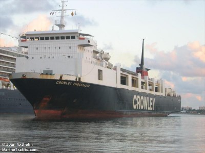

Attached is an un-dated picture of the AMBASSADOR later in her life, when she was the CROWLEY AMBASSADOR and had a black hull, red-anti-fouling paint and a huge �Crowley� painted on the side. The other picture is of the SENATOR during the mid-late 1980�s�the period that I was working on the AMBASSADOR�and the general look that I will be going for. Blue hull, grey anti-fouling, no huge name on the side (and a smaller detail, no bow thruster or stern thruster symbol, either). The AMBASSADOR and SENATOR are not identical twin sisters. Most of the differences at the time were fairly cosmetic (different vent arrangements on the stack, different color decks and deck equipment) but you may be able to pick out the one significant structural difference, although it is tough with the resolution and lighting of these photos.

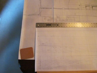

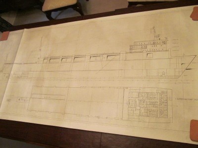

I am building the AMBASSADOR in 1/100 scale, which matches the standard prints. This yields a model roughly 5 1/2 feet (169cm) long and 8 � inches (21.5cm) wide. As Chief Mate I had a filing cabinet full of blue prints, and had a full-sized copy of the General Arrangement plan made at a copy shop ashore (even then I was planning to build a model some day).
The Lines Plan for the hull shape is not in the set of plans carried on the ship, so over time I made copies of a number of different frame shapes. Even so, I don�t know that I could get an accurate hull shape with what I copied. I recently e-mailed the builder Jos. P. Meyer (now Meyer Werft) and asked for a copy of the Lines Plan. The good folks there provided not only the Lines Plan, but also a different GA plan (with some details my copy did not have) and some other information.
Sadly, they also confirmed my expectation that the AMBASSADOR, like all but a few lucky or historic ships, has been scrapped.
Oh, and if you were wondering, the structural difference between the AMBASSADOR and the SENATOR was that the SENATOR had an extra �penthouse� cabin on top of the bridge deck. My understanding was that this housed an owner�s stateroom and cadet stateroom (s), but as we were almost never in the same port at the same time (and we were usually quite busy) I never had the chance to check it out.

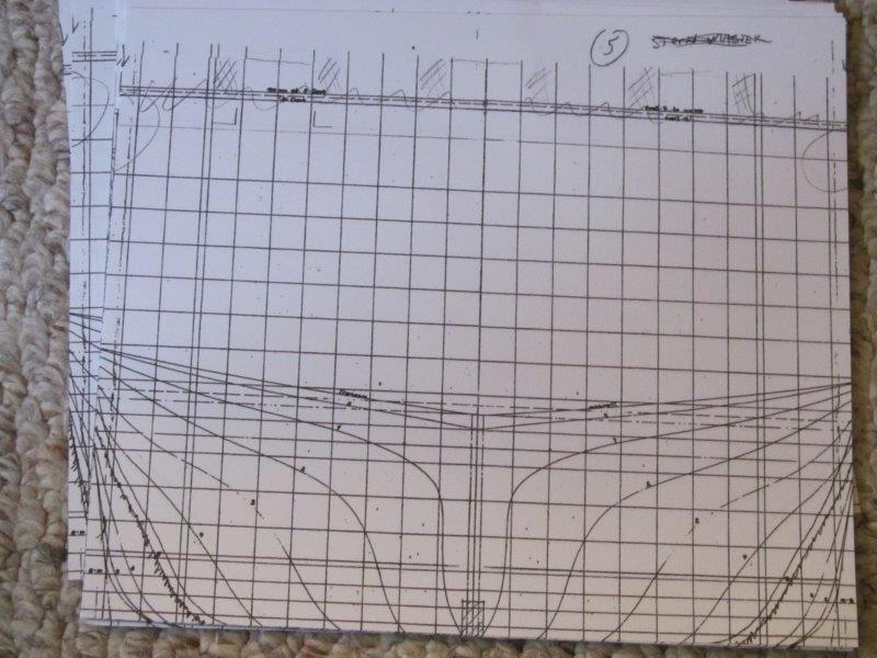

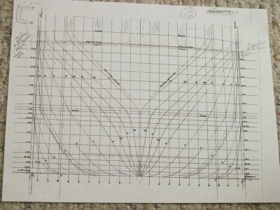

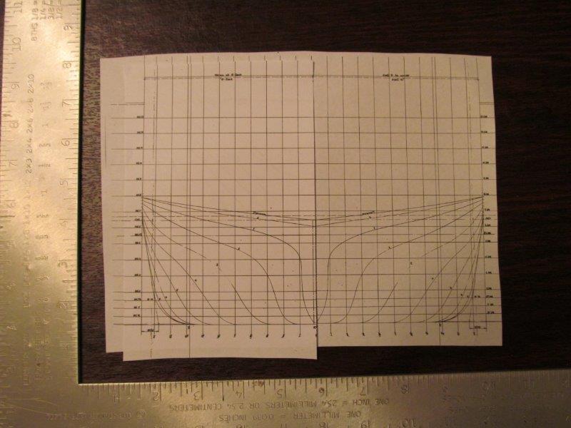

I am using the Body Plan portion of the Lines Plan for the frame shapes. There are 24 stations on the Body Plan, yielding 24 frames. I may have to create my own intermediate station lines near the bow and stern to get the correct shape, but to start will just use the 24 from the plan.
Only the �zero� Body Plan station (at the after perpendicular) has an equivalent on the GA plan, so I had to carefully transfer the station locations from the Body Plan to the GA plan to be able to work between the two. In addition, the �A� deck (the upper-most deck on the stern, which essentially runs the length of the ship to the bow) will form the upper limit of my frames and has a significantly rising sheer towards the stern, resulting in about half of the frames having a deck height different from any other frame.
I combined a reverse image with the normal image of the Body Plan to come up with the full frame shapes. The �A� deck height was taken off of the GA plans for each station and marked for each frame. I then reduced the dimensions of each frame to account for the thickness of the planking and coating that I intend to cover the hull. Modifying each frame plan by hand with dividers was more tedious than I expected.
(For a more modern�and no doubt more accurate�approach, see the current build log on this forum for the 1/24 Clyde Class Lifeboat, using building plans created with CAD and ribs and keel cut with a CNC router�nice work!)

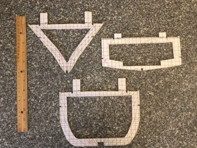

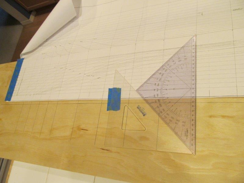

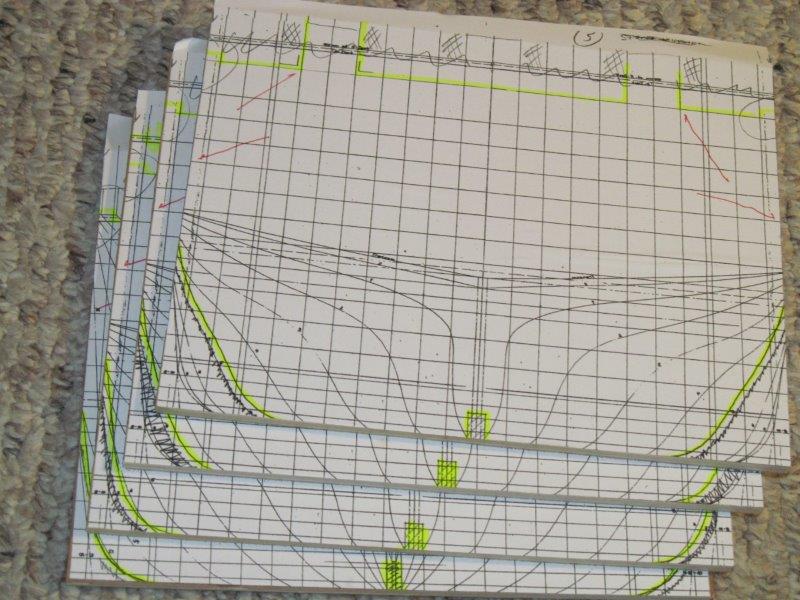

I made a working copy of each completed frame station in the event I ever want to do this again or, more likely, that I tear or otherwise damage the paper pattern while working with it. I then cut each frame station pattern to roughly the same size with a horizontal cut at the bottom of the frame and vertical cuts at the extreme width of the frame.
Each frame plan was then glued onto �� plywood using white glue (Elmer�s in the US) thinned 50-50 with water.
(When first considering scratch-building a ship from hull lines I thought that I would have to trace the completed lines onto the wood before cutting, which I was not looking forward to. Some years ago I got to look inside a beautiful scratch-built RMS LUSITANIA and saw the remains of the paper hull lines glued onto the framing material and immediately thought--Aha-that�s how it is done!)
I pre-cut the plywood into uniform smaller pieces to make gluing, handling and cutting each frame easier, although it no doubt was not the most efficient use of the wood. I also marked the lines that I need to cut with a high-lighter pen so that it is easier to keep track while cutting.
Another tip�you might also consider using heavier than regular copy paper for this step. When I first started gluing I found that I had to be very careful to keep the paper from getting bubbles, creases or distortions. I then copied the remaining frame stations onto slightly heavier paper (28 pound rather than 20 pound) and it was much easier to glue the frame stations to the plywood without problems. I might try slightly heavier paper than the 28 pound for this step if I make another scratch-built hull in the future.

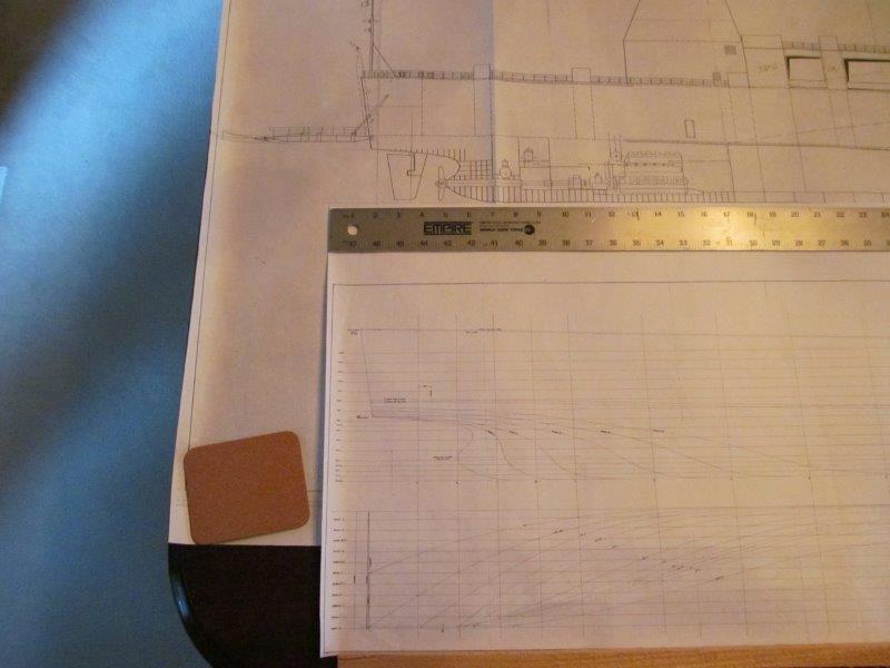

I rough cut the frames today using a scroll saw. Still a number of steps yet before they are ready to attach to a keel
Stacking the frames in order gives some dimension to the hull lines and provides a bit of a preview of the shape of the hull. It also shows me that I may need another frame or two in the stern area (the left stack of frames) in order to accurately model how the hull fairs to the propeller shaft.
It's funny, the profile and waterline views of the hull lines show two additional frame stations in that area that do not appear in the body plan (which was used to make the frames). The vertical lines are the frame stations and from the left they are zero, one half, one, one and a half (and then on). The body plan part of the hull lines omits the one half and the one and a half body stations.
Theoretically there is enough information in the three views of the hull line plans to allow me to create a frame station anywhere on the hull. I have not done that before, so I will let you know how it goes!

Wow! When I started documenting this build I apologized in advance for my slow build pace�but did not expect such a big gap. I hope that all are well. I recently once more resumed doing more concrete work on this project�something I can actually take picture of--and hope to keep the production going at least somewhat more steadily going forward. Some of the steps I will describe took place a little while ago, and some are more recent. They are presented here in an order that hopefully makes following the build more clear, although the actual chronology may have been different.
I sanded the frames to their final shape and took care to ensure that the mid-body frames (which should all be the same shape) were as close to identical as I could make them. A notch was cut at the bottom of each frame to fit on the keel, and smaller notches marked and cut on the sides and top for stringers. I did not mark the stringer notches until after the outer frame shapes were sanded so that the notches would be true to the final shape.
I left two tabs at the top of each frame station. This is so the completed frame/keel/stringer assembly has something to rest on when it is flipped for planking later. The tabs will be removed once the hull is fully planked. I saw this practice on a number of the build logs here�a good idea! Also, I marked the centerline of the top of each frame so that it is easier to keep everything in line when assembling onto the keel. I also got that idea from one of the build-logs here (forget which) and it seems like a simple but good idea that I may not have thought of myself.
The center portion of most of the frame stations was also cut out to reduce weight and allow for easier interior access and placement of motor, battery, ballast and running gear. I left � of an inch frame depth on the sides and bottom, and � inch on the top. The bottom and side thickness for some of the after-most frames was reduced to allow clear space for part of the main deck cargo area which will be visible when the stern ramp is opened. I also cut certain after frames to make room for the stuffing tube. I left the extreme bow frame station solid, as I don�t expect to need access there and also because I think the added rigidity will help in keeping the bow shape true when planking and will add strength. (Probably over-thinking this.)
The after-most (transom) frame is a bit different, as clear space for the stern ramp opening needs to be cut at the bottom, and the cutaway where the stern ramp needs to fit (when closed) at the top also needs to be cut out. The depth of this cut (at the top) is essentially the thickness for the frame material, so I will glue another piece to the forward edge to maintain shape. I am still thinking through how exactly I want to do this, as I may want to keep the original frame material in place initially so that it keeps its shape until attached to the keel. This frame also is also set at an angle (to match the angle of the transom) which complicates it a bit.
[I also cut the two forward-most frames down somewhat to allow for the bow deck shape piece to placed, which will help in accurately planking the bow.]
