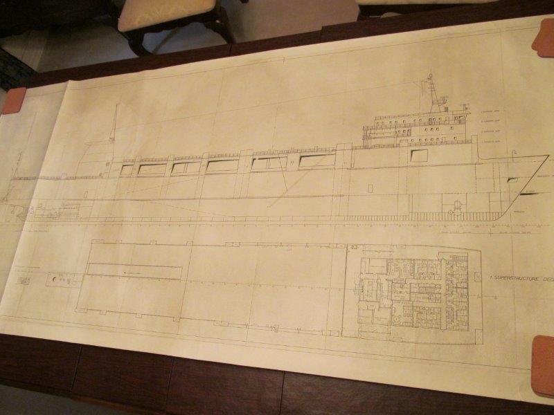

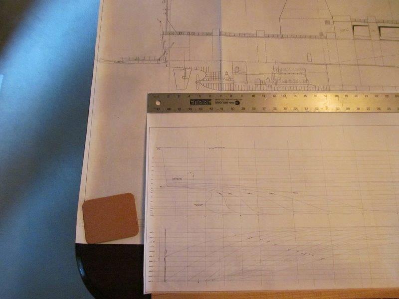

I am building the AMBASSADOR in 1/100 scale, which matches the standard prints. This yields a model roughly 5 1/2 feet (169cm) long and 8 ½ inches (21.5cm) wide. As Chief Mate I had a filing cabinet full of blue prints, and had a full-sized copy of the General Arrangement plan made at a copy shop ashore (even then I was planning to build a model some day).

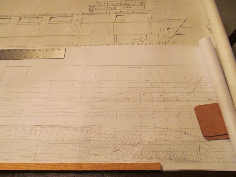

The Lines Plan for the hull shape is not in the set of plans carried on the ship, so over time I made copies of a number of different frame shapes. Even so, I don’t know that I could get an accurate hull shape with what I copied. I recently e-mailed the builder Jos. P. Meyer (now Meyer Werft) and asked for a copy of the Lines Plan. The good folks there provided not only the Lines Plan, but also a different GA plan (with some details my copy did not have) and some other information.
Sadly, they also confirmed my expectation that the AMBASSADOR, like all but a few lucky or historic ships, has been scrapped.

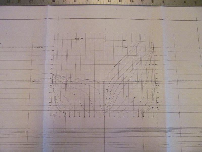

I am using the Body Plan portion of the Lines Plan for the frame shapes. There are 24 stations on the Body Plan, yielding 24 frames. I may have to create my own intermediate station lines near the bow and stern to get the correct shape, but to start will just use the 24 from the plan.
File comment: Body Plan
Only the “zero” Body Plan station (at the after perpendicular) has an equivalent on the GA plan, so I had to carefully transfer the station locations from the Body Plan to the GA plan to be able to work between the two. In addition, the “A” deck (the upper-most deck on the stern, which essentially runs the length of the ship to the bow) will form the upper limit of my frames and has a significantly rising sheer towards the stern, resulting in about half of the frames having a deck height different from any other frame.
I combined a reverse image with the normal image of the Body Plan to come up with the full frame shapes. The “A” deck height was taken off of the GA plans for each station and marked for each frame.

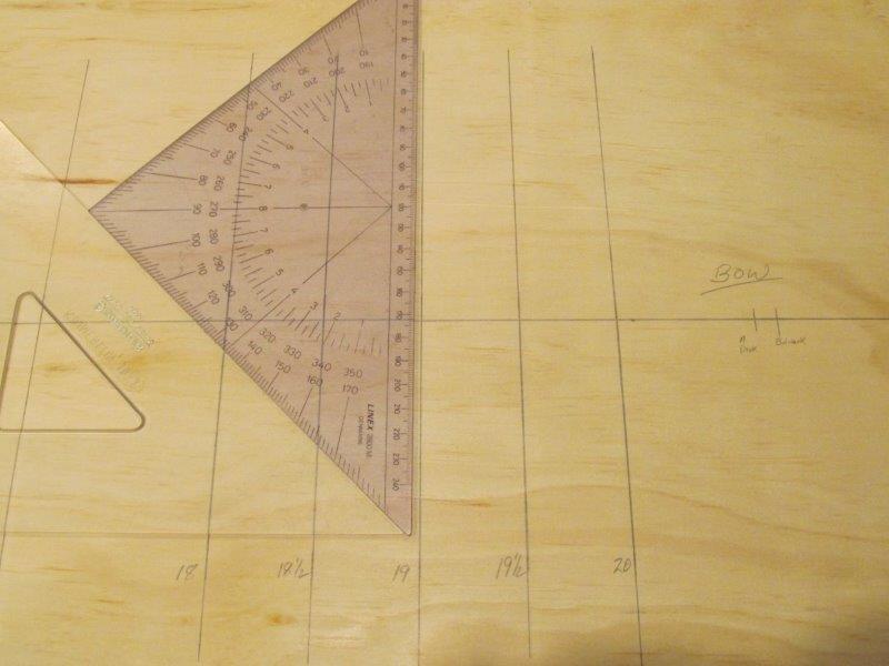

File comment: Transferring keel centerline and frame stations from lines plan.
File comment: Building board with keel centerline and frame stations marked. I used my navigation triangle for any number of drafting aspects of this project--who knew that it could be so handy outside of chart work?

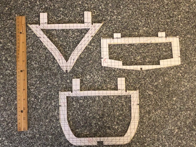

Wow! When I started documenting this build I apologized in advance for my slow build pace—but did not expect such a big gap. I hope that all are well. I recently once more resumed doing more concrete work on this project—something I can actually take picture of--and hope to keep the production going at least somewhat more steadily going forward. Some of the steps I will describe took place a little while ago, and some are more recent. They are presented here in an order that hopefully makes following the build more clear, although the actual chronology may have been different.
I sanded the frames to their final shape and took care to ensure that the mid-body frames (which should all be the same shape) were as close to identical as I could make them. A notch was cut at the bottom of each frame to fit on the keel, and smaller notches marked and cut on the sides and top for stringers. I did not mark the stringer notches until after the outer frame shapes were sanded so that the notches would be true to the final shape.
I left two tabs at the top of each frame station. This is so the completed frame/keel/stringer assembly has something to rest on when it is flipped for planking later. The tabs will be removed once the hull is fully planked. I saw this practice on a number of the build logs here—a good idea! Also, I marked the centerline of the top of each frame so that it is easier to keep everything in line when assembling onto the keel. I also got that idea from one of the build-logs here (forget which) and it seems like a simple but good idea that I may not have thought of myself.
The center portion of most of the frame stations was also cut out to reduce weight and allow for easier interior access and placement of motor, battery, ballast and running gear. I left ¾ of an inch frame depth on the sides and bottom, and ½ inch on the top. The bottom and side thickness for some of the after-most frames was reduced to allow clear space for part of the main deck cargo area which will be visible when the stern ramp is opened. I also cut certain after frames to make room for the stuffing tube. I left the extreme bow frame station solid, as I don’t expect to need access there and also because I think the added rigidity will help in keeping the bow shape true when planking and will add strength. (Probably over-thinking this.)
The after-most (transom) frame is a bit different, as clear space for the stern ramp opening needs to be cut at the bottom, and the cutaway where the stern ramp needs to fit (when closed) at the top also needs to be cut out. The depth of this cut (at the top) is essentially the thickness for the frame material, so I will glue another piece to the forward edge to maintain shape. I am still thinking through how exactly I want to do this, as I may want to keep the original frame material in place initially so that it keeps its shape until attached to the keel. This frame also is also set at an angle (to match the angle of the transom) which complicates it a bit.
[I also cut the two forward-most frames down somewhat to allow for the bow deck shape piece to placed, which will help in accurately planking the bow.]
File comment: Three completed frames. One mid-body, one forward ,and the transom
