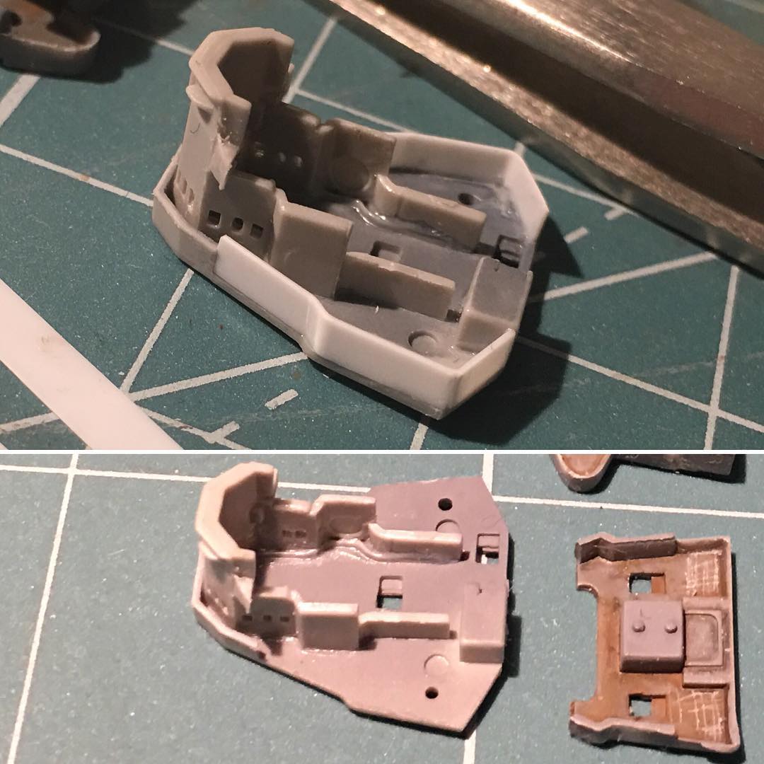

Post by pascalemod »
Update on superstructure... Coming along nicely, need to clean up the putty, lower the shields a bit and start building the upper mast itself. Installed ladders etc... hard to work in this scale but also fun.
used PE for main superstructure, and some small wires to simulate all the tubes running along it in real life. its may be a little messy but I think its ok. 1/700 needs to look right from 50 cm away!
As for starfish / I know it is out of scale with those supports but I have looked carefully at the alternative in PE and it looked like a nightmare to build. So some sacrifices are made. :cool_1:

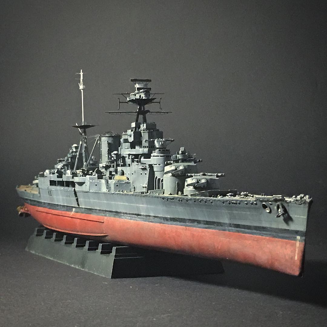

Re: 1/700 HMS Hood (as sunk) by pascalemod
with added hull plating detail, using paints basically. It came off a little off scale but I think better than the dull red hull on its own.
Still need to these few things:
- install the lifeboats on the upper deck
- reposition carley floats on the forward funnel
- add timber storage around aft funnel
- may be add metal barrels as the 3D printed ones look to be sagging a little bit, not nice
- add flag staffs
- make flags
- built up main mast upper part radar (that part has been broken off too many times I care to admit)
- add biscuit life preservers somewhere... not sure where
Pretty much it. I know there is some inaccuracies here and there but by this point I gotta call it, as it has been a year long project.

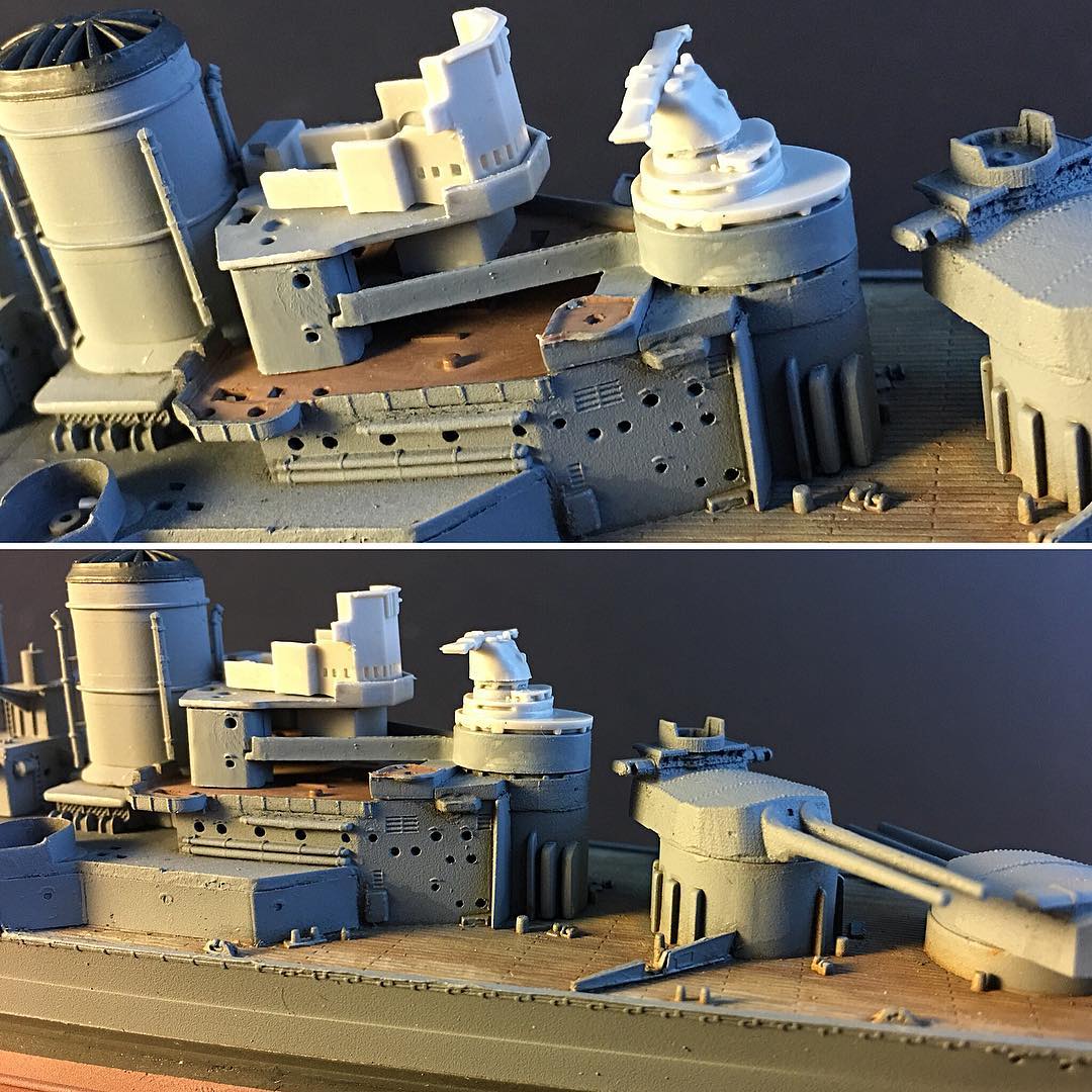

pascalemod
Posts: 2009
Location: Stockholm, Sweden
Added the timber storage to the funnel. It is not super accurate but adds visual detail I think and also make the ship a little more "alive".
I just chopped up a bunch of toothpic parts and mixed it up with some discarded PE bits and wire to make it a little less homogeneous.
PS. Yeah, I was lazy to rebuild the wire antennas :) I figured this area looked to be holding a lot of rigging and I wanted it to be strong. Cutting corners.
