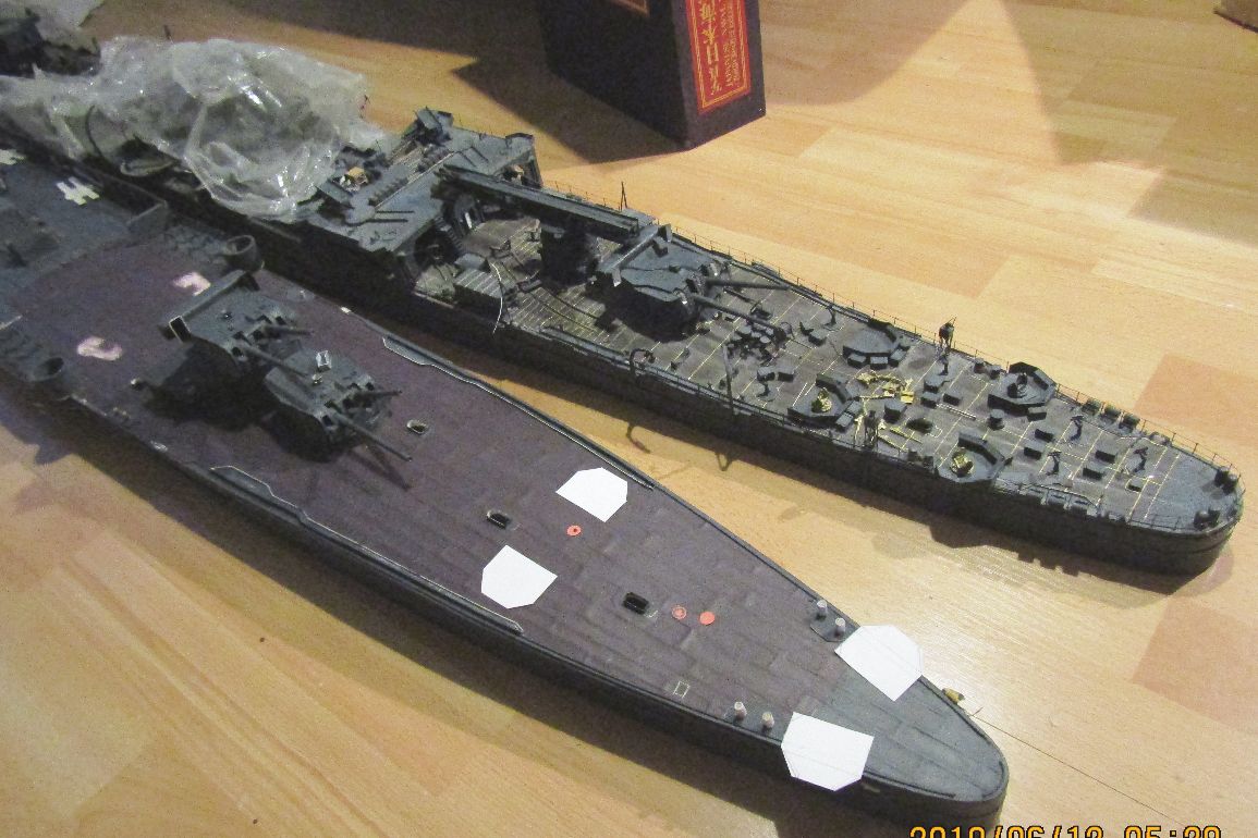

hi, Mike, yeah, understanding of complexity of Chokai�s bridge form was so compelling to the build.
Have so far made 3 Takao class cruisers,I didn�t recollect it�s form well, I had to do it from the start,spent the entire 4 months for this.
Making of the outer steel plates and opening of port holes were just begun, will come to spend the rest of months of this year for the hull. I know it�s so time-taking that I�m estimating it will require 7 years or even 10 years to build her on this scale. Perhaps I will need to spring over making places which become invisible from outside...

Wow, Mucho...your photography skills are excellent! Once the build is completed and you found the right background and put her in water (or did a waterline scene), those up-close shots could very well pass for fake actual photos!

Am not quite determined to do so yet. By the time the model becomes finished,i get into a flame-out,no more guts to go on,taking a long pause,used to hand models over to younger generation modeller(s). I hope they or he might be able to make the scene. :smallsmile:
Make of many items is still missing to the 20cm gun turrets.

Those turrets look awesome. Sometimes slow and steady is the best solution. I hope you find some kind of obscure revelation that will inspire you to finish. If it's mostly the small guns, make one of each and install it so seeing it unfinished will drive you crazy. Just joking, of course, but the final reveal should be worth the wait. Best wishes.
