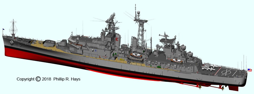

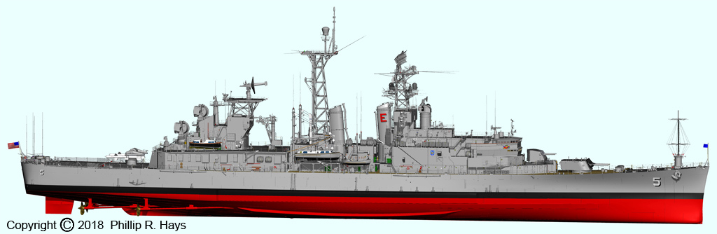

FINALLY!!!!
It's done (mostly)! Here are images of the finished CAD model of the USS Oklahoma City CLG-5 in the configuration of the summer of 1971. After 14 years and many hundreds of hours the model is basically finished. I need to add the SH-2 Seasprite helicopter, and I suppose there are still some small details I will discover, but it is good enough to start on the drawings for the 1:96 model.
These images are composites of four images for each view angle - the hull and the forward, midships and after superstructures. I pasted them together in Photoshop. I still haven't combined all four files into a single whole ship file - that will be several days work. Generating images from the whole ship file will take many hours.
The four files add up to 1.071 gigabytes, but there are a few overlapping elements in the superstructure files that will be removed. The whole ship file will be still be about a gigabyte. There are 2.86 million objects in the files, and a bit more than 22 million points. You can find many more detail images here:
https://www.okieboat.com/CAD%20model.html
PS: Before anyone gets excited about creating 3D prints from the model, keep in mind that almost all of it was created with zero thickness surfaces that will not print, and not solids. The model can be used to create real solids that would print, but that would take more years of work.
